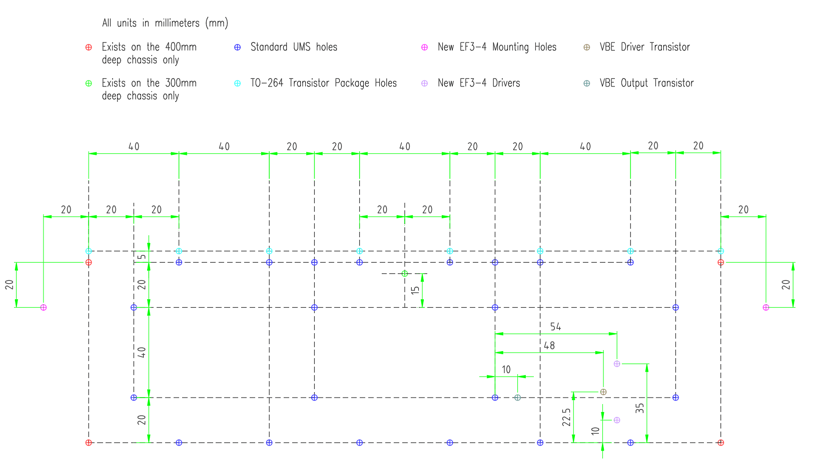

These are the final hole locations for everyone's reference.
They show all the holes for the Wolverine EF3-3 & EF3-4 relative to the UMS (universal mounting system) which is used by the stores for their Heatsinks.
Please download the zip file to extract the DXF file.
For those who don't know a DXF file can be loaded into a CNC mill to automatically traverse in the x - y axis to locate and dill the holes accurately
if you are using your own Heatsink for the Wolverine Project.
