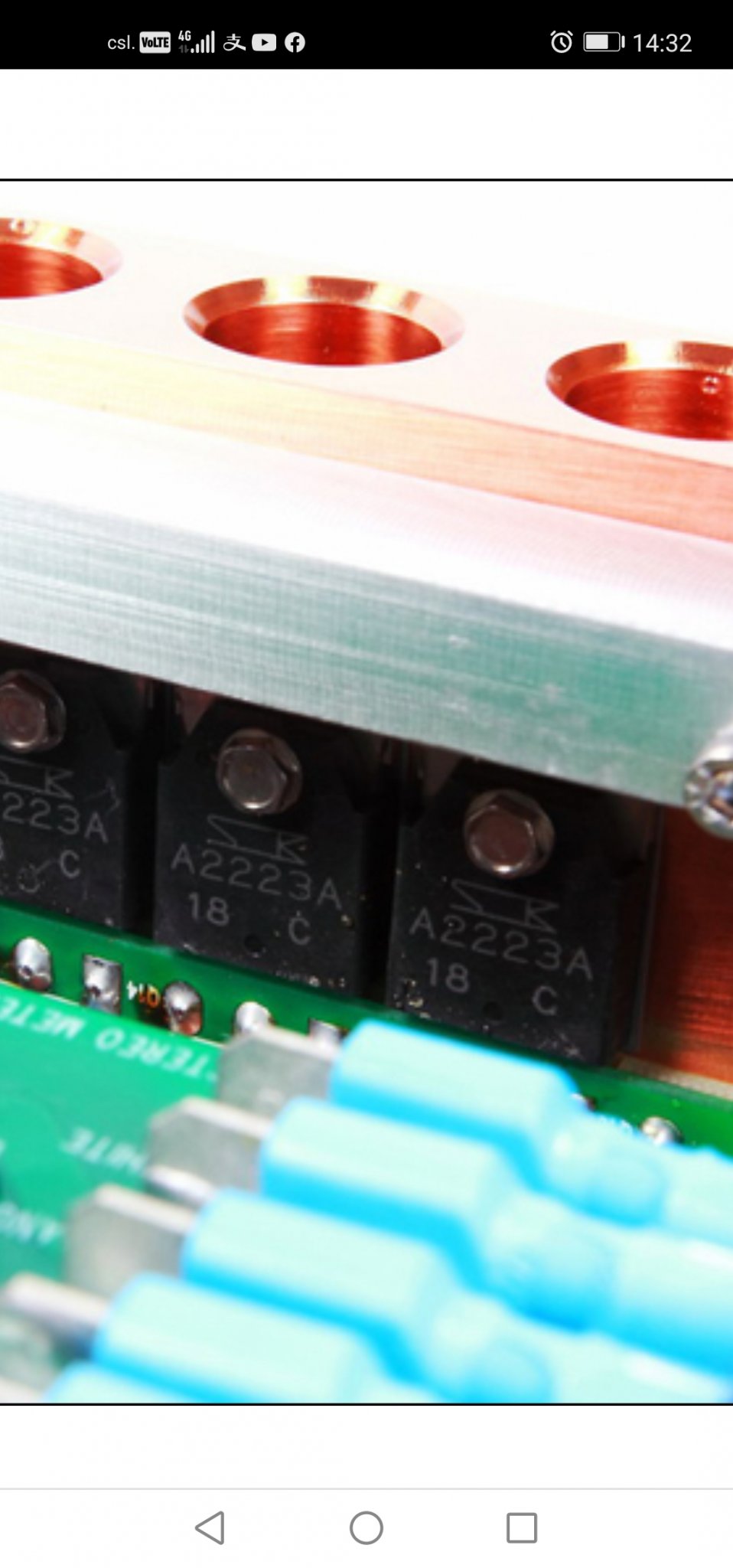

I find the Momentum Stereo from Dan D’Agostino Master Audio use it.For the o/p stage I ordered 2SC6145A and 2SA2223A from Digikey and Profusion

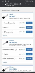

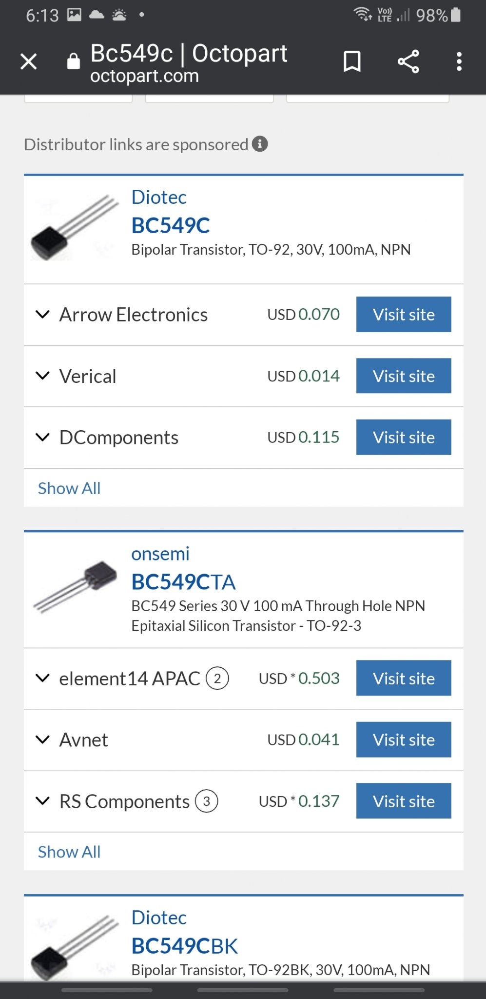

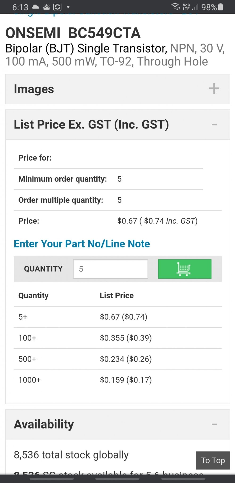

I am trying to put together a parts order for the semis, minus the outputs. Is there any BC549cta in stock out there or in someone's parts bins that I can purchase? Is buying 30 or so of each of the small transistors enough to get good matching? Or can someone here sell me pre matched BC549/559CTAs? Just seems pretty inefficient for us all to buy that many extra for matching, and price gets way better when you buy 100+. I would offer, but currently don't have a way to match Hfe (yet). buying pre-matched would save me that investment, too. Please PM me if you can offer pre matched devices.
Element14 seams to have plenty in stock. Try using octopart to find stock.I am trying to put together a parts order for the semis, minus the outputs. Is there any BC549cta in stock out there or in someone's parts bins that I can purchase? Is buying 30 or so of each of the small transistors enough to get good matching? Or can someone here sell me pre matched BC549/559CTAs? Just seems pretty inefficient for us all to buy that many extra for matching, and price gets way better when you buy 100+. I would offer, but currently don't have a way to match Hfe (yet). buying pre-matched would save me that investment, too. Please PM me if you can offer pre matched devices.
Element14 does not want to export and their export site says they do not have any.Element14 seams to have plenty in stock. Try using octopart to find stock.
Any concerns using MULTICOMP PRO BC549C?
Try farnellElement14 does not want to export and their export site says they do not have any.
These onces are not to far away
https://uk.farnell.com/on-semiconductor/bc549cta/transistor-bipol-npn-30v-to-92/dp/2453797
These transistors are obsolete.Q11 in the BOM lists KSA1220AY but I'm unable to find such a component. Is that a BOM mistake? Should it be KSA1220AYS?
For selecting parts, it's easier if you use the Mouser or Alternatives columns in the BOM. You will notice that the KSA1381E are listed and they are used elsewhere in the amp.
Here is another parts search engine that shows who has BC549c(ta) in stock.
Click for BC549c(ta) stock
There are brands other than Onsemi listed, but I am not sure if they are as trusted as Onsemi.
