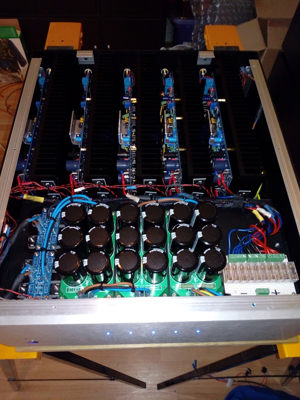

Hi all,
What would be a good amount of capacitance for the ps?
Im going for 1 50V 1200Va toroidy supreme audio grade transformer.
I have 2 ps boards from the classic alph amp groupbuy by rhthatcher with space for 8 caps per channel.
and i am using the 4 output pairs board.
I am using a 5U x 400 mm modified case.
TIA
regards, John

There are many threads discussing power supplies and opinions vary on how much capacitance and what diodes (Mosfets) to use. Feel free to investigate.
This is my personal opinion on selecting a power supply for this amp:
For 4 ohms speakers or less, use a transformer with two 40Vac windings. Less stress on the outputs and you can use 64Vdc caps.
For 4 ohm speakers and above, use a transformer with two 45Vac windings. Less stress on the outputs, use 80Vdc caps.
For those who insist on using a 50Vac transformer, be careful on the selection of the output devices and stay away from very low impedance loads. Read the second page in the BOM.
Generally speaking, as you go up in voltage, the cost to build this amp increases.
My preference is to use one transformer per channel. However more room may be needed in a single chassis. Using two chassis is ideal.
If I remember correctly the amps that were tested used 20,000uF (10,000uF||10,000uF) per rail . I would not use less.

Thanks Audiosan and Harry
My build will be an integrated amp, space does not allow me to use two transformers or two chassis (that would be weird) sadly.
I worry a bit about the heatsinks even if they are big. I want to keep the heatsinks internal inside the chassis, not on the outside.
In the ps 80.000 uF 80V per channel is the max that will fit. The ps boards max cap diameter is 35mm.

You don't need to worry about the heatsinks. Here is a 5ch Honey Bagder with internal heatsinks. 4U300mm sinks. Running on +/-57Vdc (2x40V transformer), and 70mA bias current pr outputpair.
At normal SPL levels, the heatsinks stays at about 13 celcius above room temperature.
