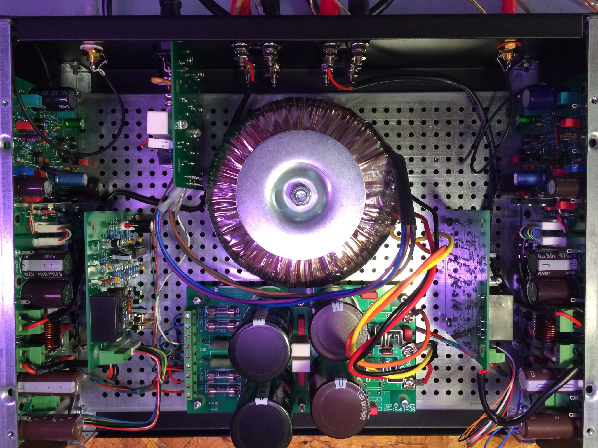

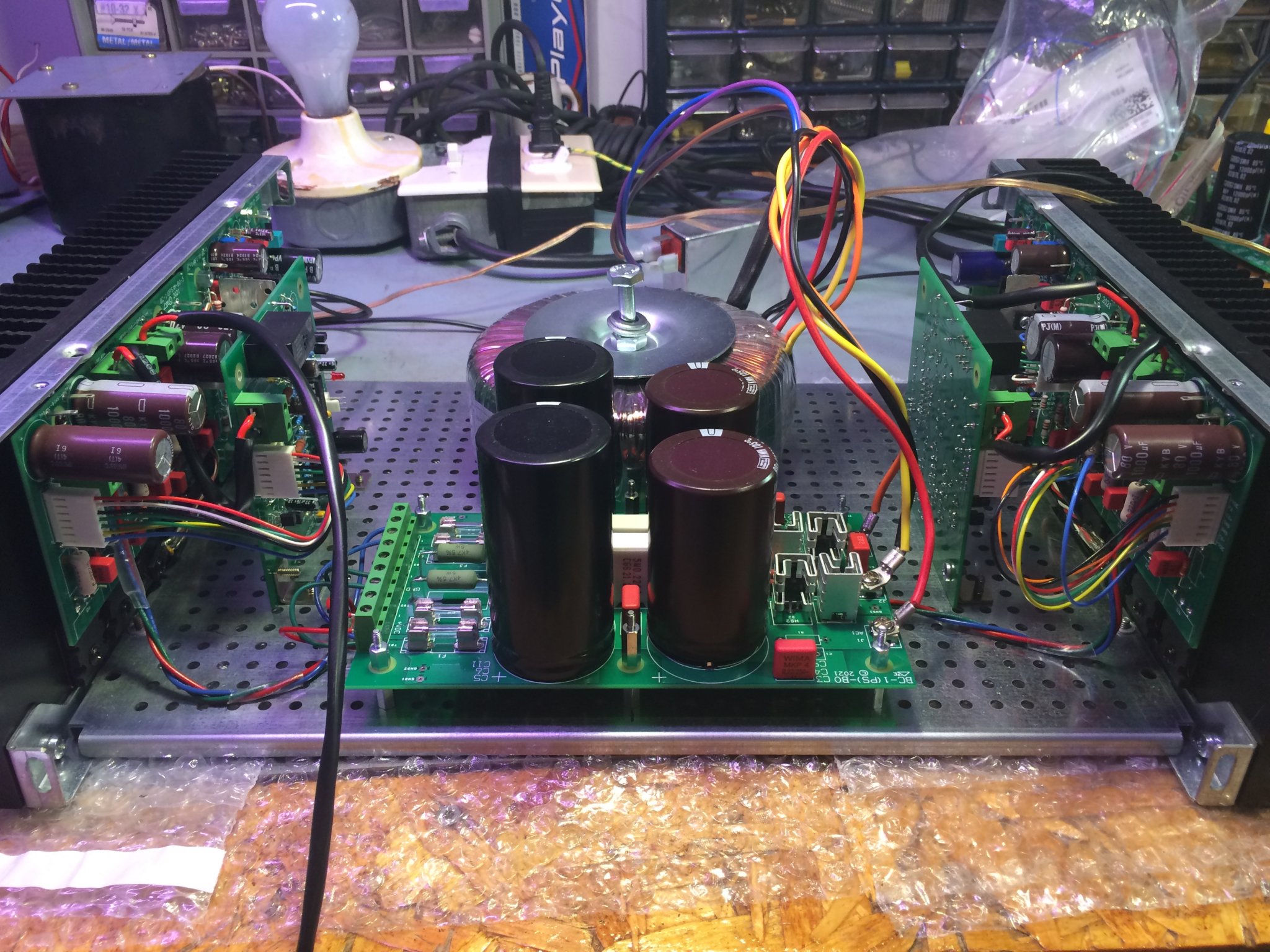

If anyone is interested I have designed a power supply and softstart/AC inlet pcbs for the dissipante chassis, I’ll post a couple of pics showing them installed in the BC-1 amp. The PS uses a triple footprint for 35 & 40mm snap-in ecaps, C-R-C type. I was thinking of another version to use the larger 50mm D ecaps for higher capacity, The pcbs fit the optional pierced bottom pan, can mount H or V orientation.
