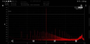

Hi Guys, I have been tweaking my HB over the past few months and have managed to reduce the distortion considerably since my first measurement.
I recently found that increasing the ltp current to 6mA and then changing the LTP degeneration resistors to 120 ohms and changing C7 to 82pf and C8 to 390p to achieve the same unity gain crossover frequency FC. Doing so reduce my 2nd harmonic distortion from -80dB to -90dB and my 4th harmonic from -90dB to -95dB.
First picture is one of my first measurements.
Second is the measurement immediately before the 6mA change.
Last photo is after the 6mA change
Last photo is after the 6mA change View attachment 924507 View attachment 924508 View attachment 924509
