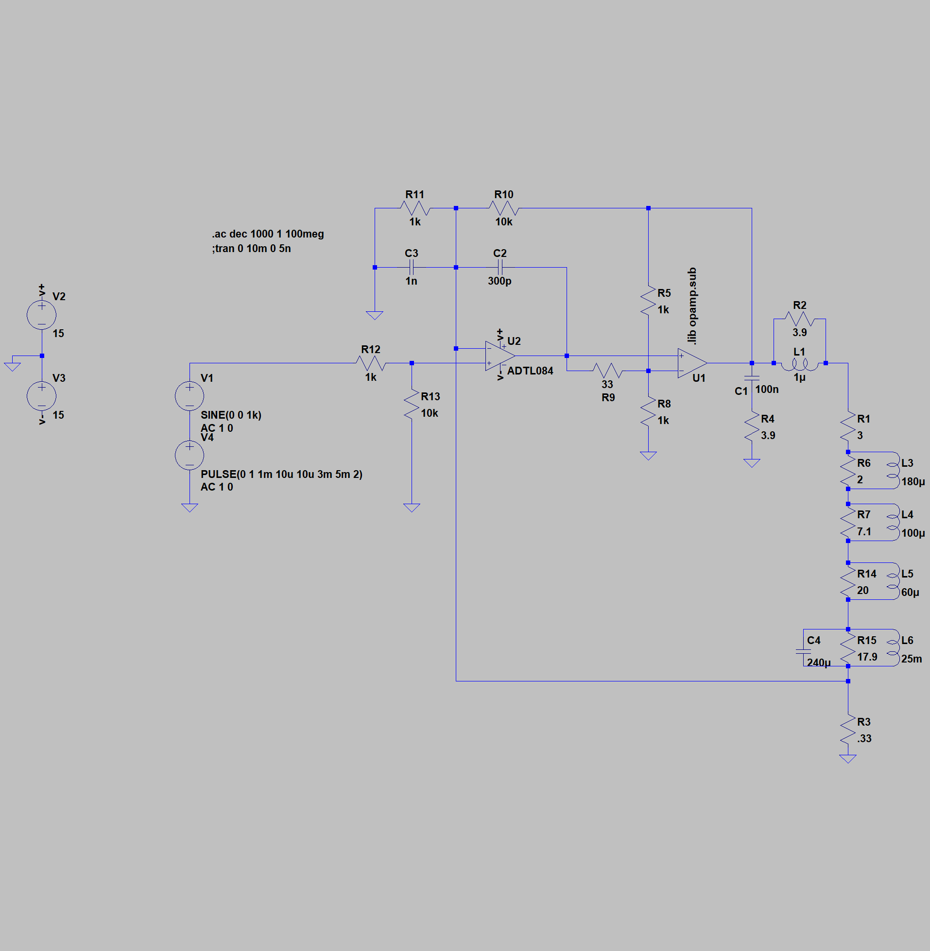

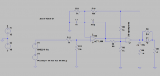

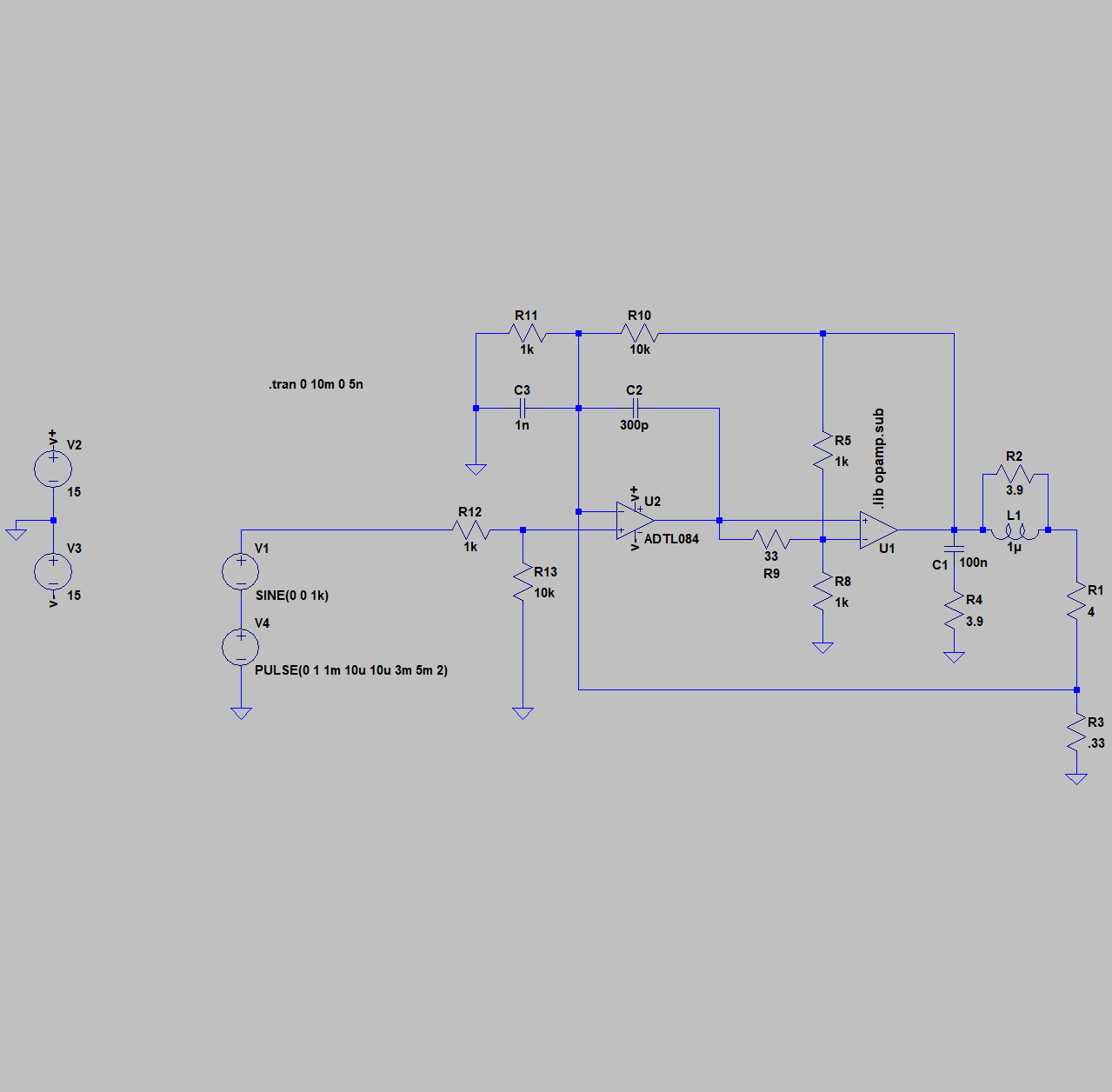

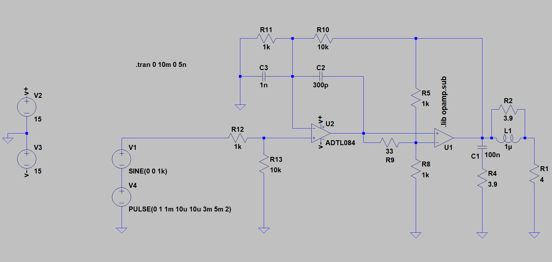

Here is my idea to implement current drive to my actual amp:
Attachment 1: my actual amp, schematic from simulation (works very well in reality!)
Attachment 2: same amp modified to current drive (not yet tested, just an idea for a simple implementation)
Attachment 3: Simulation file
any opinions so far?

The loudspeaker inductance isn't included in the model and will reduce the phase margin and possibly cause oscillations. You could connect the bottom side of R4 to R3 to make your circuit less sensitive to loudspeaker inductance, at the expense of a lowered output impedance.

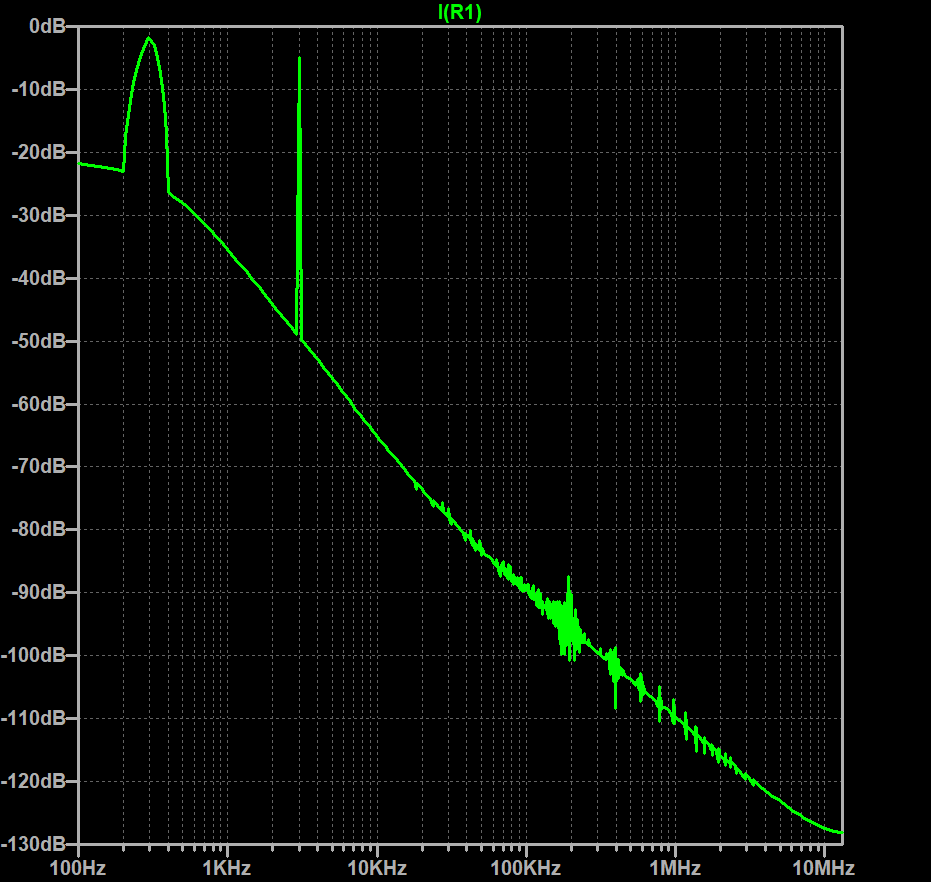

So here it is with a simulated speaker load - no signs of oscillation in this simulation. Hopefully this will also be true in reality - but i am not able to test soon, as i have a lot of other things to do first before i will find the time... 😢

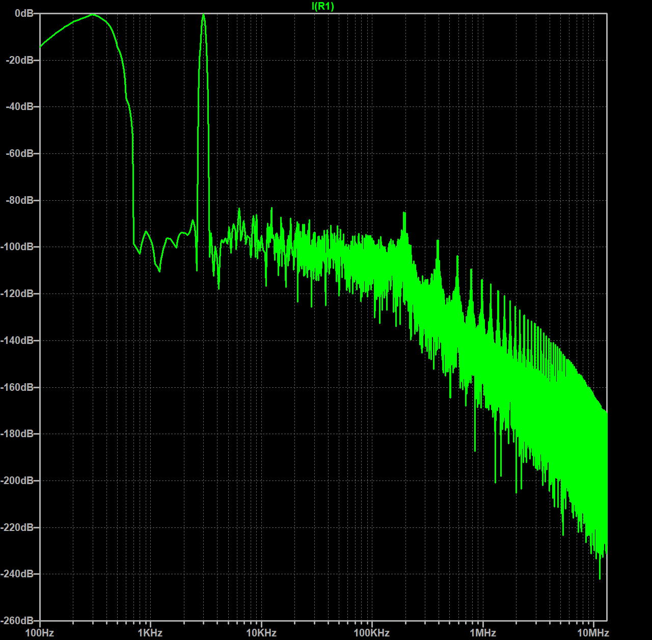

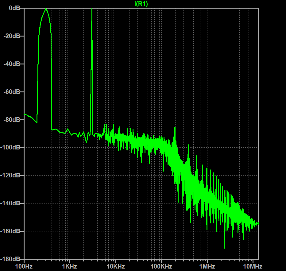

the simulated speaker impedance is a typical one to a 4inch midrange driver, so i simulated with voltage drive and current drive with dual sinewave (300Hz & 3kHz) at the typical operation range of the driver. Simulation was done with the circuits shown above. Here is the result looking at the current through the virtual voice coil
Attachment 1: spectrum voltage driven
Attachment 2: spectrum current driven

and here are the same simulations, this time a blackman harris filter was used for the spectrum, looks like the difference is very small

(Not linear meaning that current and voltage are not proportional.)
