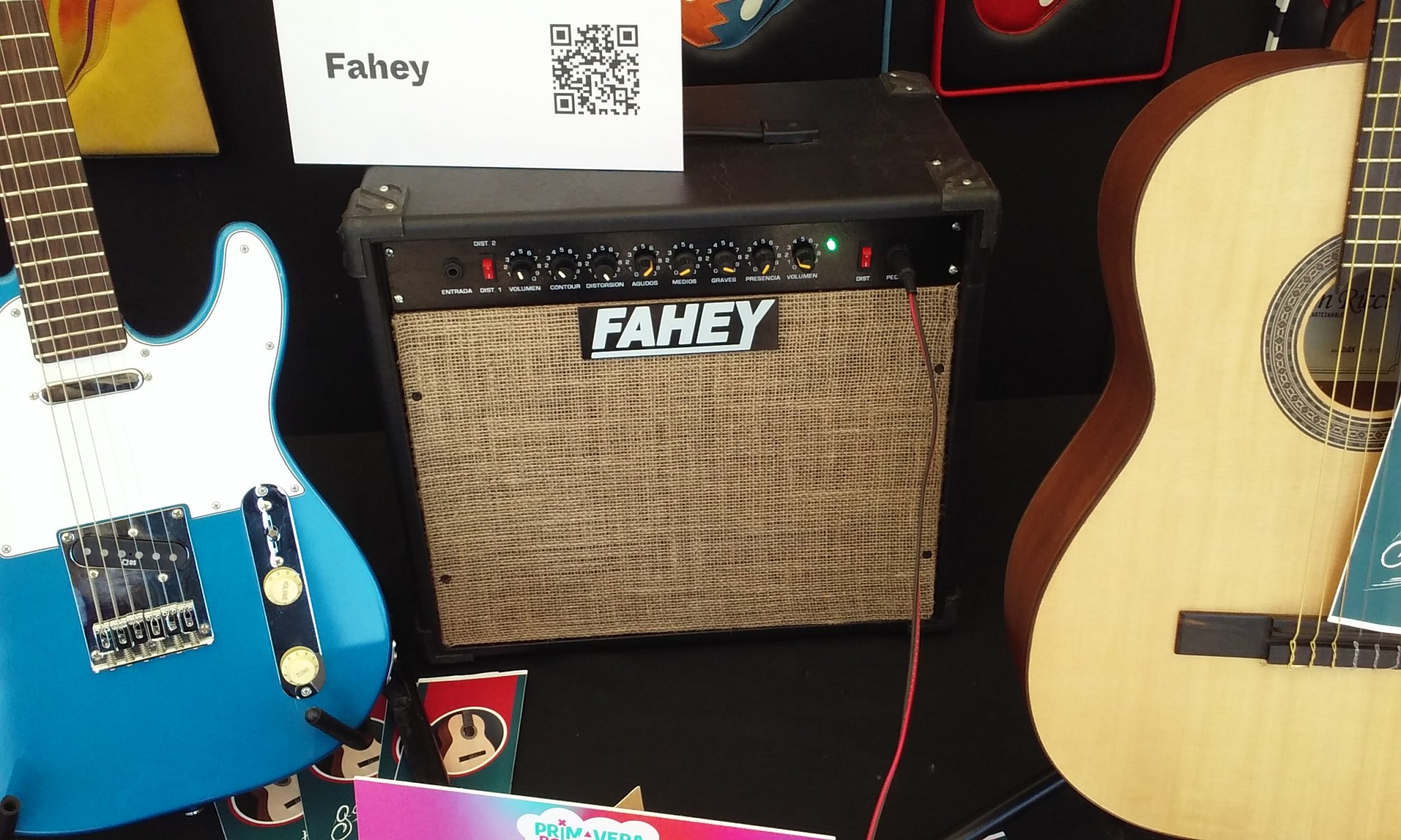

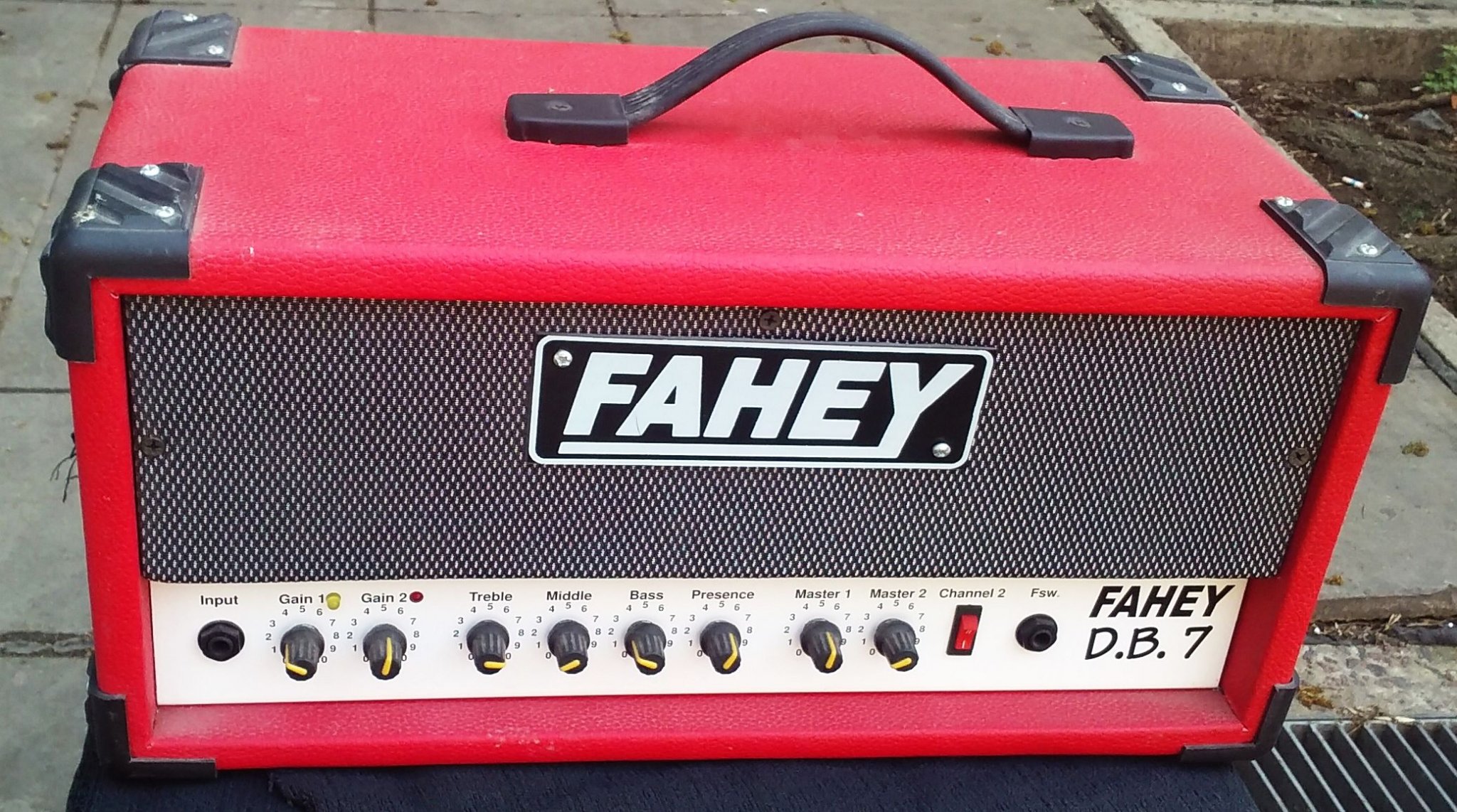

FWIW last Saturday there was an "Entrepreneur´s Fair/Show", including those related to Musical Instruments, and I was asked to send a sample, so I gladly obliged.
It was held at the City Stadium at La Plata , the province´s Capital, some 45000/55000 young visitors assisted.
why do I mention it? .... because it was the only SS amplifier amongst all kinds of Tube ones also shown there ... and musicians kept coming back, go figure.
part of the "special sauce" behind that? ....
well, high impedance low damping mixed feedback, of course.
Might have used pure current drive, but then sound becomes too extreme, razor sharp chest thumping, "too much of a good thing is not good any more" , which I reserve for Metal heads:
