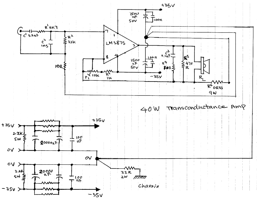

I have posted Daniel/Duo’s 3875 chipamp transamp, Joe’s is based on that.
As i understand things, the addition of a sense resistor in the feedback loop.

Maybe I'm missing something but that thread from 2013 seems to have lost the Schematics .. at least from the earlier posts. Anyone got the 'final' Schematics?Joe trans amp is one option, other that I know of is Pass F1, F1J...
Even https://www.customanalogue.com/diy/Trans_Amp_Schema_Wiring_Caution.gif which Joe posted, doesn't work. Mr. Rasmussen, could you post it here again please.
This isn't a Current Drive amp. It's just a Voltage amp with wonky frequency response.This is one version:
I presume this is temporary, we discussed web site issues recently - https://www.diyaudio.com/community/...uctance-current-amplifier.239321/post-7126809Mr. Rasmussen, could you post it here again please.
Joe has previously stated he hosts the images on his site in order to be able to update them.
@Joe Rasmussen
Who says it´s a current drive amp?This isn't a Current Drive amp. It's just a Voltage amp with wonky frequency response.
Not me.
I am exactly showing what jjasniew described, period.
which my schematic matches to a T.The only one I recall uses an op-amp, with the thus-arranged output devices driven by a voltage drop across resistors to the op-amps power supply rails!
Don´t waste your time (and mine) commenting on things I didn´t say.

Considering the subject of the thread, it is logical to assume that any amplifier schematics shown in it have a high-impedance current output unless otherwise noted.
