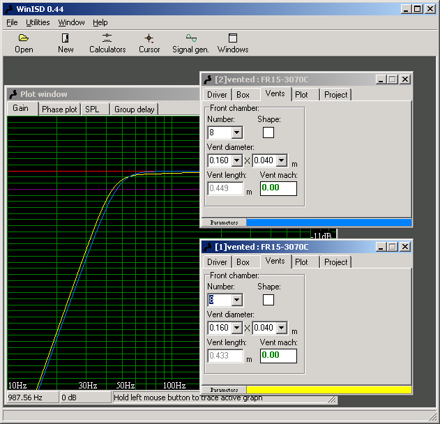

I used Onken calculator and I got:
F3 38.95Hz
97.085dB
and Svent 608 which is closer to Sd more then 512 on Celestion
The box is 256 litres though still not too large IMO.
Also one of the conditions in the Onken calculation is Svent=Sd or Svent no more then 15% smaller of Sd. What would be the consequence if you calculate 512 to be ~40% smaller then Celestion's Sd?

L’ vent (corrected effective vent lenght)
The shorter one since the acoustic axial length of an open tube is somewhat longer than its physical length.

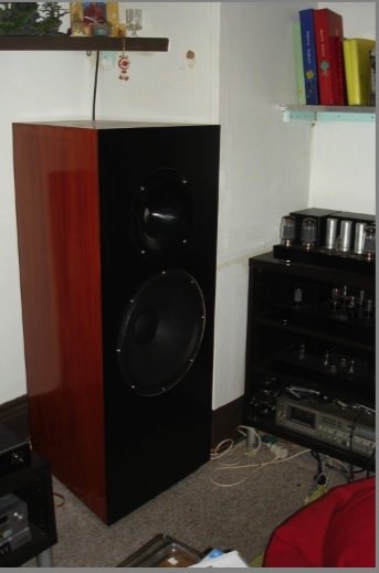

My speaker is finished after following some of Andreas choices, still working on crossover but so far I'm really impressed.
DDS-ENG wave guide
Beyma CP-380
Celestion FTR15-3070
Crossover is a bit strange but the sound stage is huge and horn is very very pleasent (after many previous disappointments), not beaming at all and don't need to listen on axis. The radiation pattern of the DDS is amazing it gives all together with the bass driver an holographic image near 180 degrees.
I swapped the horn with large Fountek NeoCD2.0 for try and I killed the speaker :{ . NeoCD can only be listened within its own narrow vertical axis. I don't like it make the sound stage fake like many commercial speakers. If you stand up from the couch all detail is gone. The vertical beam of the NeoCD is very narrow.
DDS-ENG wave guide
Beyma CP-380
