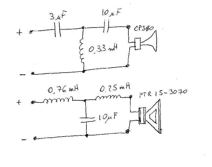

I'm still perfecting around this crossover and so far I'm happy with the sound.
Horn needs L-pad (not shown) just little bit attenuation.
Just giving an idea. If you try on real speaker (not simulation) give me your feedback.

The measurements of the Beyma driver and horn look very good. You might want to try HOLMIpulse
http://www.holmacoustics.com/holmimpulse.php for measurements. It's good, easy to use and free.
You will want to pay special attention to phase when building your crossover. Also look at distortion at the low end of the horn.

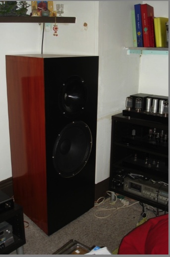

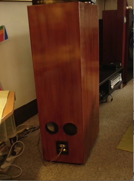

For this large loudspeakers it is impossible use the normal damping articles for loudspeakers because in this case the cost would exceed the cost of wood.
Following the suggestion of my friend Andrea of PuntoMusica I have used two different damping materials used in the cars:
1) panels composed of fabric processing residues bottom tar for the base and the back
2) moquette with longhaired and bottom in lute
see photos:
Hi-End and Hi-Eff loudspeakers system
In an initially test with an improvised filter and still without damping the result is a sound pleasant and not tired with many details.
WF 12dB/oct. 1.4mH 22uF
TW 6dB/oct. 10uF in series with 8ohm
see photos:

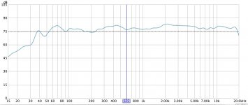

Hi andrea,
I see your measuring window is very long to increase reliable results, you must choose a window small enough to discriminate the reflections.
I use Hobbybox V6. To measure frequency's down to 23Hz I use a 42,67msec window.
And a 5,33msec window for frequencies above 188Hz. In hobbybox I can paste the two graphics to each other I would paste it around 500Hz.
Then you have the best result with out reflections.
When I am honest to you, with a 341 msec window you ad so much reflections it is only interesting for frequencies lower then 50Hz down to 1,3Hz. It is hard to not make wrong measurements.

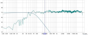

I am just happen to be measuring my own new creation at the moment. A 102-105dB horn system down to 35 Hz.
![DSC00356.jpg](https://i220.photobucket.com/albums/dd181/calilm3/DSC00356.jpg)
Here the result of my own speaker to show you the difference with the length of your measuring window.
Measured right now in my living room 1mtr for the speaker the spl level is not calibrated to 1Watt so it is only a indication. Only to show the effect on the flatness of the measure result.
bleu 341 msec
red 42 msec
yellow 5,3 msec

This is my measurement. Sorry for room reflections. dB is not calibrated to meter. I need to adjust around 50Hz.
Looks very decent. But what where your settings of the MLS software.
Where did you place the microphone.
At 1 metre on average axis between horn and woofer axis. I'm not an expert in this kind of measurement but I hope the mic location is right.
