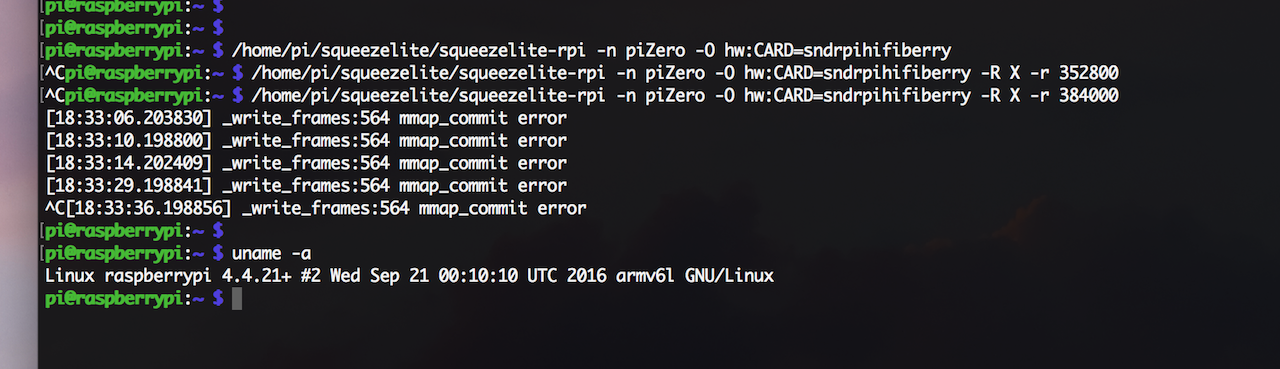

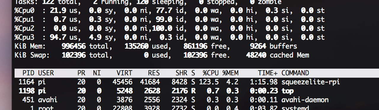

On my piZero/D+Pro test setup it's refusing to play at 384K, 352K8 does, and all other sample rates are fine... I tried other source file sample rates etc, always refuses to play at 384. What do you think?
Edit: At 384K it's playing, but choppy, and CPU pegged at 100%. cat /proc/asound/card0/pcm0p/sub0/hw_params reports 352K --
When playing at 352K it's only 22% cpu usage on the zero.
mmap commit error..... Never seen that before, that's what I think. LOL.
Let me finish putting this 192/24 booboo to bed and I'll see if I can reproduce your issue.

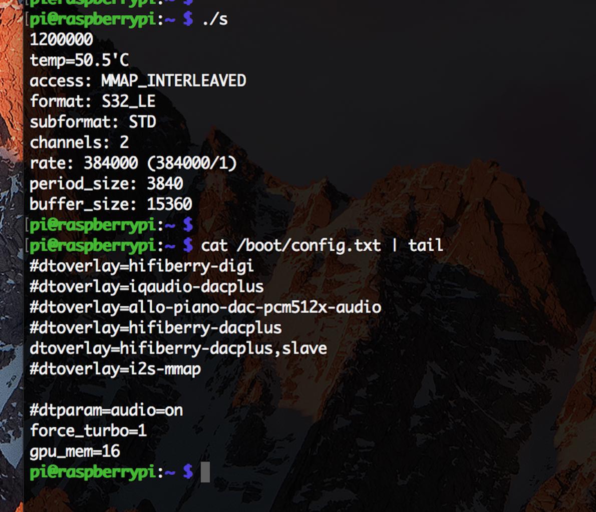

I think the pi3 can muscle thru it, but it reports 352K also... I'll try it again...

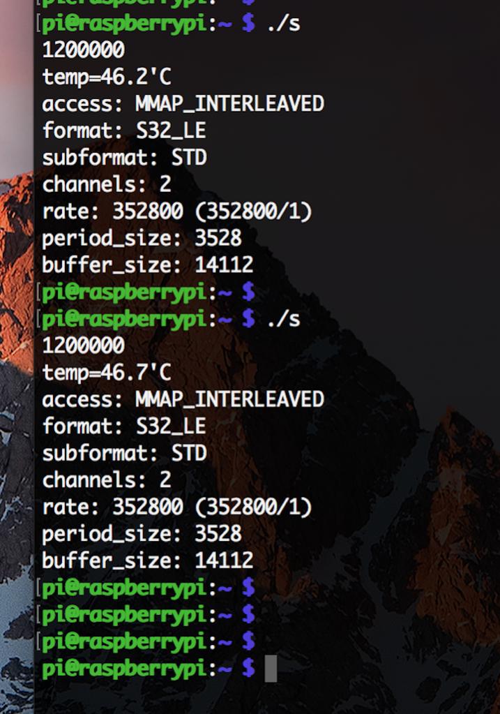

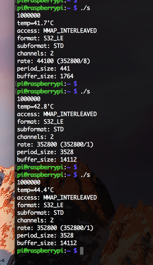

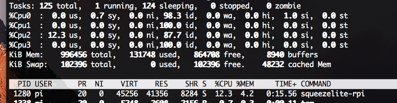

Tried on pi3, it's def not happy at 384K (but does play), and reports 352K--
When set to 352K, it's an effortless 8% CPU.

Don't know. Works fine for me in master mode @ 384k.
Code:
Oct 03 20:29:53 BerryPlusPro2B1 kernel: pcm512x 1-004d: snd_rpi_hifiberry_dacplus_set_sclk: clk_set_rate(24576000) for 384000 sample rate
Oct 03 20:29:53 BerryPlusPro2B1 kernel:  HiFiBerry DAC+ Pro: snd_rpi_hifiberry_dacplus_set_bclk_ratio: frequency=384000, format=S32_LE, sample_bits=32, physical_bits=32, channels=2. Setting bclk_ratio=64
Oct 03 20:29:53 BerryPlusPro2B1 kernel: bcm2835-i2s 3f203000.i2s: bcm2835_i2s_set_dai_bclk_ratio: ratio=64
Oct 03 20:29:53 BerryPlusPro2B1 kernel:  HiFiBerry DAC+ Pro: snd_rpi_hifiberry_dacplus_update_rate_den: updating substream rate_num (384000->384000), rate_den (1->1)
Oct 03 20:29:53 BerryPlusPro2B1 kernel: pcm512x 1-004d: pcm512x_hw_params: 384000 Hz, 2 channels
Oct 03 20:29:53 BerryPlusPro2B1 kernel: pcm512x 1-004d: pcm512x_set_dividers: dac_rate 6144000 sample_rate 384000
Oct 03 20:29:53 BerryPlusPro2B1 kernel: pcm512x 1-004d: pcm512x_set_dividers: DSP divider=1, DAC divider=4, NCP divider=4, OSR divider=1, BCK divider=1, LRCK divider=64, IDAC=64, 1<<FSSP=8
