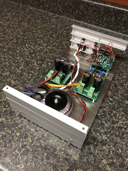

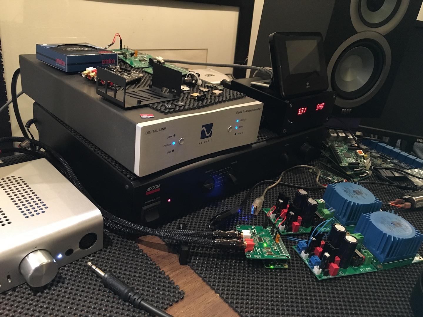

Here's where I'm at as of now...
Raspberry Pi3
1 - My Raspberry Pi3 is running Moode 3.1 with on-board wifi and configured with as static IP address, my router being set to channel 10. Other software has been tried but my opinion is that Moode Audio sounds best. My local group of audio friends also agree - Moode Audio sounds best. In fact, all of the following selections and/or comparisons that I have made have been verified by this very same group.
Getting the wifi working with the HiFi Berry DAC + Pro is really a struggle, even with a wifi dongle; but, once the network was set to use channel 10, it works well - even with the on-board wifi. This is because the local oscillators on the HiFi Berry DAC + Pro interfere with the wifi signaling on channels 1, 6, 11 and 14, see: https://www.tablix.org/~avian/blog/archives/2016/12/hifiberry_and_wi_fi_interference/ Thus, it is best to avoid those channels by avoiding automatic channel selection by the router and selecting another channel, for example, I choose channel 10.
2 - Power for the Raspberry Pi3 is feed into GPIO header pins 2 and 6, see https://pinout.xyz, bypassing the protection circuitry after the micro usb connection comprised of a current mirror, etc. shown in the upper left hand corner here: https://www.raspberrypi.org/documen.../schematics/RPI-3B-V1_2-SCHEMATIC-REDUCED.pdf Somewhat surprisingly, this is a pretty nice upgrade over powering via the micro usb connector. Others have found the same, albeit in a little different configuration.
3 - Power to the Raspberry Pi3 is from a 5 volt, 2.5 Amp, micro usb, switch mode wallwart, see: QVS 2.5Amp 5.1v Switching Power Supply for Raspberry Pi B with Built-in 4ft Micro-USB Cable ARUSB-2.5A - Micro Center
Before you laugh and dismiss what I’m about to say, just because it is a SMPS, here’s what has been tried in terms of linear supplies. Both of the later mentioned DIYINHK regulator boards, a garden variety LM317 implementation, a discrete high speed wide bandwidth linear regulator of my own design loosely based on some work I did with John Swenson, a huge HP lab supply weighing more than 35 pounds and another more generic adjustable linear supply. In every case, the little wallwart won out sonically - and not by a small margin.
Why might that be? Well, and this is true of all computers, it turns out that the Raspberry Pi3 load fluctuates wildly. For instance, on one of the aforementioned linear supplies that has a digital read out for current, the current varied any where from a couple tenths of an amp to over 2 amps. I know this isn’t exactly accurate but, it give you some idea of what is happening. Further, two of these linear supplies have the ability to set an upper current limit, It wasn’t until the current limit was set to over 2.5 amps that the supplies worked for the Raspberry Pi3.
I am using a bus power USB Hard Drive.
Still, computer loads vary wildly and are very dynamic in nature. Practically, SMPS are better suited than their linear counterparts in dealing with this.
Again, the sonic differences here were not subtle.
4 - Pins 1 and 17 in the GPIO header are bent over so that 3.3v does not pass from the Raspberry Pi3 to the HiFi Berry DAC + Pro.
The HiFi Berry DAC + Pro’s claim to fame, if there is one, is the ability to run the PCM5122 off local on-board oscillators rather than running the PCM5122 in PLL off the clocking provided through the GPIO by the Raspberry Pi. We all know the oscillator frequency of the Raspberry Pi is not an integer multiple of a sample rate frequency, see: The Raspberry Pi: Audio out through I2S | Dimdim's Blog, so this must be done to have any hope of a low jitter signal.
I did run a PCM5102A in PLL mode in comparison to the HiFi Barry DAC + Pro, and if you know what lower jitter sounds like - this is it. The sonic advantage is clear. I applaud HiFi Berry for being the first to do this in a Pi HAT. It is the reason I bought it. And, I’m still glad I did - in spite of the wifi frustrations which I feel now are basically moot.
Before we get into what I did to the HiFi Berry DAC + Pro let me say, I’m a TI/BB DAC chip fan, have been for a long time. I’ve tried many others, one of which is the ESS brand. I know there are HAT DACs using the ESS chip(s) with their own oscillators but I always hear the ASRC in those designs.
The secret to getting good sound from the PCM51XX series lies in the implementation and, more so, to the supplies. Here’s what I did.
1 - I used WBT Nextgen RCA jacks. This is a no brainer in my opinion and makes a noticeable difference. I caution anyone against removing the RCA jacks on the HiFi Berry DAC + Pro. The traces from the PCM5122 output filter to the through hole solder connections provided for adding your own RCA jacks is quite thin and goes under the on-board jacks. Frankly, I think HiFi Berry could have done a bit better job here with this trace work. You’ve been warned.
2 - I changed the caps (C7, C8) in the LPF after the PCM5122 to PPS caps, Digikey P/N PCF1457CT-ND as suggested by Greg Stewart. Generally, I have found over more than a decade of messing with DACs that more often than not, you’re better off without these LPFs. But, not in this case. Changing to this type of cap (PPS) is a definite improvement.
3 - I also did the other capacitor changes suggested by Greg; but, once you’ve done the supply changes below, their efficacy is reduced.
4 - For the PCM5122 analog supply, I removed the 0 ohm resistor (R14) and the on-board 5 to 3.3V regulator (U2), bridging across the input and output pin land areas, and feed 3.3V into P3. The regulator in the supply is the TI TPS7A4700, see: 4.17uV Ultralow noise DAC power supply regulator 3.3V/5V 1Ax2 - DIYINHK I’ve found over time that I prefer TI regulators with the analog section of Ti DAC chips - go figure… If you want to leave the on-board regulator and feed 5 volts in, you can do that; but, it is a little better without U2. Kind of a trade off between the regulator being proximate the load and having a better regulator.
For completeness, a garden variety LM317 based, a discrete current sourced, shunt regulated, and several other of the latest generation series type regulators were compared here. The TPS7A4700 won out.
5 - For the PCM5122 digital section and the clocks, having bent pins 1 and 17 over in the GPIO header, I put a white wire jumper between GPIO extension header through holes 1 and 17 and feed 3.3V into vias 17 (+3.3v) and 20 (GND). The supply is based on the LT3042 with a pass element for additional current handling and has a common-mode choke on the input, see: 0.8uV Ultralow noise DAC power supply regulator 3.3/5/7V 1.5A*x2 - DIYINHK The notion here was to provide the wildly varying peak peak current demands associated with processing while prevent any noise from making its way in or out of what was being supplied.
I did try separate supplies for the digital section of the PCM5122 and the clocks; but, frankly, there wasn’t enough difference to make it worth the trouble.
Again, for completeness, a number of supplies as mentioned herein above were compared; but, this one won out.
6 - For the AC feed to the two above supples, I use a 50VA 6V+6V toroid, having a 4.17 amp rating per winding. I tried lesser rated toroids and E/I based transfomers but the 50vA toroid really made the sound stage much, much better. I was surprised.
Conclusion
Finally, all of the forgoing was mounted to a 7” by 12”, 1/8” thick 6061 aluminum plate. Front and rear panels were fabricated from 1” by 1/2” aluminum channel stock. A lid of correspondingly sized 6061 (not shown) was also made. The difference from mounting everything to the plate may likewise come as a surprise to some; but, I’ve had this happen before. Metal standoffs and rigid often times helps clocks and, in this case, you could sure hear it.
At this point, there’s not a lot else to try. Maybe some galvanic isolation; but, that’s about it.
Hopefully, this inspires others to try something. You just might find that having a USB interface between you computer and your DAC isn’t all it is cracked up to be...
