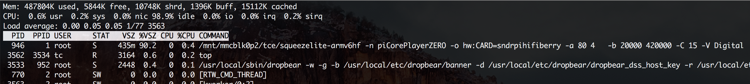

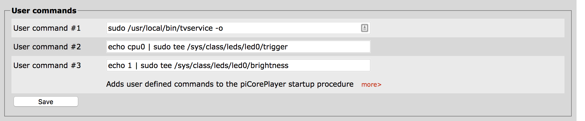

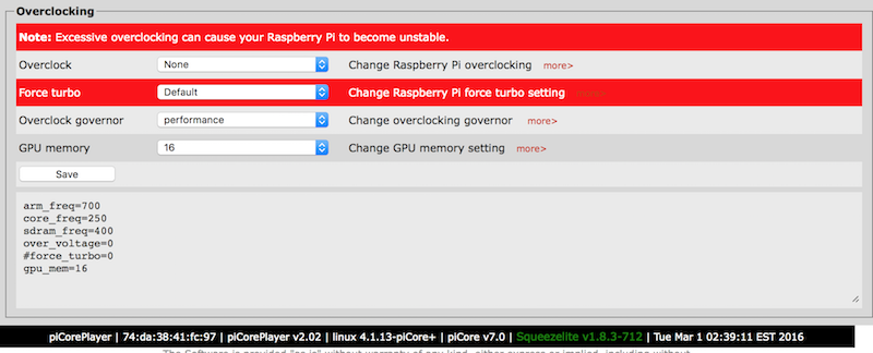

Why? Really not a fan of the volumio/moode style-- did you notice moode does not handle the volume correctly at all with the Dac+?
Did you see the overclock menu (has other options) not sure why you'd ever want to overclock?
I have LMS convert every format to PCM, so the pi never transcodes, the cpu is practically idle while playing music, plus with the huge buffer there's just a 4 second burst of network, then there's 0 network streaming--
Also the ZERO is perfect for this, every other pi has something unneeded, like ethernet, camera, analog audio, etc...

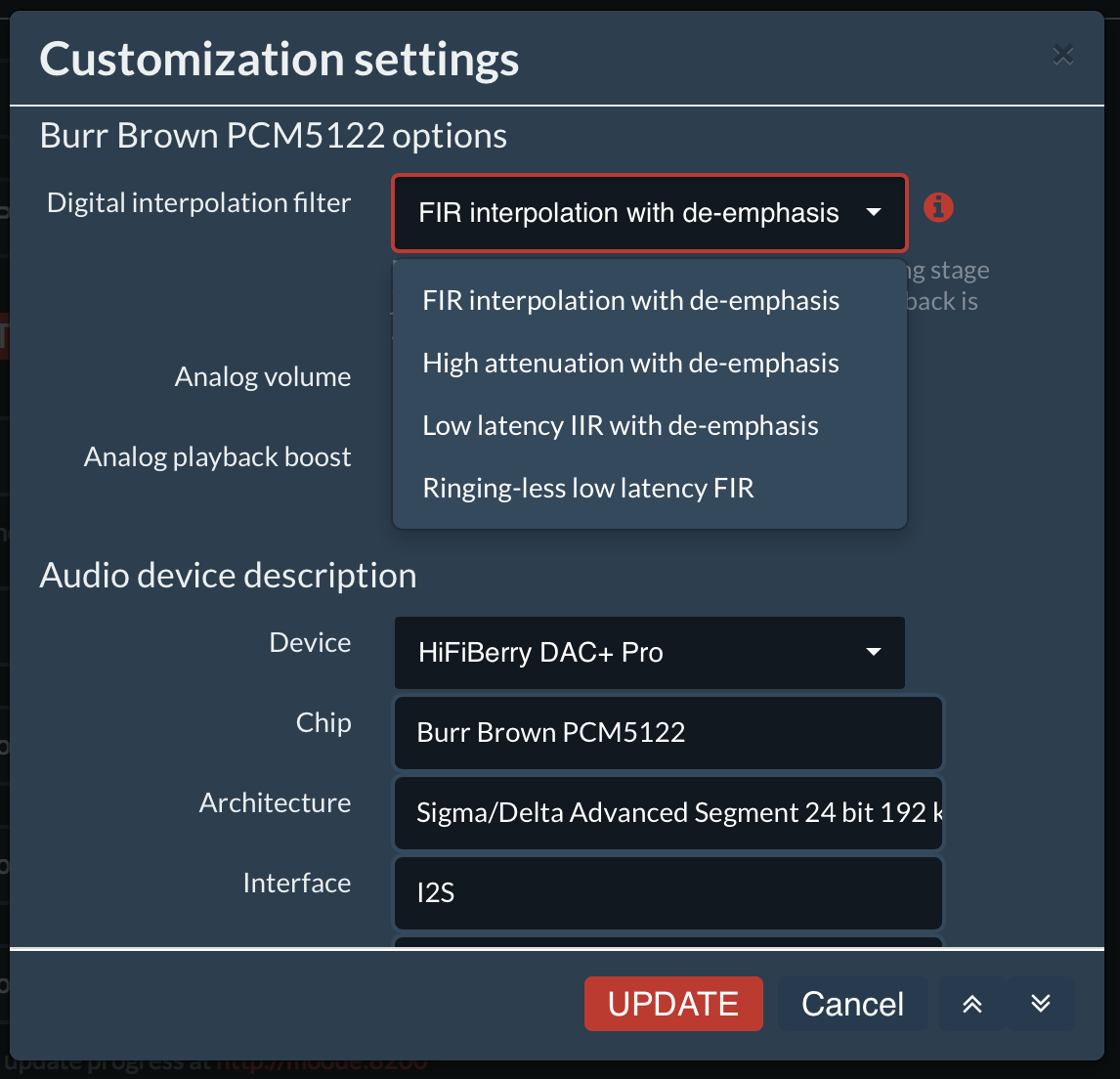

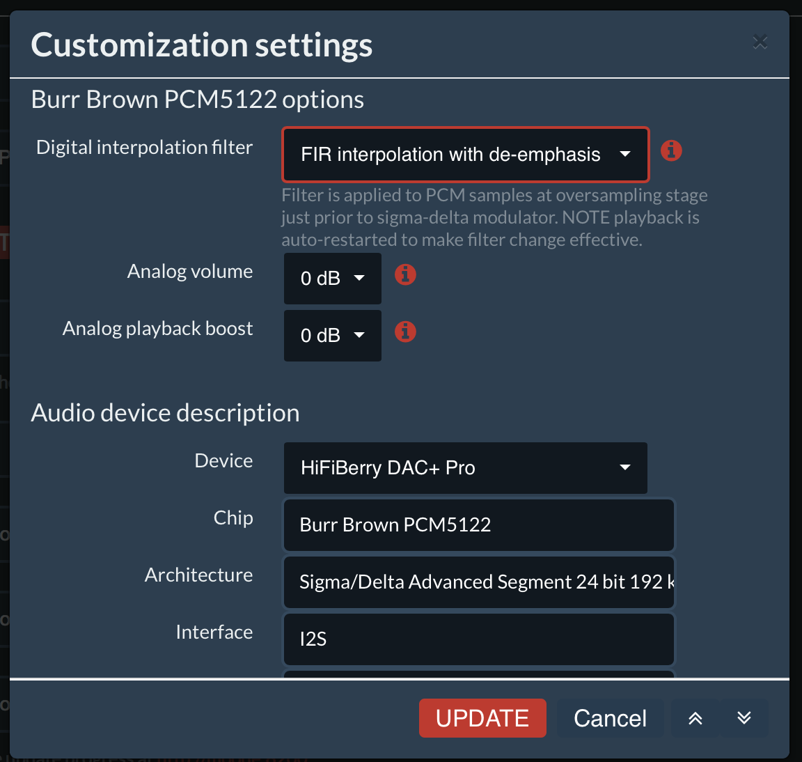

moode PCM5122 filters
Did you guys see this in the newest moode?
I've not bothered to play with it because the volume is so screwed up using the Dac+ Pro, can't verify it's set to 0db, and out of the box it's set to a millionDB & is all distorted 😀

Very neat on the Moode thing with the filter options. Those are the four different filters built into the DAC chip. While they won't provide the nirvana possible with custom-tuned 352/384 upsampling filters that bypass these four, they will provide some ability for users to tune the sound a bit.... of course after the volume is working well in Moode.
