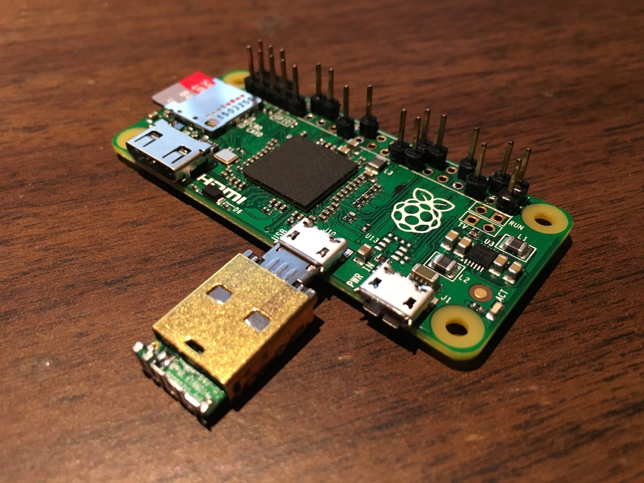

piZERO
Just some info on my piZERO:
I soldered only the needed pins for the DAC: power, grounds, i2s, EEPROM
Use piCorePlayer with large 420MB buffer (goal is no network activity most of the time, just the 2 sec burst at the start)-- I like that the RAM chip is stacked on the CPU. On the pi2,3 the RAM chip is across the board underneath (possible interference from the traces)
HDMI disabled.
Then of course dual linear power thru the DAC: separate analog, pi (thru gpio)
HDMI disabled.
