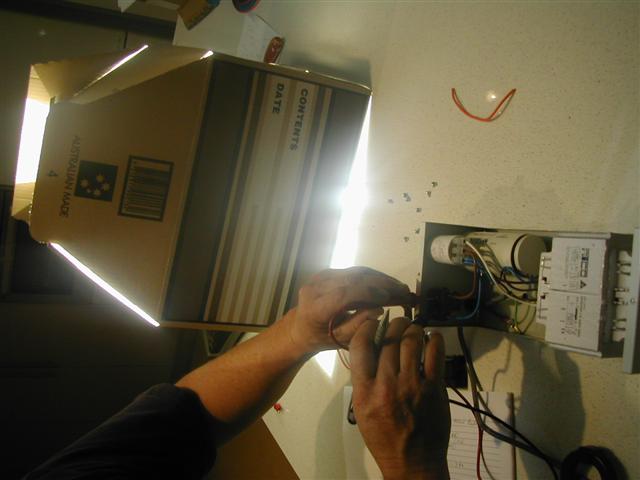

Here are the results of the voltage and current testing we did yesterday.
We could only get accurate readings for AC current from the PMA161X and now that ywh has stated that it is an AC ballast it makes sense.
Assumption: the lamps from ywh are in fact 250W AC lamps. ywh has now stated that they are AC.
Test 1: PMA161X + YWH 250W lamp
Test 2: 150W eballast + YWH 250W lamp
Test 3: 150W eballast + HQI-T 150W lamp
Test 4: HPS 423W magnetic ballast + HQI-TS 400W Daylight (5200K)
I think this shows that the Ushio PMA161X ballast is in fact a 160W AC ballast.
What to do now?

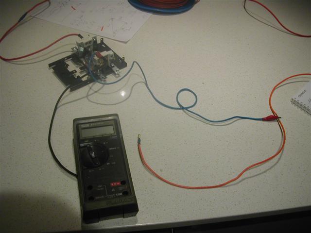

Code:
Input volts = 244.8 V
Input running current = 0.68 A
Input start current = 0.34 A AC
Input W = 0.68 A x 244.8 V = 166.464 W
Output Volts = 71.3 V
Output Current = 2.36 A AC
Output W = 2.36A x 71.3 v = 168W

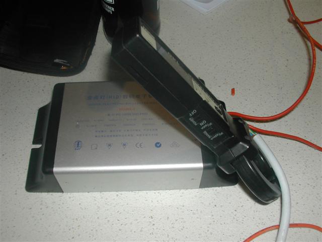

Code:
Input volts = 243.5 V
Input running current = 0.60 A
Input W = 146.1 W
Output Volts = 70.3 V
Output Current = 2.19 A AC
Output W = 153.9 W

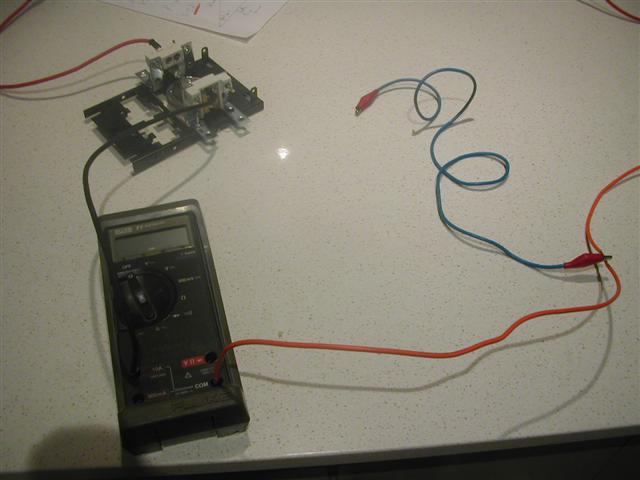

Code:
Input volts = 242.8 V
Input running current = 0.62 A
Input W = 150.5 W
Output Volts = 98.6 V
Output Current = 1.62 A AC
Output W = 159.7 W
Code:
Input volts = 245.1 V
Input running current = 2.16 A
Input W = 529 W
Output Volts = 138.1 V
Output Current = 3.8 A AC
Output W = 524 W (overdriving the lamp!)
What to do now?
1: Get a 250W electronic ballast so I can use the 250W lamps to there full luminace but shortened life potential.
or
2: Ask ywh to source a 250W DC ballast + 250W DC lamps.
