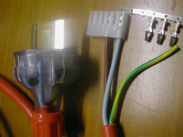

input power: 3 pin connector
pin numbering: pin 1 closest to corner of PCB
pin 1: earth not connected
pin 2: active - brown wire from extension lead. fuse is connected to it.
pin 3: neutral - blue wire from extension.
Cut up a spare extension lead and added a 6 hole connector from jaycar that has the same spacing but I'm only using 2 of the connectors. Filed down a plastic catch on the 6 hole connector so it would fit properly.
It looks like 2 wires have been previously soldered to the bottom of my PCB for power input, so you could do the same but I wanted a more flexible approach. I wonder if my ballast used or just tested?

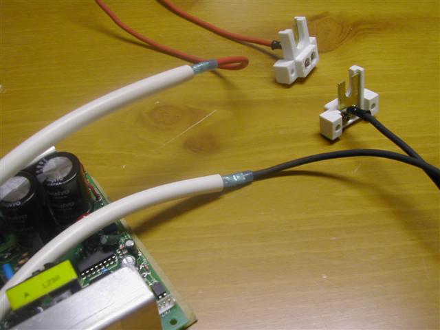

ywh has soldered a short circuit on a black component next to the small four pin connector. This causes the ballast to turn on as soon as power is applied to it, so no need to add a switch or short circuit it yourself.
The ballast does require active cooling or it shuts off. I know, I thought something had broken when it did it. I have since put a fan on it and had it running for several hours.

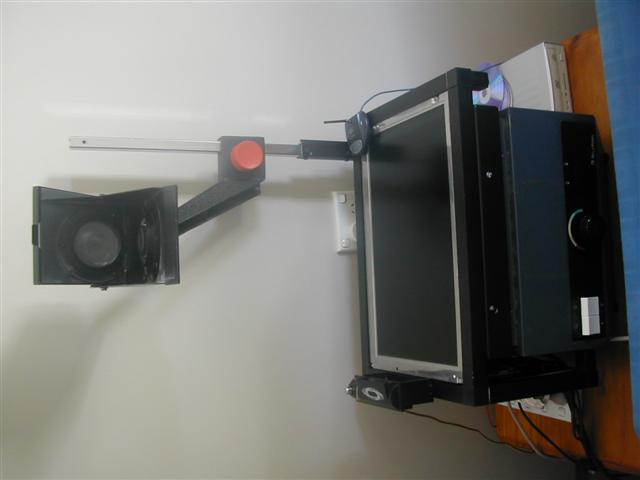

I'm looking forward to putting it into my gutted ohp and lighting up my SGI 1600sw panel. I am currently only using a HQI-T 150W 8mm arc.
I'll try and do some comparisons.
I also have a dukane 670 with a HMI 575W which I might put it up against.
more to come... better start my own thread.
pic: a small sun on my table..

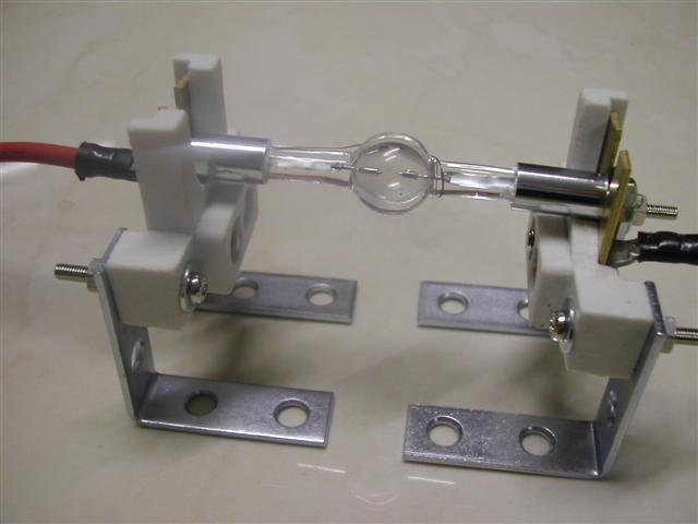

I already had those other lamps. They were for size reference.
I have 3 x 150W MH lamps (currently happily using one in ohp). I could risk one of them but I thought they needed AC power. I also have a 150W eballast. I don't know if it is AC or DC, I'll have to check with the supplier on Monday.
The PMA161X ballast makes the same humming noise as my 150W eballast. I cold try one of the new 250W lamps on the 150W ballast and see what happens.

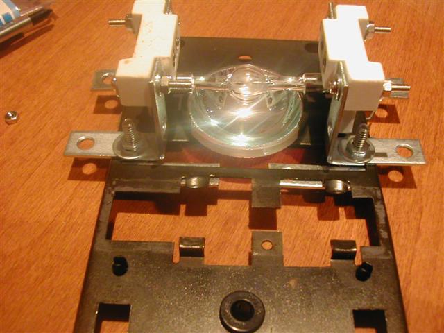

BTW. I put the new kit in my ohp and had a very short look, no time for adjustment. Colour was better than my 4200K, 150W lamp but brightness was about the same. A little disappointed.
The holders are mounted upside down in the following pic so I could get the right height above the relector.
