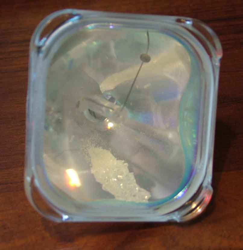

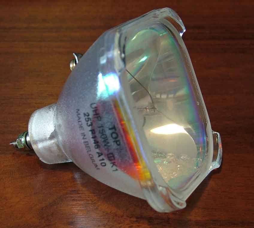

to YWH here is a picture of the lamp I need 150 UHP it is approx 63mm wide 70mm high about 80 deep including screw terminal

to YWH here is another pic please let me know if you can help me and if you can how much to send to 18wheeler thanks again if not i will may try one of the 150w double ended lamps but there is not much room and my outer reflector was cracked when it exploded
It lookes the same lamp as the one in your picture!!!

I can't give you my reflector,There's a crack in my reflector.
I can get some ord secondhand reflector without crack in shop,about 40~50$,what price is your hope?

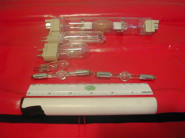

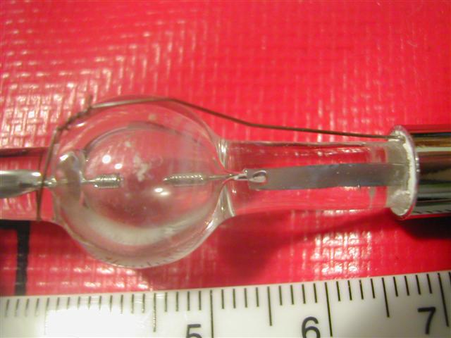

I got 150W YWH lamp !
The lamp is so small and the arc is about the same as the original bulb arc.
I insert the lamp to my Hitachi projector with 60V 150W E ballast and the original reflector.
It was hard to find the right place in the reflector, 1mm up or down and I lose most of the light.The Hitachi original bulb give 500 ANSI lumes and this lamp give the same lumens, I can see good pic at daylight with the windows 3/4 close.
With osram 4200K 150W HQI, I had only about 100 lumens in the original reflector,
The colors are much better too.
I think that the lamp is about 5000K.
Still I need to do more testing , to see if I can do better.
Do you know why I have only about 5000K and not 6500K, is it my ballast?

the lamp is 7000k,shlomid said:I got 150W YWH lamp !
Is this lamp need the right polarity (+) ( -) ?
I will post pictures soon.
big electrode is (+)

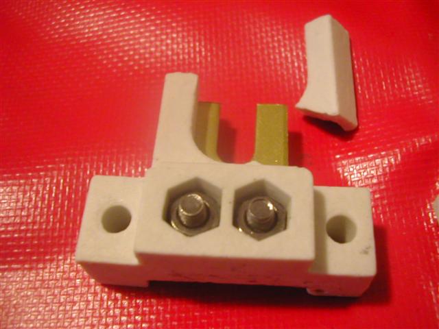

I received my kit this morning. Thank you ywh.
Kit is as shown in post #107 http://www.diyaudio.com/forums/showthread.php?postid=678568#post678568
One of my ceramic holders is broken. both lamps are ok, they where packed in a pvc tube.

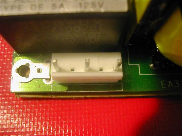

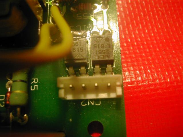

Now for some wiring questions:
1. On the 3 pin power input what is connected to each pin?
I think earth is on the left. what about the other 2?
2. 4 pin connection. Do I short circuit the 2 pins closest to the metal shield to turn it on? What do the other 2 pins control?
3. The red and black cables that connect to the lamp. Does it matter which end of the lamp they connect to?

prime said:4 pin switch connector.
Do I short circuit the 2 on the left to turn it on?
what do the other 2 pins control?
I think YWH has soldered two pins of the 'blocky' component on the left just above the connector in the picture. that was the place that needs to be connected to light up the lamp.
I think the lamp holder will work just fine even with that one corner missing.
if you are replacing your existing lamp, please post comparison here. thanks a lot!
Which bulbs did you order?prime said:ywh
So other can know which ones work.

I also have received the 250w lamp ballast kit, quick question though, the ballast's wire jumper can be set to 100V or 200v. Is this an approx. voltage as in Aus we use 240V. I discovered that China uses 220V, so I am persuming that it should be OK.
To answer one of Primes questions, the centre pin is more than likley to be used as the active line as it runs directly to the fuse.

- I got my new lamp. It is for commercial projection use. people use it to replace the
