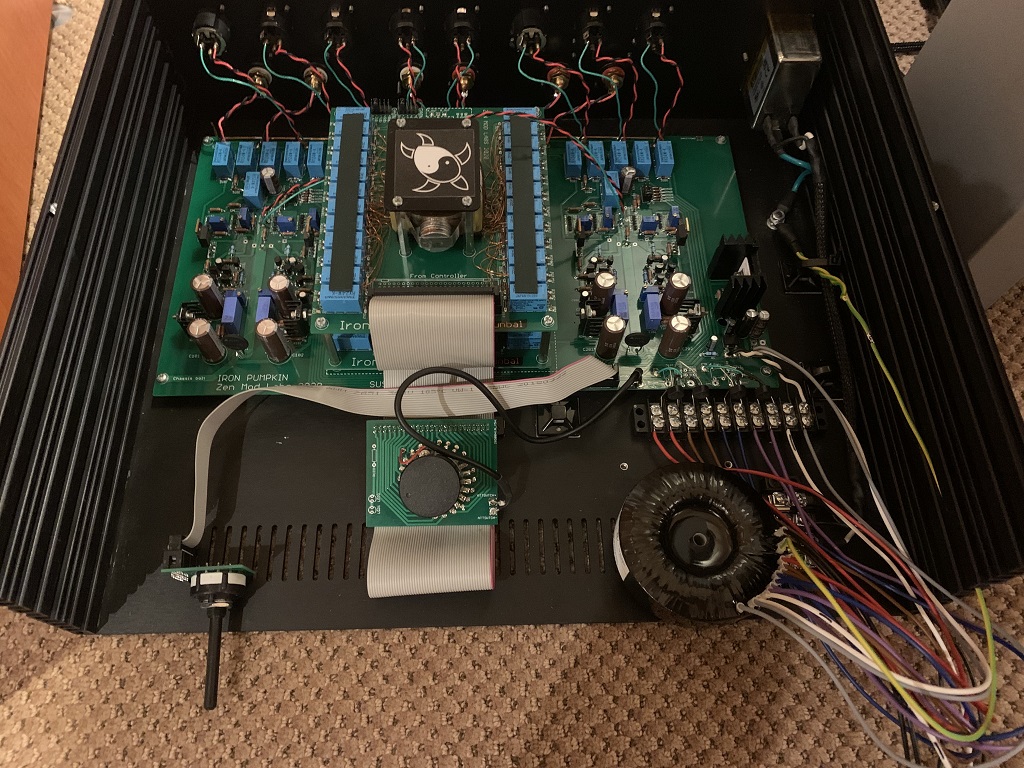

Rail noise seems to be ok...
Just tried
RCA input with RCA output = good
RCA input with XLR output = no good
XLR input with XLR output = good
XLR input with RCA output = good but last 3-4 volume notch I get low hum (I'll never reach that level in real life...)
This was tested on a single channel, left channel.
SE/BAL relay seems to be energized on both RCA inputs (1-2) as I see 22.5V on relay coil.

take care that is possible to get hum, if you're using input with nothing connected to it
now - I remember you confirmed all readings between channel GND and chassis
taking in account that practically everything is in board, all I can think now is - check all wiring once again ..... input by input, in between buffers and Turtle, from Turtle to MoBo, from MoBo to output connectors

I'm getting desperate... How much for a new bare PCB with SMD soldered? Just in case I crapped out some jfets... It's weird that both channels have the same issue but it seems to be just like that when using balanced input with SE output... Anyways, I might just try to rebuild everything again... If only customs didn't crapped out my first PCB...

make pause for few days, to let some air in the head
then prepare proper light and send me as much pictures you're in the mood to make
dunno is it possible that you did something with JFets, if you're able to set 20mA Iq and proper 0 output offset on buffers
same with small JFets beneath pcb (CCS for voltage references and feed for shunt CCS) ....... if you have steady rails without noise, everything there is OK

Yes, construction is quite easy and setup is also a breeze. I just don't know what is wrong but I have decided to get rid of the three toroid and buy a single one from Toroidy with all required secondaries. I never had issues with R-Core in the past, so I decided to use the R-Core that were supposed to be assigned to this project, to another preamplifier I already had, only to realize I was getting a faint hum/buzz, which I didn't have before... I'm guessing those R-Core are not up to R-Core standards and probably super crappy made...
My project is now paused for a few weeks, or until I receive the new toroid from Toroidy. I somehow find it odd it could be as simple as that, but who knows... I'm testing all sorts of scenarios...

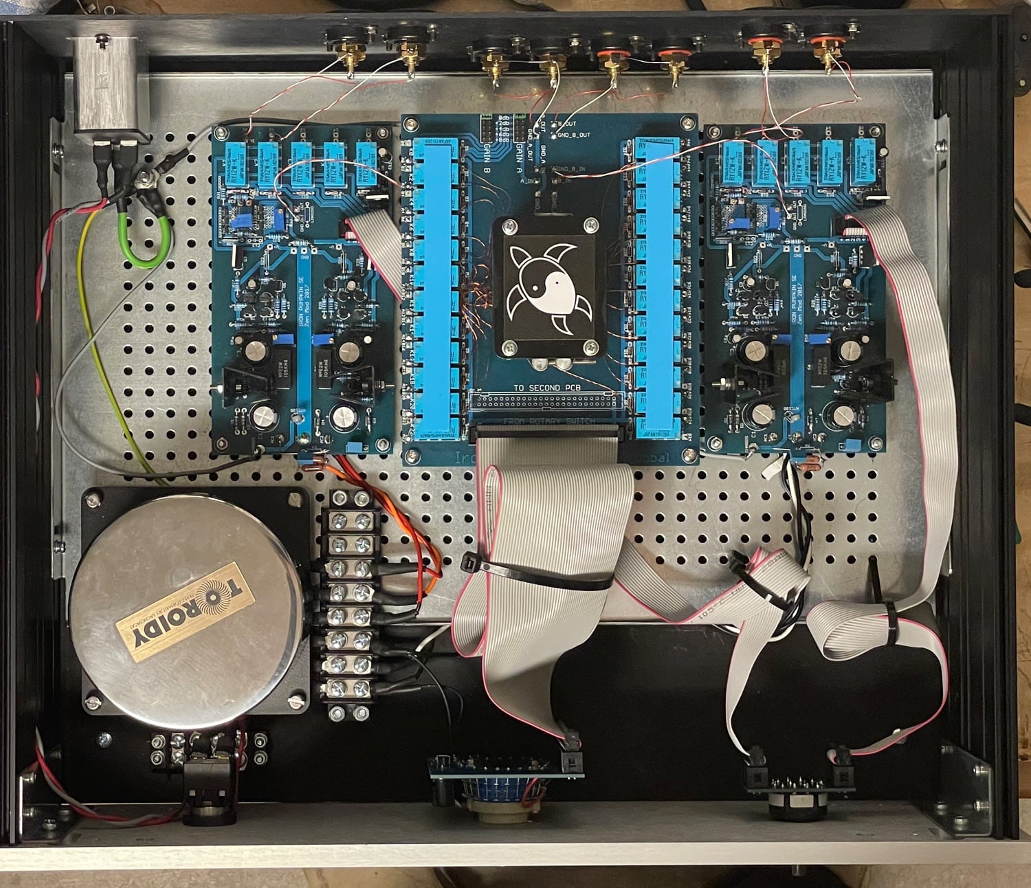

It's been a while since I updated my project, but I was waiting on my transformer from Toroidy.
I did receive the transformers on Monday (only one for this project) but could only work on this tonight (or early in the morning...). Well... After installing the new transformer, the Iron Turtle is total silence, even at loudest volume!!! No more buzzing!!
So yeah... Just use a good transformer as per ZM!
So happy!!!

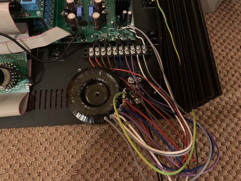

Here's a couple pictures of the temporary setup
