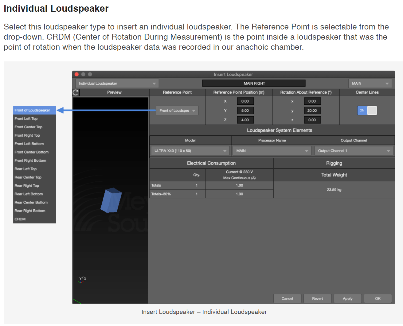

As an example, the point of rotation that was used for a particular set of directivity measurements is explicitly defined on a per-speaker basis in the Meyer Sound MAPP3D coverage prediction software:
https://mapp-3d-help.meyersound.com/loudspeakers/
This ProSoundWeb article has an example of a common approach to choosing the appropriate point of rotation for a multi-way speaker:

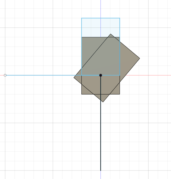

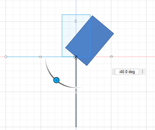

When the front centre of the baffle is used as the rotation point the measurement distance is kept equal when rotated, the black line.
When an offest position is chosen as the rotation point the length of the black line to the speaker baffle/edges changes, it is the same to the point of rotation but the speaker itself gets in the way.

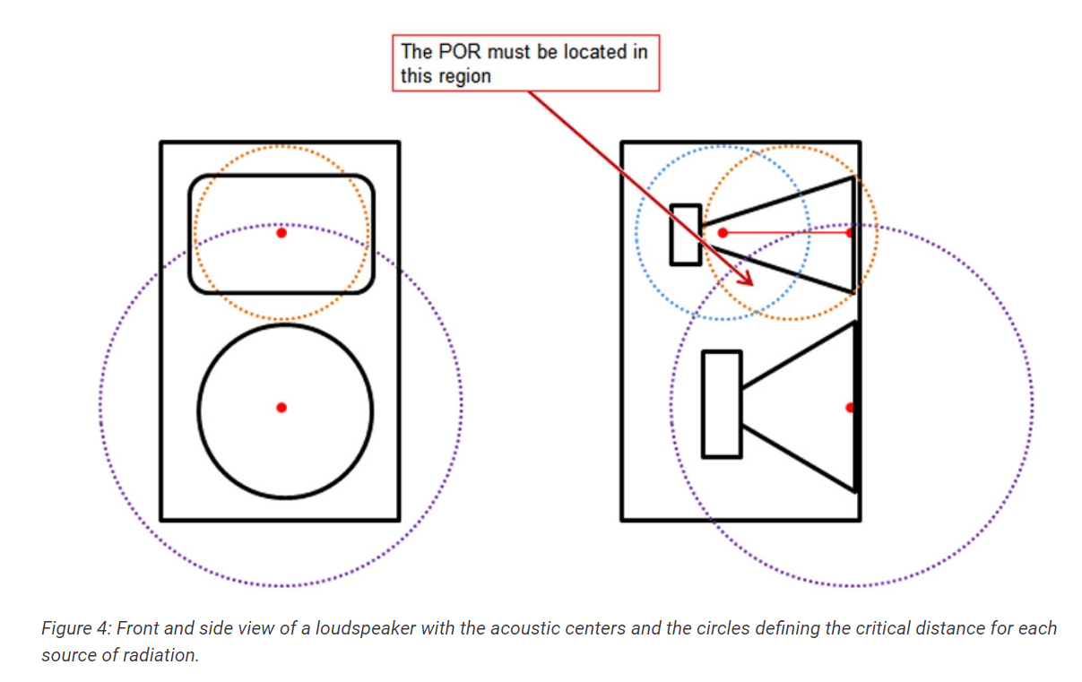

I agree, hence sharing the links and the image indicating where the combined acoustic centre is likely to be for a two-way cabinet with HF horn and direct-radiating LF driver.We are not interested in the acoustic center of a specific transducer, but of the whole system.

The point of rotation is shifted both on the Y-axis and the Z-axis on the diagram.Moving the turning point vertically as shown in those picture, is the same thing as moving the mic up, but still let the speaker rotate around de front of the baffle. Or just tilting the speaker (vertically)
When actively-processed loudspeakers are measured to acquire their 3D balloon data, the process is repeated for each source solo, without any filtering applied. The filtering is then modelled and optimized in software, while viewing the impact on polar response.

"Given these parameters, X-crit is the maximal distance allowed between the POR and the acoustic source at the given frequency resolution".
This corresponds with the image from Charlie Hughes posted above where two circles intersect giving a range where the measurement will have the least error.

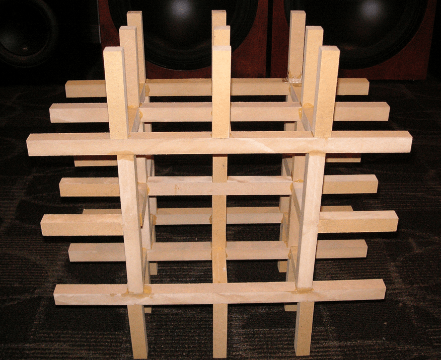

Some things I've been wondering about...

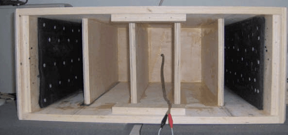

In the face of bracing and the ability to create virtually sonic inert enclosures with the approach cross bracing matrix like so;
Doesn't this open the door to use almost any plywood or particle board within reason?
1" braces every 6inches in a cross matrix is the standard per Bill Fitzmaurice allowing one to use 0.5" inch BB ply

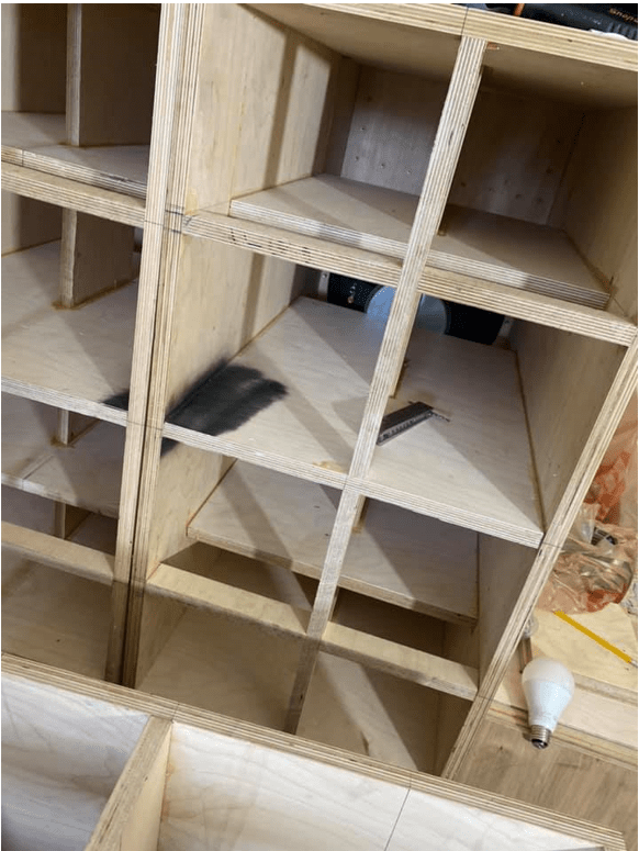

Another similar approach using whole panels, similar to the folds of a folded horn
I combined the theories of both of these approaches, specifically using the solid panels like above combined with ideas of spacing of the matrix approach.....
I think some said "overkill"....which to me is the goal until I know the lower limit BUT again, it would seem that the material used because much less important "sonically" in this realm of "overkill" bracing.
Maybe not?

I changed the spacing suggested by Bill F. for what was meant for 0.5", to 0.75", to scale exponentially. So 6" spacing became 9" spacing. Using full planks instead of singular crossbeams, supplies increased bracing, as well, should serve to Raise the modes of the internal dimensional based resonant notes, also theoretically beneficial to the cause.
Yes, if using the correct interlock and aspect ratio to meet the needs of the app, which many times in my smaller speaker builds was scrap corrugated cardboard and/or Styrofoam.
While I do believe strongly in internal bracing, I would estimate that 80% of the improvement comes with a single brace (in each of the three orthogonal directions, tied together at the center.) Adding more and more becomes superfluous at some point (probably very quickly.) I used 1" oak, but then changed to 1" poly.
Add damping to the braces and this increases it's effectiveness.
