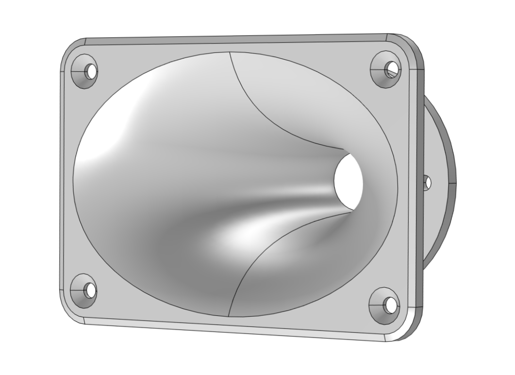

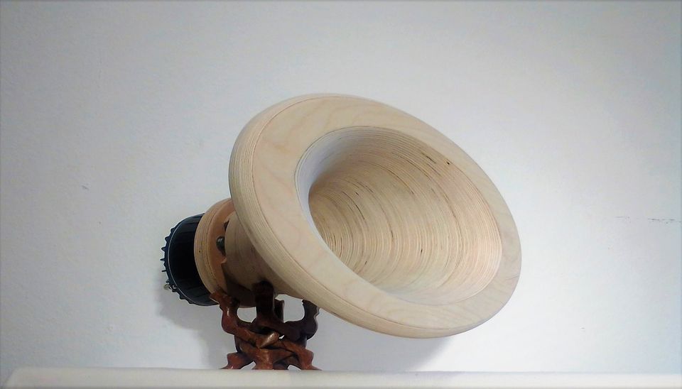

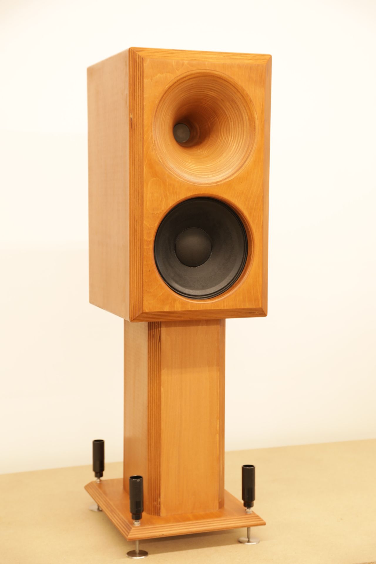

almost no flare in the vertical direction. And for the lower x-over even less.Vertical termination is clearly worse.
Some pics, also from K+T reviews, including a spherical horn:
LTH142?
