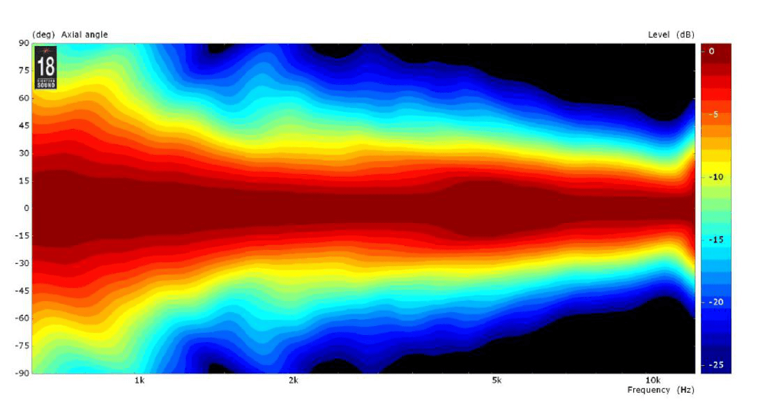

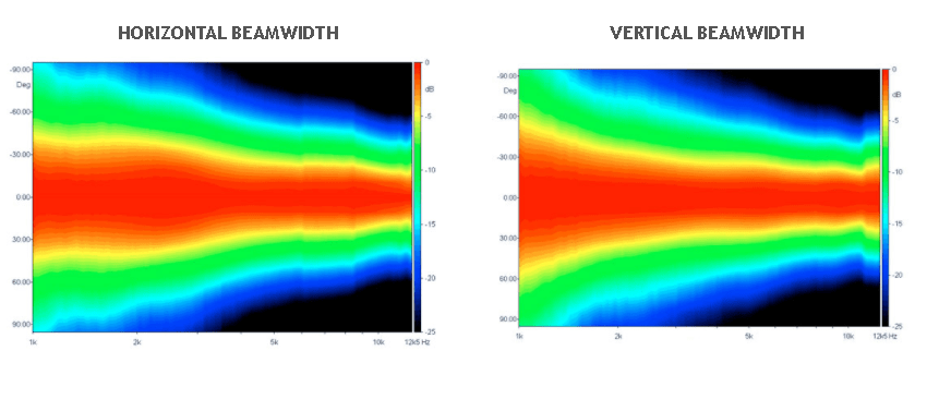

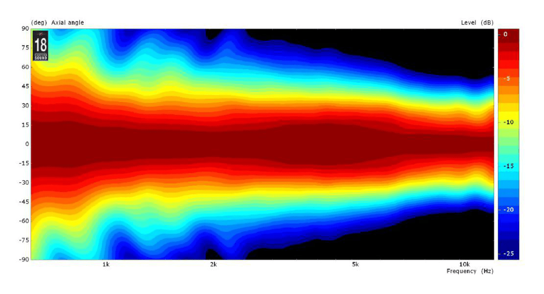

By the way, an exponential horn doesn't necessarily have to be synonymous with 'beaming'
Looks similar to the elliptical tractrix polars I can find...
Polars of the LTH142.
For anyone interested the explanation behind those images is hereBy the way, an exponential horn doesn't necessarily have to be synonymous with 'beaming'.
https://www.researchgate.net/publication/342159779_Hybrid_Constant_Directivity_Horn
Those of the XT1464 are similar.
Wrt loading vs directivity vs smoothness, both are still (among) the best commercially available horns.
