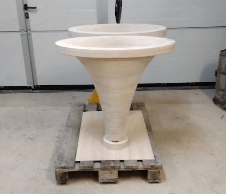

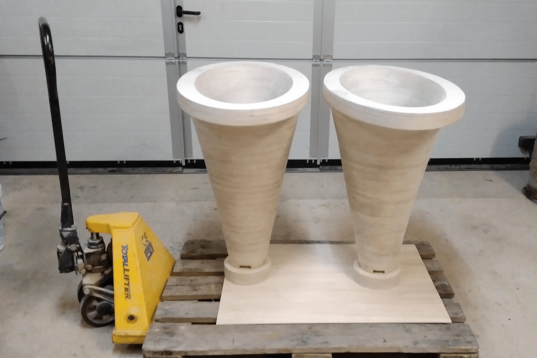

The wood horn that LMH is almost holding hostage at this point....has been an expensive endeavor but non the less, at least, a skillfully assembled, bad horn lol.... Something to serve as a functional reference point.... They tried to ship them in pieces at one point to try and keep the price point that they projected as shipped....which I turned down and told them to fully assemble. The cost of shipping....I'll eat that too.... Keep in mind that I was originally told that this would be done and shipped to me 2 months from November.... So at that time I was looking for speed and convenience...in hind sight I could of kept my money and built the horns myself in several different manufacturing approaches lol...call me lazy.
First excuse was that the horns ended up taking much more time than they envisioned....then it was due to lack of help in the shop....then it was Covid19......then it was trying to figure out who was going to ship.....then it was gluing the horns to completion...and now its Covid19....again....along with needing to build a shipping crate....Did I mention that they tried to guilt me into giving them more money several weeks after agreement/payment?
because I had talked him into a price that did not match the labor required...lol I told him he could just refund me... they didn't want to lol!
I am a hard sell on "inconveniences" I haven't called in sick in almost 10 years.... I've had covid19....I've been to work...several times, severely sick, on my own initiative, performing work more physically demanding than gluing and sanding...or whatever task they might have encountered building a horn... Frankly I don't believe them BUT in Germany they probably are used to like, taking care of their bodies and stuff, where as in America, sacrifice of self for career is glorified....and likely apart of our problems here lol!
I wonder if he was trying to hide in these pics...the complete lack of any type of roll off lol. I usually get critique from Docali, who probably cringes at the sight of these horns....which I eventually try out on the horn builders...who then try to downplay my understanding....from which at that point I am no longer interested in debating since theres no reason to...

They look they could be turned into urinals if their sound is disappointingI usually get critique from Docali, who probably cringes at the sight of these horns....which I eventually try out on the horn builders...who then try to downplay my understanding....from which at that point I am no longer interested in debating since theres no reason to...

No I just found the manufacturers positioning in the photo quite Freudianyou forgot that there is likely someone out there in Hifi land willing to take these off of my hands lol!

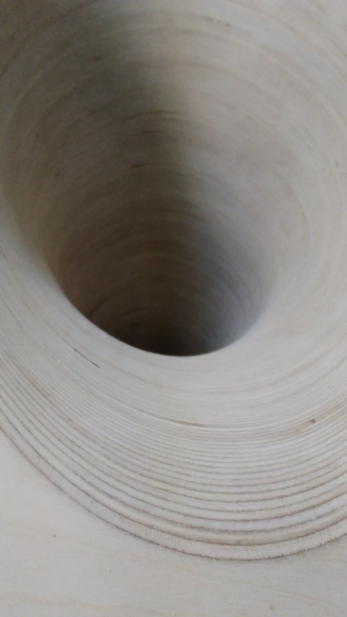

Looking into the abyss, there does indeed seem to be some kind of mouth termination.

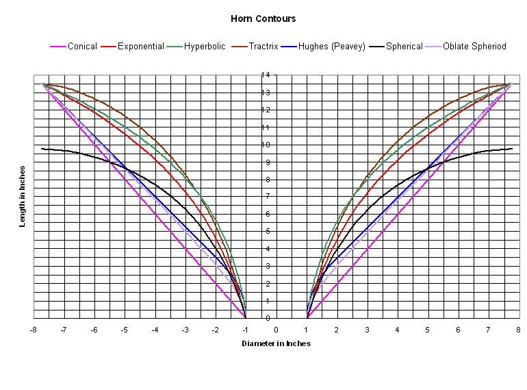

Also, Tractrix doesn't have the most narrow polar up top compare to exponential and spherical, if my memory serves me correctly, it has the widest of the other comparable beaming horns.....Faital offers a nelliptical tractrix horns Still...maybe the best of the old ways???

your memory served you wrong.@Ro808
do you also have such a detailed picture of the termination in the vertical direction?Looking into the abyss, there does indeed seem to be some kind of mouth termination.

which is which? Maybe it as that tractrix created more loading per realestate.your memory served you wrong.
looking at this I think maybe the above statement is it. tractrix reaches with a smaller mouth. True?
Vertical termination is clearly worse.
