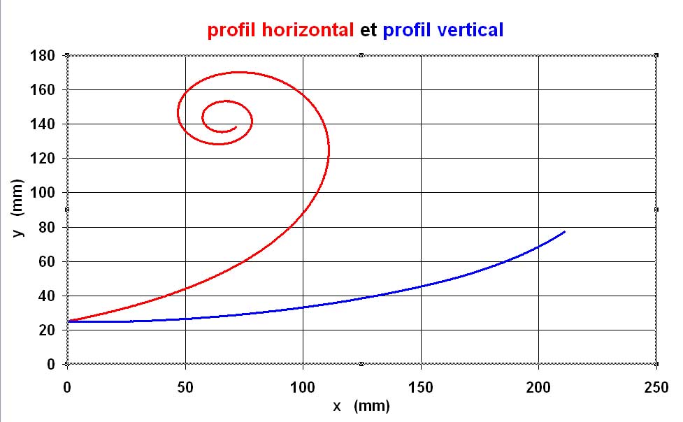

The other graph you show in your message:
http://www.diyaudio.com/forums/atta...an-michel-lecleach-horns-hrz-vrt-profiles.jpg
is an output of my Iwata spreadsheet. This is my attempt to the calculation of the classical Iwata horn you can see there:
http://i307.photobucket.com/albums/nn281/AudioVoice/Iwata_3.jpg
http://i307.photobucket.com/albums/nn281/AudioVoice/AvDAO.jpg

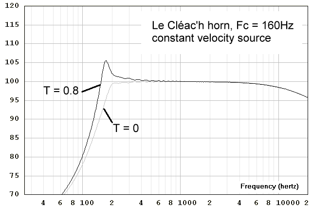

It does seem the hyperbolic loading can be tuned to provide a fairly flat acoustic impedance.
I am quite interested in seeing more information on Mige0's "Minphase" horn, CSD and polar plots in small increments up to 45 deg. However, these do not seem to be available.
Hello Soongsc,
For bass horns and for horns having to reproduce a very interval of frequency I always recommanded T = 0.
I doubt I have been followed though as the axial length of the horn is enlarged.
But users of Hornresp can simulate a Le Cléac'h horn having T = 0 and compare with T = 1 (e.g.).
Here attached the compared simulated response of T =0.0 and 0.8 Le Cléac'h horns.
The only negative point I see with R = 0.0 is a rise of the group delay at the acoustical cut-off frequency (but for bass horn having Fc < 50Hz this is not audible).
Best regards from Paris, France
Jean-Michel Le Cléac'h
