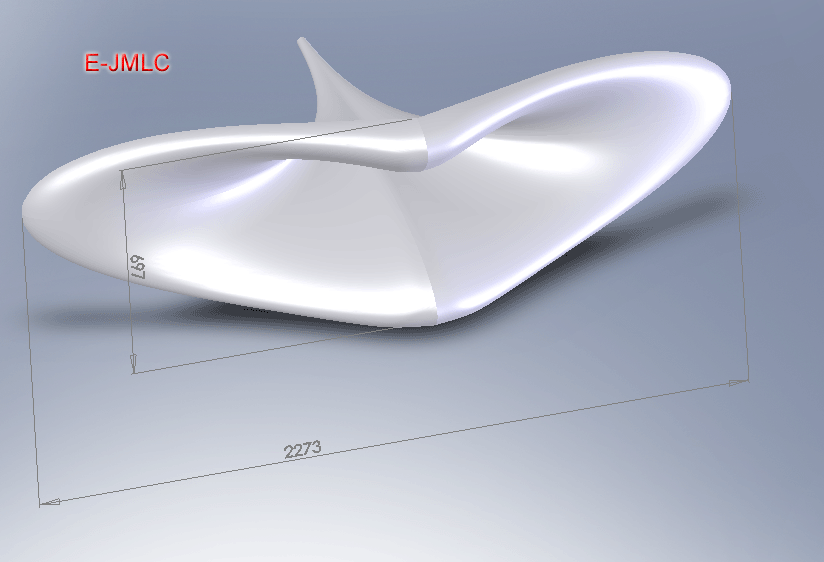

Above is 150Hz. Elliptical-JMLC horns of Fc larger than 355Hz will have a width smaller than 90cm. Ferguson type is for cone loudspeakers. Iwata was built in the past, measurements exist.
I'm interested in E-JMLC horns, but how to find enpugh people interested in the project to decrease mould fees and horn made at the end?
Also, elliptical take much place than IWATA-JMLC at same Fca ;
If a pair of 2" E-JMLC Fca=180Hz is available for someting like 300€ I'm in! as well for IWATA-JMLC.

Can we do elliptical horns? I think they will save a lot of space for purpose of shipping. I also think they look better than just a round horn.
To be honest, we never built the elliptical with my friend Jean-Michel;
As You see plan from Jazaga You can understand made needs special mould, only industry can provide at lowest cost.
It's like a Iwata idea, more large than high for larger dispersion and larger sweet spot;
Also,the main idea consist in waveforme propagation in the horn ,as Lecleac'h horn performs,with better impedance adaptation and principal without return waves in the horn to the diaphragm (sorry for my poor english);
