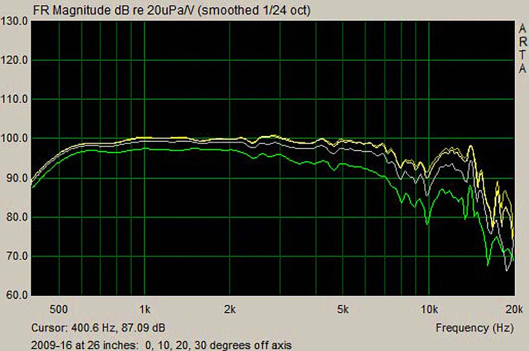

Here's one of Gary's measurements of the GPA 288 at 0, 10, 20, and 30 degrees off-axis. Since I've been planning on using a supertweeter coming in around 7~8 kHz anyway, the lack of extended HF is not of much concern.

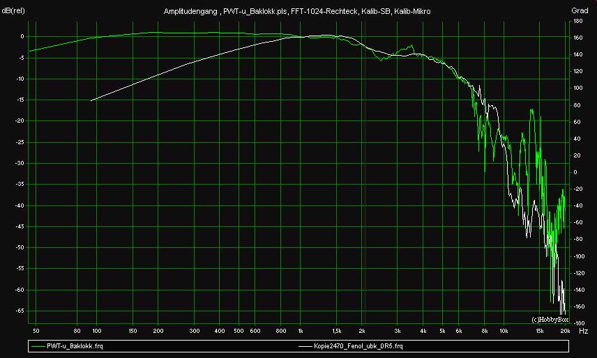

By way of comparison, here's a set of measurements Bjorn Kolbrek made a few years ago on his plane-wave tube. A vintage Altec 288B is shown in green, and a JBL 2470 is shown in white. The AH-425 isn't quite as smooth as the PWT, but it's getting there. It's certainly a different world than the Altec 511 and 811 sectoral horns.

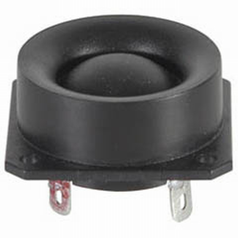

A small 3/4" neo tweeter like the excellent Dayton ND20 could be fun to play with for very little cash. It is possible that with the flange trimmed down and a model rocketry nose cone attached to the back, it might be miniscule and aero-dynamic enough to hang inside the horn mouth without creating many reflections, to form a coaxial.
Parts-Express.com
