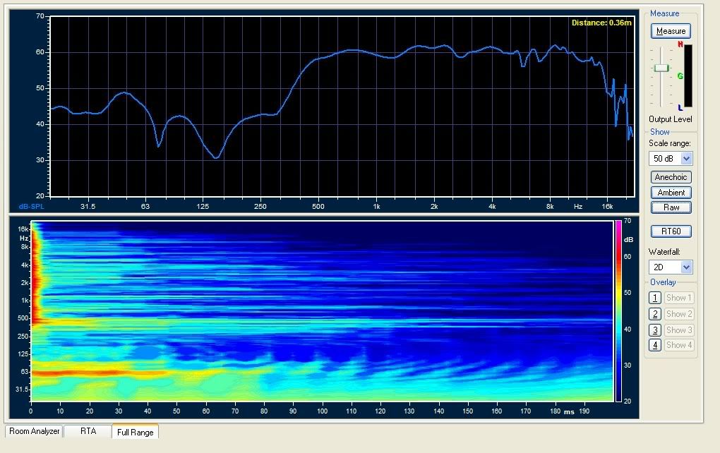

That's quite interesting, here is the measurement at 0.36 meter from the mouth of a rare Onken 455 mounted on Martin Seddon's AH425 horn:
http://i102.photobucket.com/albums/m83/jonjinkim/Onken bass cabs/Mid68F.jpg
Flat on axis as ever with the Le Cléac'h horn.
