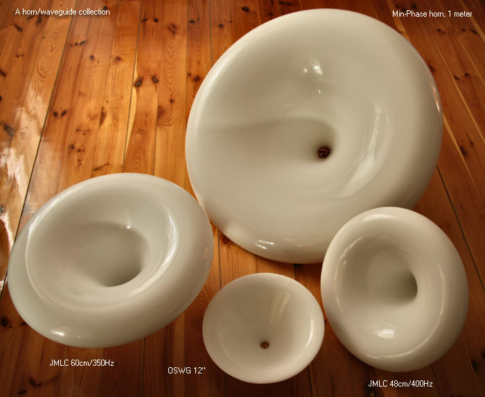

JMLC horns collection.
Beautiful background (the wooden floor !) - and foreground too, of course.
A picture of such peaceful harmony we seldom see on that forum - *if* you replace items by proponents
![up :up: :up:](https://files.diyaudio.com/forums/images/smilies/up.gif)
