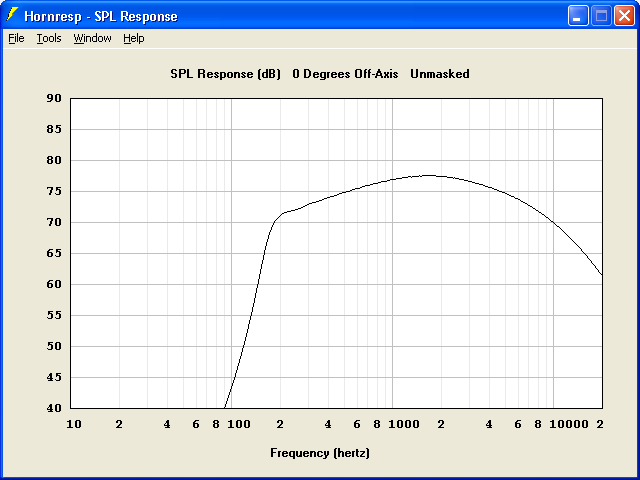

Hi Michael,
Interesting indeed, particularly when your "on-axis SPL at 4m distance" response is compared to the Hornresp far-field directivity response for the same system
AxiDriver:
200Hz = 71 dB
2000Hz = 77 db (+6 dB)
Hornresp:
200Hz = 71 dB
Kind regards,
David
Hello David and Michael,
For me, the picture is more clear now. We can see that Hornresp simulate quite accurately the axial response at a large distance from the mouth.
There still a small difference between the response simulated by Hornresp and by Axidriver in the high frequency part of the response (above 2kHz for the example shown) as the reponse predicted by Hornresp fall more quickly.
Then, when we compare to a true measurement, there still some difference with both predictions. I give in attached file a .wav file (saved as .txt) corresponding to an unprocessed pulse response I obtained at 1 meter precisely from the mouth of a Le Cléac'h horn having an Fc of 320Hz mounted on a TAD TD2001 compression driver.
Then we can analyze this measured pulse response. Compared to the simulated response, the measured response is flatter for sure. This indicate that my equivalent model for the TD2001, have to be refined. It was obtained at a time when Hornresp did'nt had the directivity tools and only the power response was available.
Now that we know that the axial response in Hornresp seems (is) accurate, few parameters of the equivalent model should be revised to obtain a better modelisation of the driver to accord to the measurements.
