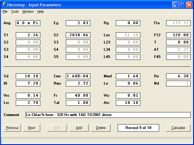

Attached are details of the input parameter values I am using in Hornresp for the 320Hz Le Cléac'h horn and TAD TD2001 driver, together with a comparison of the .txt file measured impedance versus Hornresp prediction.
Kind regards,
David

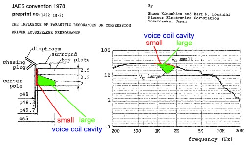

Hello Michael,
The impedance curve of most compression drivers often shows several impedance peaks.
As an example give a look to the impedance curve of the JBL2445 compression driver mouted on the biradial horn reference 2380:
http://www.jblpro.com/pub/components/2445J.pdf
For the TD2001 the bump in the impedance curve around 1900Hz is related to a cavity resonance as explained in Kinoshita's paper about the design of the TD2001 driver.
JAES convention 1978
preprint N°1422 (M2)
The influence of parasitic resonances on compression driver loudspeaker performance.
By Shogo Kinoshita and Bart Locanthi...
You'll find in attached file a graph explaining the origin of that resonance.
Best regards from Paris, France
Jean-Michel Le Cléac'h

ALL compression drivers exhibite two peaks on any horn including a plane wave tube. It is not due to a "cavity resonance" (if it were then some drivers would have it and some wouldn't) but it is in fact due to the air compliance between the diaphragm and the phase plug. If you draw out the lumped paranmeter circuit you will see that a compression driver has the exact same topology as a single bandpass loudspeaker enclosure, which also has two peaks in its impedance curve. SPEAK will show this very clearly.

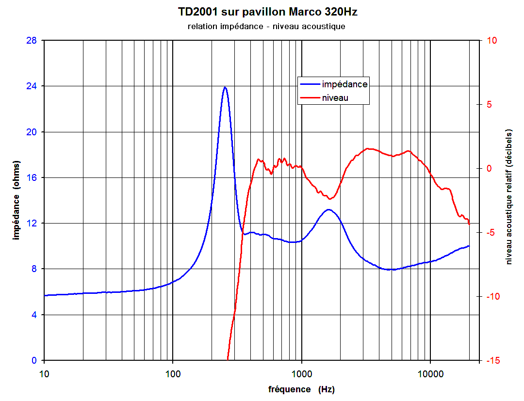

What you wrote about the resonance in the small volume between the diaphragm and the phase plug is true and is probably responsible of impedance anomalies at higher frequency. IMHO such effects can be taken in account by hornresp (and others as Akabak).
Many compression drivers measured on plane wave tube show more than 2 peaks on the impedance curves (because other sources of resonances may exist in compression drivers other than the 2 mentionned by you and Kinoshita)
But the cavity effect mentionned by Kinoshita for the TD2001 according to his paper is not questionable and is also at the origin of the hole at 1900Hz for which the TD2001 is famous for.
In attached file the correlation between the impedance curve and the frequency response curve of a TD2001 (voltage driven) mounted on a Le Cléac'h horn. Every feature in the impedance curve possess its "inverse" on the frequency response curve... this is most probably not a random effect.

I never said that the cavity resonance does not exist in that driver, it does, and in many others as well. I said that it was NOT the reason for the second peak, which is what you stated and was incorrect. The cavity resonance will only be a very small perturbation on the voice coil impedance because it does not have a strong effect on the voice coils motion even though it can have a large acoustic effect.

I am curious, then what is the cause? Measurements on these types of drivers have been done in vacume chambers, and the higher frequency hump disappears.
