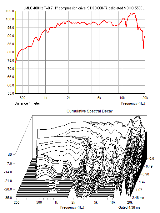

It was my mistake. By accidence I fed a right mode with 25mm throat and get nice smooth response. With a proper feeding we we could manage modal traducer I'm pretty sure.
From this time my measurements are calibrated. Measured the same horn with STX D800-Ti. It's nice that JMLC is linear on axis and does not require any eq.

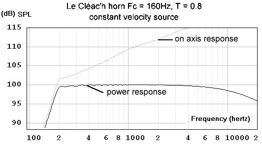

Hello Michael,
Even with a theorical constant velocity source, simulations done using such software like Hornresp give for the Le Cléac'h horn a very flat power response (called "constant directivity response" in Hornresp).
In such case it is obvious that due to the increasing directivity of the horn, the axis response is rising with frequency and this is clearly seen on the O° response curve given by Hornresp. (Give a look to the attached graph for the compared power response and on axis response curves predicted by Hornresp for a Le Cléac'h horn having a Fc of 160Hz and a T of 0.8.)
BEM simulations lead to the same.
I used to talk about that with David Mc Bean and eventually I asked him to try a constant acceleration source (but the correction was too large).
As you can see the on axis response possess a +3dB/octave ( = 10dB / decade) slope and I was asking myself if a linear dependance on f (frequency) was forgotten...

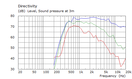

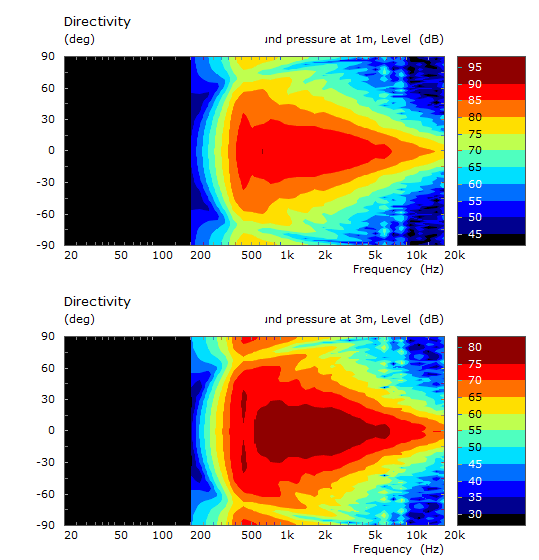

Depends – I played around with AxiDriver BEM software and gave it a try with your TAD 2001 data :
http://www.audioasylum.com/forums/hug/messages/12/128658.html
on the LeCleach 0.8 / 160Hz horn
Horn contour and sound field:
On-axis response at 1cm to compare to measurements done at the same distance:

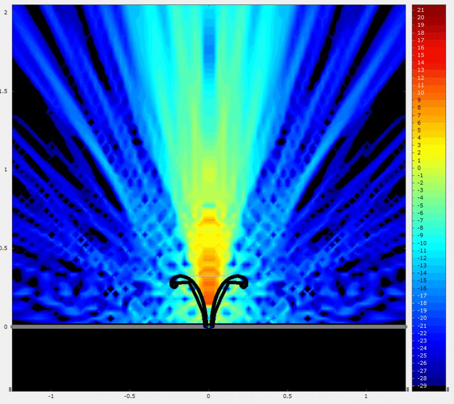

Helo Jzagaja,
Why your BEM simulation of the Le Cléac'h horn is so rough?
Bjorn Kolbrek used to perform a lot of long duration BEM simulations and the maps he obtained are so smooth when yours are so bad!
Mige0 seem to obtain smooth simulations too...

AxiDriver is not bad.
Do you mean middle map? I should explain it was for 20kHz frequency where BEM has some difficulties. For any lower it is smooth. With a proper motor parameters axial response becomes more linear.

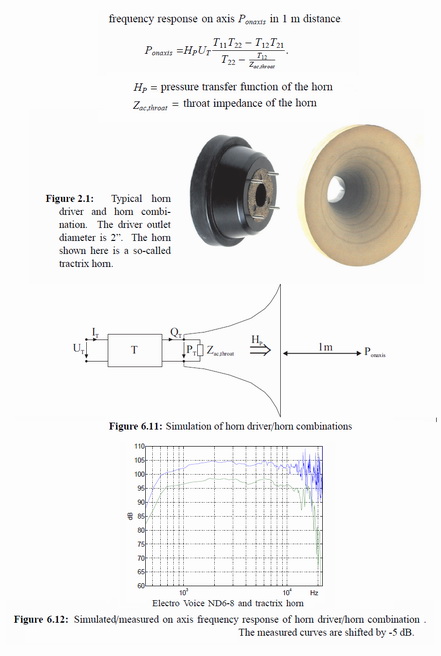

Hello Jzagaja,
OK this simualtion is done at 20kHz, I understand now why the map looks bad...
I used to ask David McBean about the questionable on axis response prediction for a Le Cléac'h horn obtained under Hornresp using both my model of the TD2001 or the constant velocity model .
See my message:
http://www.diyaudio.com/forums/subwoofers/119854-hornresp-65.html#post1862698
His reply is here:
http://www.diyaudio.com/forums/subwoofers/119854-hornresp-66.html#post1863488
Here is the comparison between a simulated (by another method) and a measured on axis response for a tractrix horn (from Michael Makarski's thesis, 20 april 2006) . It is pretty acurate.
