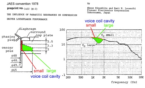

I gave a look twice at the schematics of a part of the compression driver as given in Kinoshita's paper:
http://www.diyaudio.com/forums/atta...2322-jean-michel-lecleach-horns-kinoshita.jpg
What we can see is that the larger voice coil cavity is coupled to
1) the (compression) volume between the dipahragm and the phase plug,
2) a volume on the front of the suround (suspension).
The peak around 1900 is surely related to that coupling.

Hello Michael,
Your simulation demonstrate clearly the low pass filtering due to the compression chamber. Such bandwith / efficiency relation clearly shown in you simulations done at different comrpession chamber volume is (was) commonly used in designing bass horn enclosure (as Klipshorn, ...) .
I attached a figure I modified from Kinoshita. All cavities between diaphragm and throat of the attached horn (not pictured) have been coloured.
The large voice coil cavity is in yellow, the air between the diaphragm and the phase plug is in blue (the air in the slits of the phase plug is also in blue) the air in the coil gap is in purple and the air in the volume between the surround suspension and the body of the driver is in green.
Surely there is similarity with you studied model. The simulation you have done with a lateral cavity linked to the compression champer by a thin duct (this is equivalent to an annular Helmhotz resonator) is of the same kind that the one described by Kinoshita (but the Q of the hole in the frequency response is very different). The important thing is that an optimisation can be done in order to reach a more flat response.
This what Kinoshita wrote:
The main resonances are those due to cavities under the surround and around the voice coil and of the surround itself and the dome. By suppressing or utilizing these resonances, a compression driver having a flat energy response over a wide frequency range is obtainable.
Best regards from Paris, France
Jean-Michel Le Cléac'h

The tradeoff of using resonances to obtain banwidth is sound coloration which is visible in the CSD. These techniques are similar whether applied to extend high end or low end of the spectrum. If the extention can be obtained with a very well distributed CSD spectrum, then it will be quite pleasing most of the time.
Hello Soongsc,
What you said is true and I prefer myself to avoid such method.
But in the case it is unavoidable better to have a low Q resonance than a high Q.
Also we have to take in account that it is somewhat possible to compensate a resonance mechanism at the front of the diaphragm by another one at the rear.
An example of such method is called "reactance cancelation" of a horn by a proper choice and calculation of the rear load of the loudspeaker.

..I attached a figure I modified from Kinoshita. All cavities between diaphragm and throat of the attached horn (not pictured) have been coloured.
Pretty complex interactions at a closer look with such compression driver's – eh?
