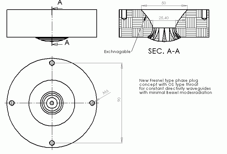

What about interchangeable phase plug idea? I'm planning produce such based on STX D-800-Ti driver. Here's a simplified 3 parts sketch of concentrator with Fresnel phase plug (circular) and OS type throat that could be replaced with conical or cylindrical. Simulations shows merging OS with JMLC mouth to be a good idea.
IMO the exit angle as well as the phase plug itself already must be seen as part of the horn contour – this is a simple requirement of the diffraction alignment concept.
Comparing an AMT and a compression driver in this respect - it immediately gets obvious, that the part between compression driver diaphragm and phase plug is equivalent to the pleating of the AMT diaphragm
The phase plug of a compression driver does nothing else than bridging the radial distance of that "compression driver pleats" towards a single opening – luckily, such a phase plug is not needed for an AMT on horn.
just my 2ct

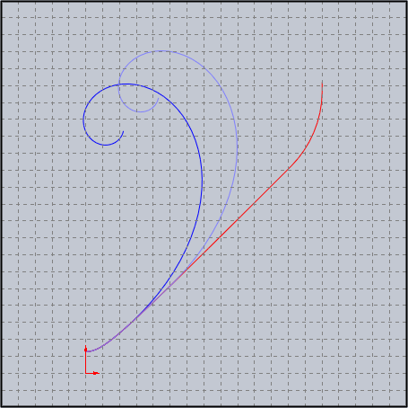

You can see from the wide variation of exit angles why mixing-n-matching horns and drivers gives unpredictable results. It's bad enough when the driver and horn are significantly different - reflections right where you don't want them - and worst of all when the driver has a wide exit angle going into a narrower-profile horn.
This kind of pinching-down makes big problems with reflections in the time domain, screws up diaphragm loading at certain frequencies, and causes ripples in the frequency response. All of the design work on the phase plug to create a plane wavefront is wasted when the first thing it sees is a massive reflection before it even gets into the horn. Don't forget that simple misalignment (off-center or a non-circular entrance to the horn) creates many of the same problems.
The most recent LeCleac'h spreadsheet has the option to enter the value of the exit angle of the driver, but you're out of luck with the old-school horns - the exit angle might not have even have been a design consideration. I don't know about OS, quadratic throat, and conical horns - there should be a parameter where this can be entered in and allowed for.

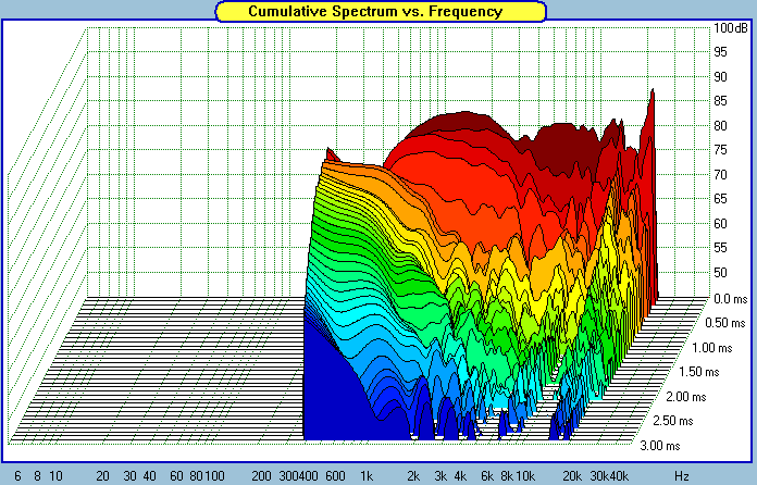

Poor measurements of the 425
Why do these CSD of the 425/ Altec look so dirty?
Azura 425hz horn (drivervault)
Is it the driver? The measurement location? I would be very disappointed to spend so much on a horn to end up with hashy curves like that.

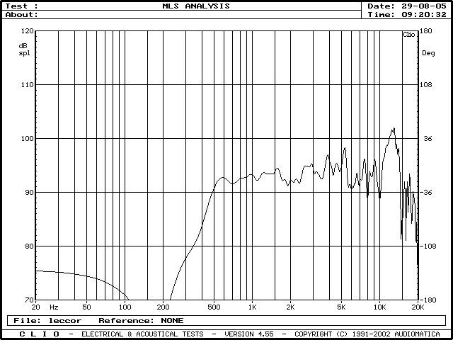

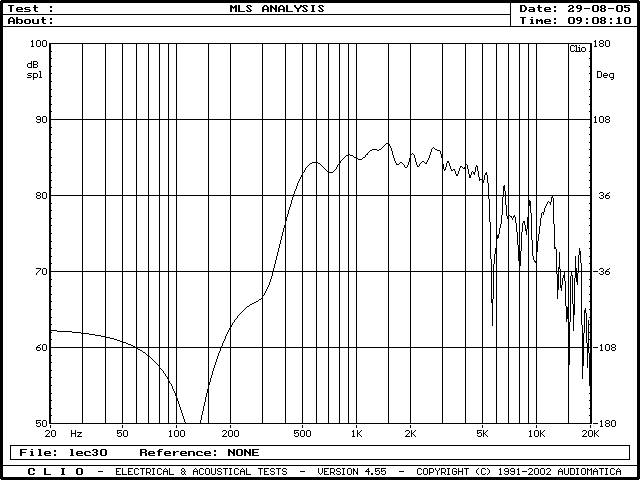

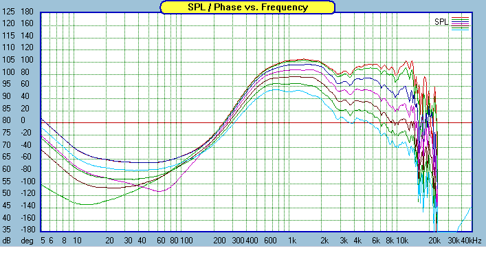

Hello Sendler,
As you can see by the frequency response curves taken at different angles from axis, there is a very smooth variation of the shape of one curve to the other.
The main point is that there is NO off axis attenuation of the little peaks and holes in the curve (if the horn reduces by 20dB the mean level around a given frequency off axis you should have also some decreasing of the amplitude of the artifacts). So we can interpret this, as the artifcats are due to the driver itself.
Imagine you linearize the on axis curve, then you'll obtain very smooth off axis responses and this is because the Le Cléac'h horn itself has very little reflections (from mouth to throat or other sources of reflections). Many on axis response curves of different Le Cléac'h horns have been published and most of them are the smoothest you can find.

Yes indeed. I was speaking with a friend of Lynn's just the other day and he told me the same thing. Probably from the same set of tests. Looks like there is a problem to be fixed.
I don't know what your listening impression is, but there will be some harsh sound caused by the what probably is the diaphragm breakup mode righ before high end roll off.Why do these CSD of the 425/ Altec look so dirty?

My friend Gary Dahl has completed a series of tests on the AH-425 Azurahorn and 3 different GPA 288's and two different Radian 745P's. They were measured at 24" from the horn mouth, which might account for the noticeable variations from Augerpro's measurements.
I need to ask Gary's permission before posting them in this forum, but I can tell you they are very flat - in fact, they look like plane-wave tube measurements, instead of a horn. Based on what I've seen, there is no need for notch or shelf filtering with the audio band, which should greatly simplify the crossover.
There is no on-axis hole, and the family of off-axis responses are all tightly correlated with the on-axis measurement. In terms of dispersion, the 16.5" Le Cleac'h horn resembles an idealized 4" direct radiator, with no sharp cutoff at the edge of the nominal 90-degree beam, and no discontinuities within the beam. As mentioned in other forums, this is not a "constant-directivity" horn in the usually accepted meaning of the term, but it does have very smooth dispersion characteristics, with a "soft" edge, unlike SR or movie-theater horns.
The agreement between Bjorn Kolbrek's BEM simulations (which were used to design the AH-425) and the measurements of the physical driver and horn are as close as I've seen for any horn system. I'm very pleased with the way the AH-425 project has turned out, and would like to thank Jean-Michel Le Cléac'h, Bjorn Kolbrek, Martin Seddon, and Gary Dahl for all of their insight, proposals, designs, and hard work.

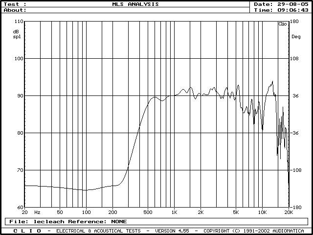

Here are measurements of 288 in lecleach horn; on axis at 1m no smoothing, with (passive) equalization, with eq at 30-degree.

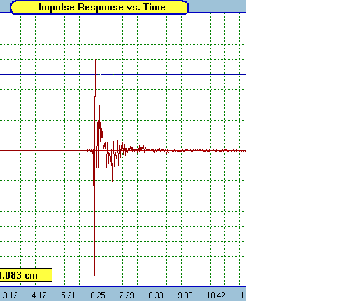

Here is something to give you a quick idea of what we have seen so far -- one of Lynn's Radian 745PB-8 drivers on an Azurahorn AH-425. The response of both of his drivers look very closely matched, with most of the wrinkles in the same spots except above 10 kHz. I ran curves using both MLS and swept sine signals, and saw very little difference.
My expertise is music, not measurement science. I have been learning what I can as a hobbyist, and have been fascinated by the capabilities of ARTA but have much to learn about its proper use.
