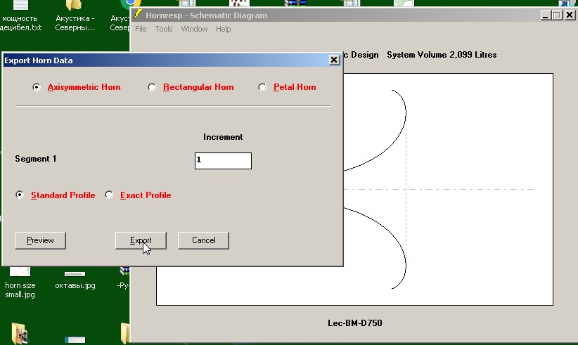

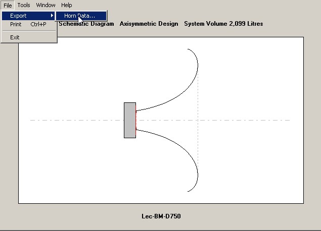

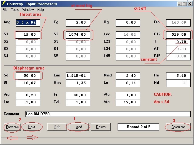

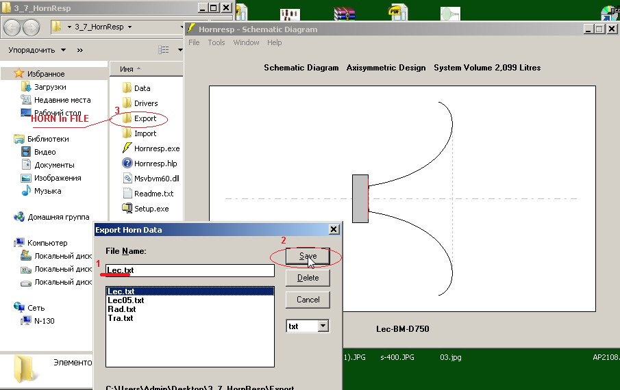

Получить чертёж с помощью HornResp,это легко!
I have found the spreadsheet. But it has Old_calculation and New_calculation
The trick is that the new_calculation is dated 2007 and the old one -2009

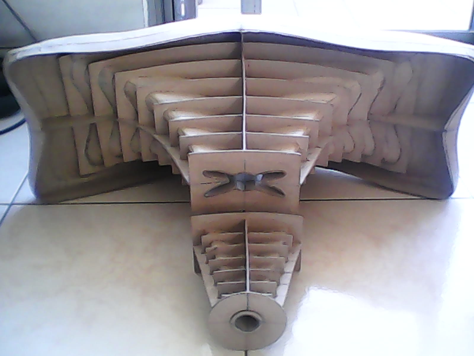

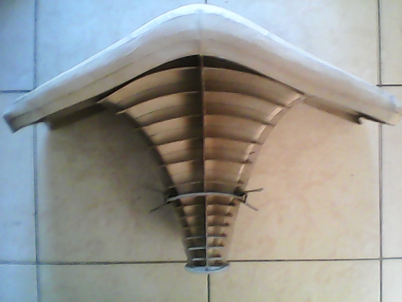

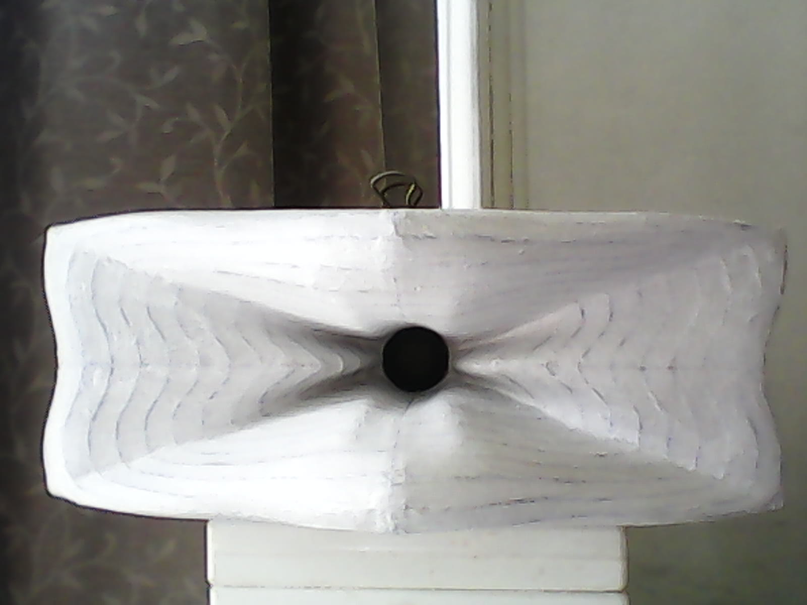

Here are the pictures.
Does anybody know where is the new one or the right one?
Get the drawing by means of HornResp,this easy!

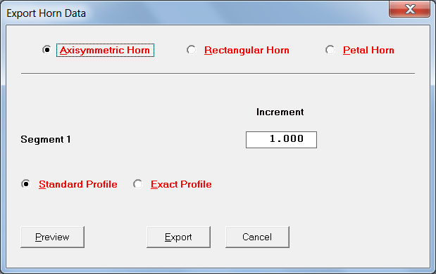

For axisymmetric Le Cléac'h horns, the Hornresp 'Standard Profile' option gives a result identical to the 'New Calculation' spreadsheets included in Jean-Michel's 2007 and 2009 Excel workbooks. There is no difference in the New Calculation results produced by the 2007 and 2009 spreadsheets, and while they provide a reasonably close approximation to the theoretically perfect profile, they are not an exact match.
The Hornresp 'Exact Profile' option exactly matches the theoretical ideal for an axisymmetric Le Cléac'h horn, and is therefore the suggested one to use.
See the following post for further background information.
http://www.diyaudio.com/forums/multi-way/140190-jean-michel-lecleach-horns-114.html#post2619419

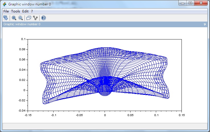

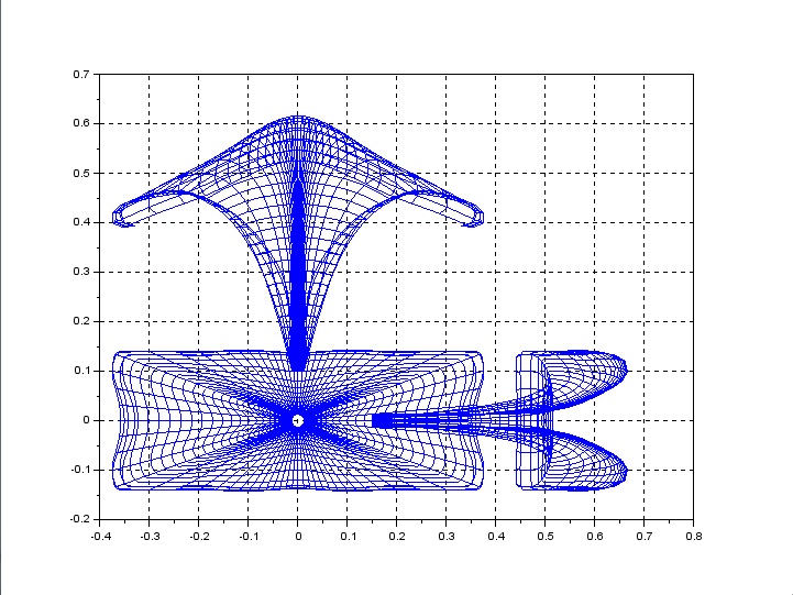

A new 1kHz tweeter horn. Horn expansion follows JMLC method,
The inner shape is similar to JBL 4367 waveguide.
more information :
HIFIDIY??-??????? - Powered by Discuz!=

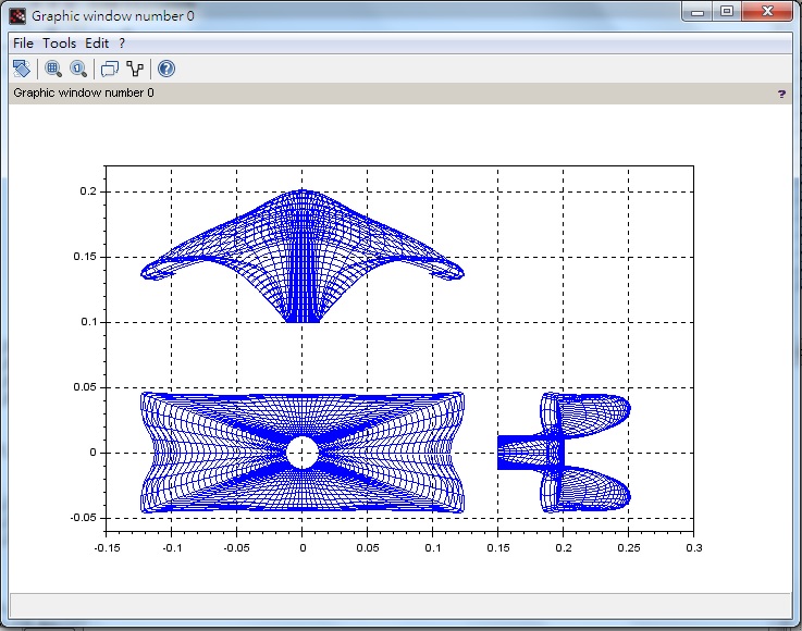

My new mid horn (1inch 320Hz), be calculated and built by the same method of my tweeter horn. In a rough listening comparison, it is more better than my old one at frequency extension.
Partisional expansion at throat section might be the major cause. This type cross-section has fewer higher_order_modes than simple circle or square with same area. In horn duct, tranverse wave propogation induce higher_order_modes. Like any resonance, higher_order_modes needs time to establish and decay. I think, heavier higher_order_modes not only affects horn directivity, but also dtsturbs sound phase.
Horn mesh data and building method in
[FONT=Times New Roman, serif]My new mid horn (1inch 320Hz), [FONT=Times New Roman, serif]be calculated and built by the same method of my tweeter horn. [FONT=Times New Roman, serif]In a rough listening comparison, it is more better than my old one at frequency extension.[/FONT][/FONT][/FONT]
[FONT=Times New Roman, serif]Partisional expansion at throat section might be the major cause. [FONT=Times New Roman, serif]This type cross-section has fewer higher_order_modes than simple circle or square with same area. [FONT=Times New Roman, serif]In horn duct, tranverse wave propogation induce higher_order_modes. Like any resonance, higher_order_modes needs time to establish and decay. I think, heavier higher_order_modes not only affects horn directivity, but also dtsturbs sound phase.[/FONT][/FONT][/FONT]
[FONT=Times New Roman, serif]Horn mesh data and building method in[/FONT]
[FONT=Times New Roman, serif]http://bbs.hifidiy.net/thread-825216-8-2.html[/FONT]
Nice
Could you make a quick summary of the building method & materials in english, here ?
BR
Jean-Louis
