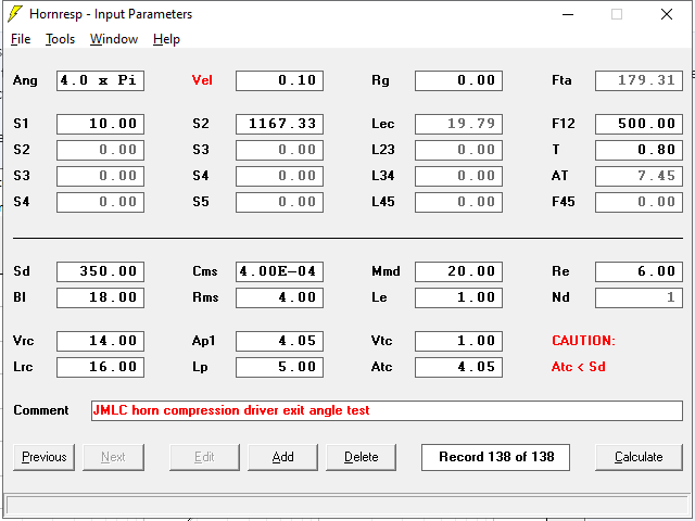

I'm using a version of the spreadsheet that was shared some years ago in this thread. I noticed that the comression driver exit angle can be specified and it does influence the profile calculations, however it doesn't result in the throat of the horn matching the exit angle. It seems to match the CD exit angle requires iterating the T coefficient and perhaps Fc. How is the exit angle in the spreadsheet taken into account exactly?

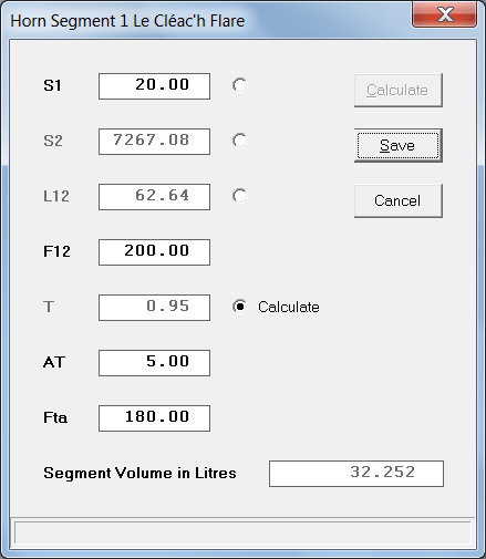

Given the desired throat cross-sectional area S1, throat entry half-angle AT, flare cutoff frequency F12 and mouth flare tangent angle Fta, the Hornresp Horn Segment Wizard can specify the resulting Le Cléac'h horn, as shown in Attachment 1.

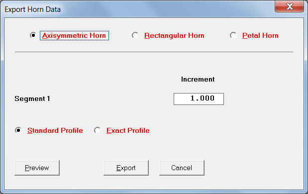

Axisymmetric, rectangular or petal horn construction dimensions can then be exported, as shown in Attachment 2.

IIRC, the angle is only used to calculate the initial starting wave front area.
Directivity-wise, the matching of angles doesn't do much, but as the difference between the exit angle and horn increases, there will be an increasing amount of reflection at the interface. This will cause some response ripples.

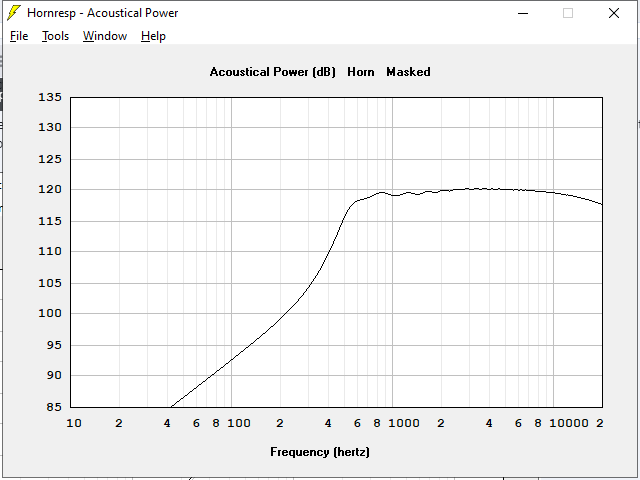

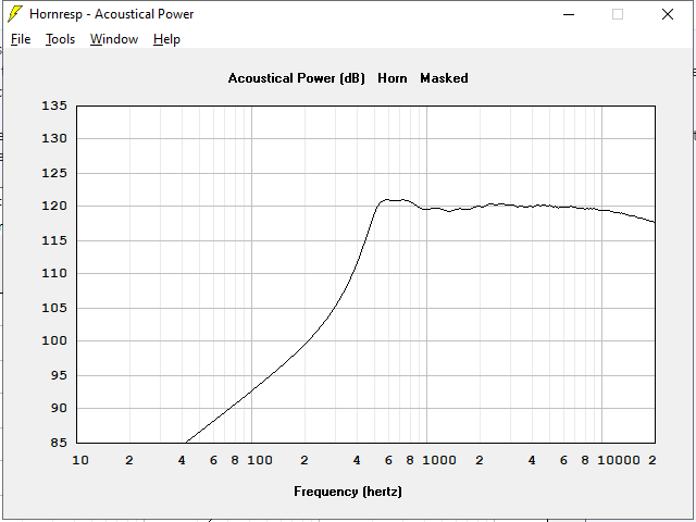

In the attached example, the first plot shows a horn with a 5cm throat adapter, having the same angle as the horn throat. The next plot shows the effect of a 8cm long adapter, which has a different angle. The most obvious effect is the bump near cutoff (due to the added length with a lower expansion rate), but you can also see the response is more uneven at high frequencies. That is due to the reflections at the interface between the adapter and the horn.
Constant throat velocity was used to remove the effect of driver parameters.

I would simply use the Horn Segment Wizard calculation option setting that I showed in the first attachment of Post #1812 and make the entry angle of the horn the same as the exit angle of the compression driver, checking that for the desired horn flare cutoff frequency the calculated value of T is no greater than 1. (For a fixed S1 and AT the value of T can be lowered if necessary by increasing F12).

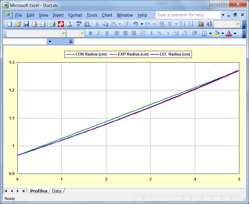

You could check this by comparing the profile of a short (say 5cm) 300Hz exponential segment with a 1" exit diameter to the equivalent (T=1) Le Cléac'h horn.
Assuming that the compression driver duct has the following dimensions:
S1 = 2.93 cm^2
S2 = 5.07 cm^2
L12 = 5.00 cm
If L12 = Exp then:
F12 = 300.21 Hz
Fta = 3.98 deg
If L12 = Con then:
Fta = 3.49 deg
If L12 = Lec and T = 1 then:
F12 = 302.00 Hz
Fta = 4.02 deg
The three profiles are compared in the attachment.
