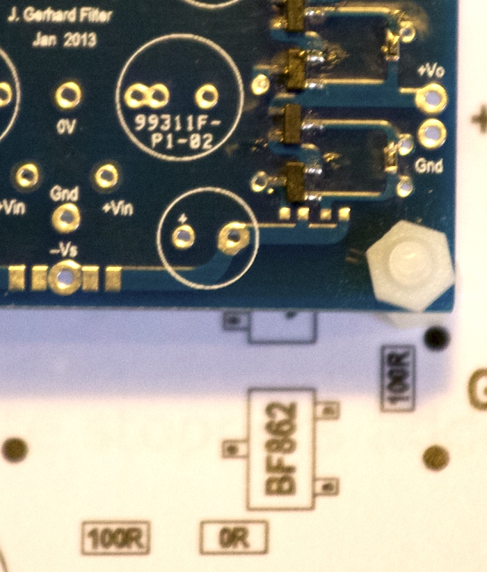

I have been asked again by PM about documents for component placement.
As I said in post #423, all the information you need has already been published in the thread.
All you need to do is to help youself and make use of the excellent "search this thread" function of the forum.
And you will get this straight away :
http://www.diyaudio.com/forums/grou...rhard-filter-buffer-es9022-7.html#post3288434
Patrick
