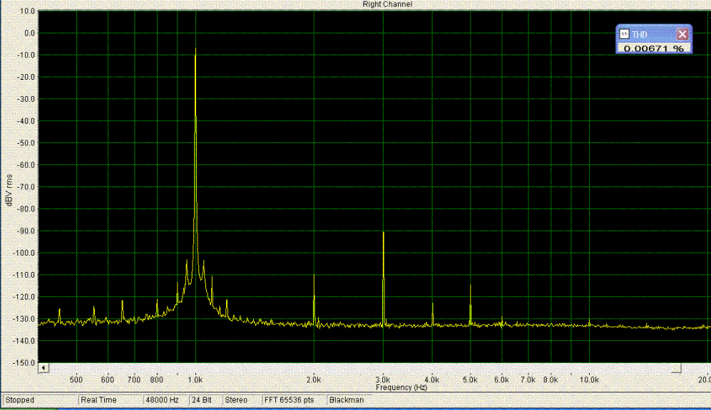

John,
I know your preferences and design philosophy. I wonder if you would allow me to post 2 recent measurements done on an amp with symmetrical CFB output stage biased at 1.5A, out of global NFB. The amp is rated at 33W/8 ohm and 60W/4 ohm, similar as JC3 discussed now. The 1st image is for 8W/8 ohm:
