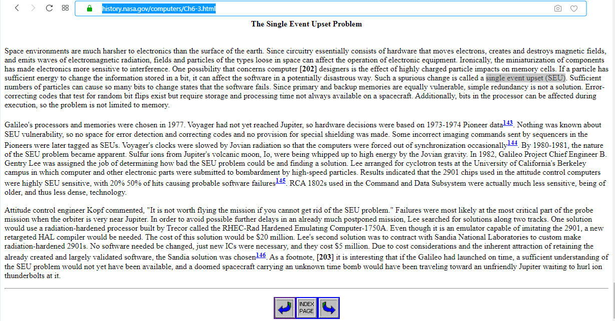

Memory failures. I had mysterious crashes with no names. Thanks to Memtest that does test seriously. No cosmic ray found but a couple of bits revealed unreliable over hours of testing. A good test is much more than writing a checkerboard pattern and read back. See the documentation of Memtest. With serious DRAM brands: No problem, no more mysterious system crash, corrupted registery.
I remember reading about the substrate ceramic emitting alpha IIRC and tossing bits.
We have cosmic ray concerns with the big semi switches, occasionally causing false triggers on the 100 mm scr's.
For the liquid argon WIMP detectors, they were obnoxiously worried about the source of the copper and ceramics, as any decays could cause a false detection. I had never realized that where they got the ore from was so important.

We had chips on Veeger and it was a concern at the time. This was of course before the Quantum Slipstream Drive was invented.We have cosmic ray concerns with the big semi switches, occasionally causing false triggers on the 100 mm scr's.

That sounds like this story - I first read about it in some trade journal in the 1980s or so.I remember reading about the substrate ceramic emitting alpha IIRC and tossing bits.
http://www.pld.ttu.ee/IAF0030/curtis.pdf1978-Discovery of soft errors from alpha-particles In 1978, the first evidence of sea-level soft fails from energetic particle impact was given in a famous paper by May and Woods of Intel [8]. This paper resulted from a serious industrial problem at Intel concerning operational errors in their 2107 series 16Kb DRAMS. It was discovered that the problem was trace radioactivity in the memory packaging materials. The May and Woods paper was submitted to a device reliability conference. Although the paper was presented in June 1978 and was not published until early 1979, the preprint was rapidly circulated throughout the industry, and within two months articles were appearing in trade newspapers. Since the May and Woods event was so important, their company continued backtracking to identify the cause of the problem. The source of the contamination proved to be quite instructive. Because of the dramatic increase in demand for LSI ceramic packaging in the 1970s, a new factory had been built on the Green River in Colorado. Unfortunately, it was built just downstream from the tailings of an old uranium mine. The water used by the factory proved to have high levels of radioactive elements, which contaminated the ceramic LSI package^.^ IBM had begun to have evidence of its own soft-fail problems, and with the circulation of the paper by May and Woods, the first IBM task force on soft fails was created in mid-1978. It found that alpha-particles were indeed one source of an IBM reliability problem, and this group initiated the first modeling and screening efforts on the effects of radiation on IBM chips.

Scott I remember you long ago talking about radiation hardened processes in IC fabrication. The industry was apparently not aware of BB (C) and Goop (C)
