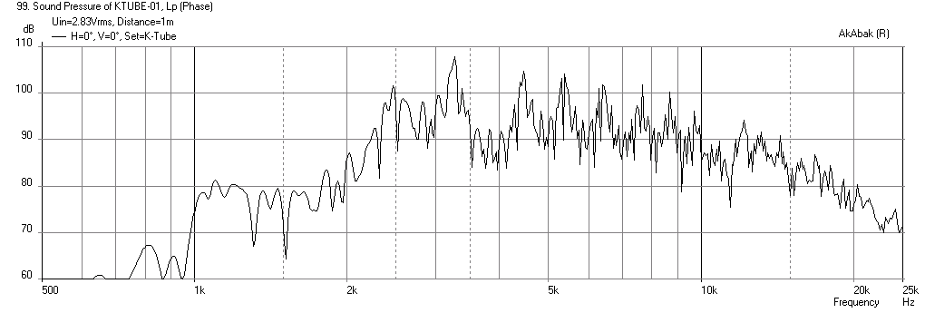

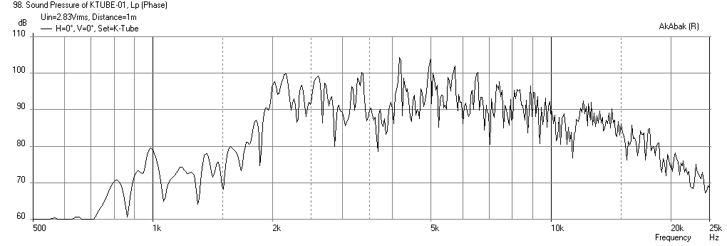

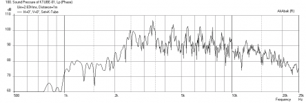

K-Tube Model
I am trying to model the K-tube tweeter in AkAbak. I am using a rectangular cross section rather than round and I have the CSA tapering to about 25% of the initial value over the length of the Karlson aperture which ranges from 3 to 5 inches long. The Karlson aperture is approximated with 14 segments. The width of the tube varies from 1.25 in to 1.0 in. The compression driver is a generic one that was provided as an example in AkAbak capable of producing about 105 dB in a 53 cm wide x 47 cm deep exponential radial horn. I am getting a rather ragged looking frequency response - not sure if I am doing this right but the efficiency is only in the 90 dB and falls off to about 80 dB at 20 kHz. Let me know if I am on the right track or this is all wrong looking.
Thanks,
X

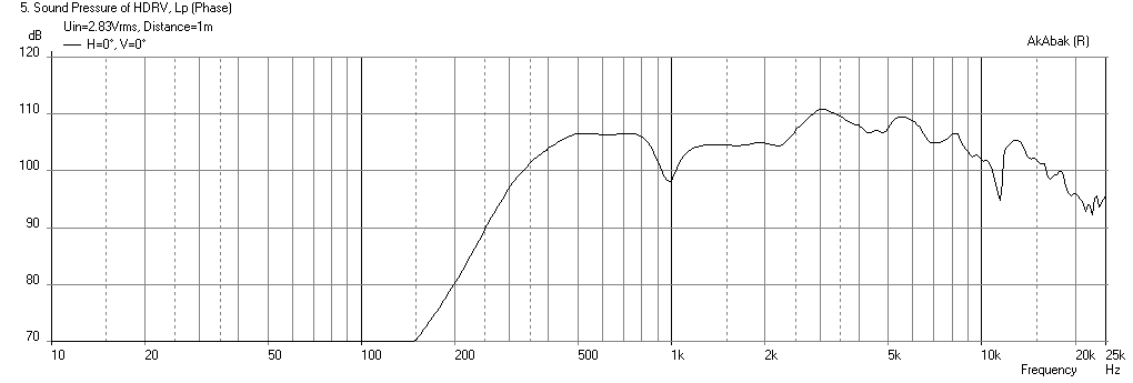

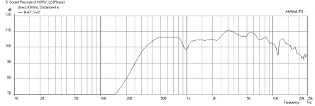

This is the output of the CD with the radial horn as a baseline
This is a 5 in long x 1.25 in square K-tube (2.5 kHz x-12 dB/oct Butterworth high pass filter used)
This is a 3 in long x 1.25 in square K-tube (2.5 kHz x-12 dB/oct Butterworth high pass filter used)
This is a 3 in long x 1.0 in square K-tube (2.5 kHz x-12 dB/oct Butterworth high pass filter used)
![372305d1379728193-karlson-radial-horn-53cmx47cm-freq-1m.png](https://www.diyaudio.com/forums/attachments/full-range/372305d1379728193-karlson-radial-horn-53cmx47cm-freq-1m.png)
![372306d1379728193-karlson-ktube-5in-1p25in-freq-1m.png](https://www.diyaudio.com/forums/attachments/full-range/372306d1379728193-karlson-ktube-5in-1p25in-freq-1m.png)
![372307d1379728193-karlson-ktube-3in-1p25in-freq-1m.png](https://www.diyaudio.com/forums/attachments/full-range/372307d1379728193-karlson-ktube-3in-1p25in-freq-1m.png)
![372308d1379728193-karlson-ktube-3in-1in-freq-1m.png](https://www.diyaudio.com/forums/attachments/full-range/372308d1379728193-karlson-ktube-3in-1in-freq-1m.png)
While it won't be as efficient as a horn, it'll be better than 90dB and falling. Can Akabak support a circular cross-section? I don't have absolute SPL measurements, but it was at least comparable to mini a Smith-horn and conical horn I fabricated. All measurements below using BMS 4550 and a 1.5kHz PLLXO.

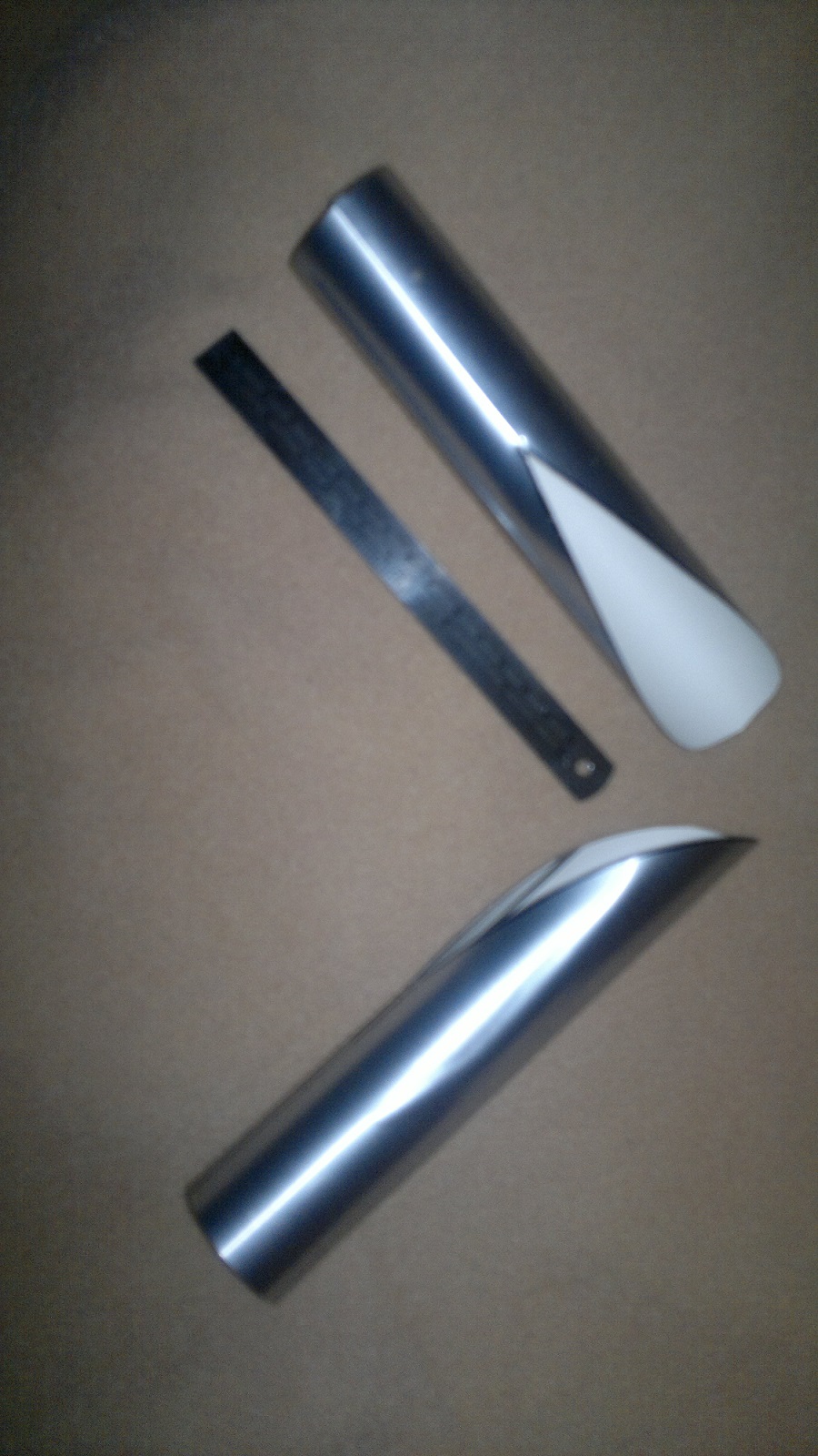

I find these 'K' speakers fascinating to say the least, so.......
I thought I'd get in on things and try a 'K-Tube', there's no math behind these, just wrapped 'stainless-alike' vinyl (used for sign making etc) round a 34mm form, a bit of artistic license with a sharpie and a few deft cuts with some scissors produced these.
Too late to play music at reasonable levels, so no impressions as yet.
Tweeters are some 1" fabric soft dome Wharfdale's I salvaged and run on top of my EmKens with a 2.2uF cap for cross-over.

Hmmm, the pic of the two tubes next to each other, if roughly 13cm, have slightly longer 'slots' than mine.
I taped and bits of stringed them in place over the dome - horizontal and facing inwards.
I listened to a bit of 'Clair Jones - The Girl With The Golden Harp'.
I'll say this - I can now hear Where Mrs Jones fingers touch the strings and hear the orientation of the instrument!
I do run some EQ and I left it alone.... bare tweeter can be a bit 'spitty' round the x-over to the 12lta, this seems to be lessened with the tubes in place![scratch1 :scratch1: :scratch1:](https://files.diyaudio.com/forums/images/smilies/scratch1.gif)
Maybe its because they are in effect a laminate
I'll see how they go when I can wind the loud knob up the scale and play with orientation for a few days.
