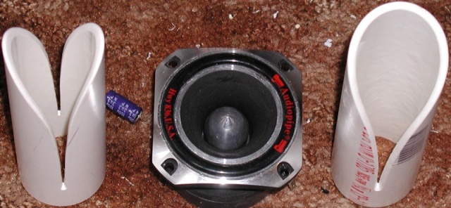

I emptied a soap box and made a pair of cardboard backplates, K-tube is pushed through a tight hole - then taped to the faceplate of the tweet.
Tubes can be rotated though I've not tried the 'pointing down' orientation as yet.

the unslotted stub can cause a dip - - having a diameter larger than a compression driver's exit can cause rough response (still sounds ok - no worse than typical full range speakers) - I don't know how well an average dome would match a tube's impedance. 5" long would be plenty with a full length slot - rolled paper might be the quickest way to test.

K-Tubes now angled down with slots facing each other - nails, string, cable ties and blue-tack all getting involved now

Hmmm, the pic of the two tubes next to each other, if roughly 13cm, have slightly longer 'slots' than mine.
I taped and bits of stringed them in place over the dome - horizontal and facing inwards.
I listened to a bit of 'Clair Jones - The Girl With The Golden Harp'.
I'll say this - I can now hear Where Mrs Jones fingers touch the strings and hear the orientation of the instrument!
I do run some EQ and I left it alone.... bare tweeter can be a bit 'spitty' round the x-over to the 12lta, this seems to be lessened with the tubes in place
Maybe its because they are in effect a laminate
I'll see how they go when I can wind the loud knob up the scale and play with orientation for a few days.
Skippy it has been my experience that the K-tube only needs to be 1/4 of the Fs of the driver so for a normal dome tweeter that means about 1.5 inches long. I also make the slot extend to almost the end of the tube. I position my tubes so they are parallel to the floor are centred at my seated ear level and point directly at my head. I use only double cutaway tubes now which look like a bishops hat. See the attached picture. I position the slots in the double cutaway so they are vertical.
