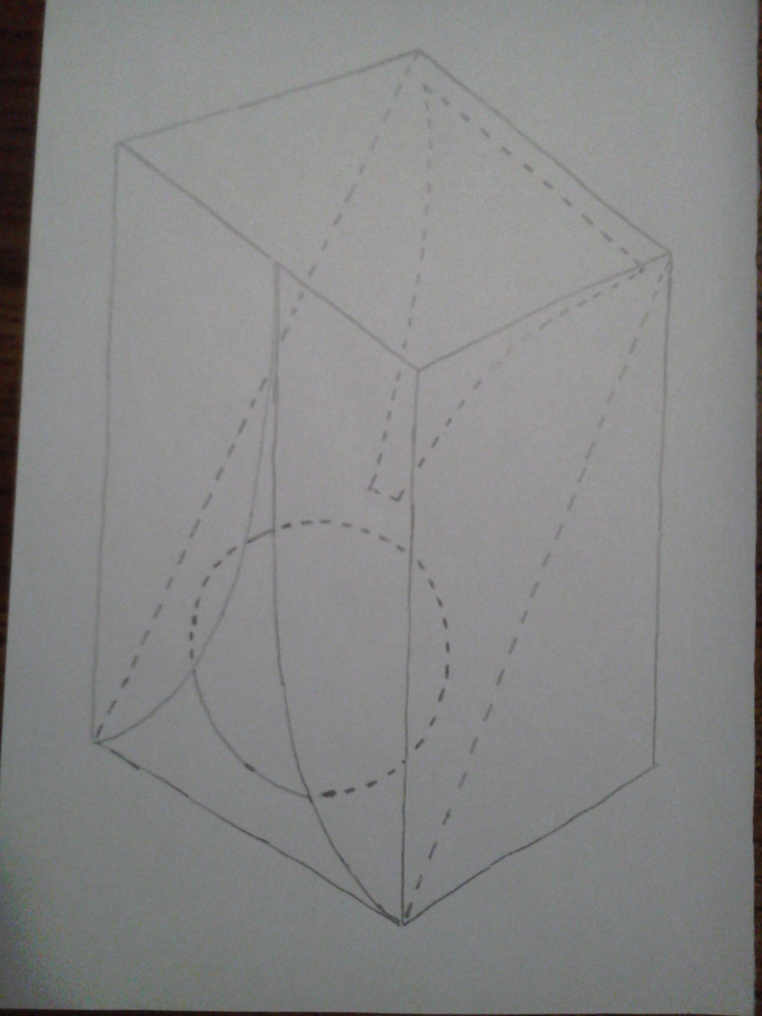

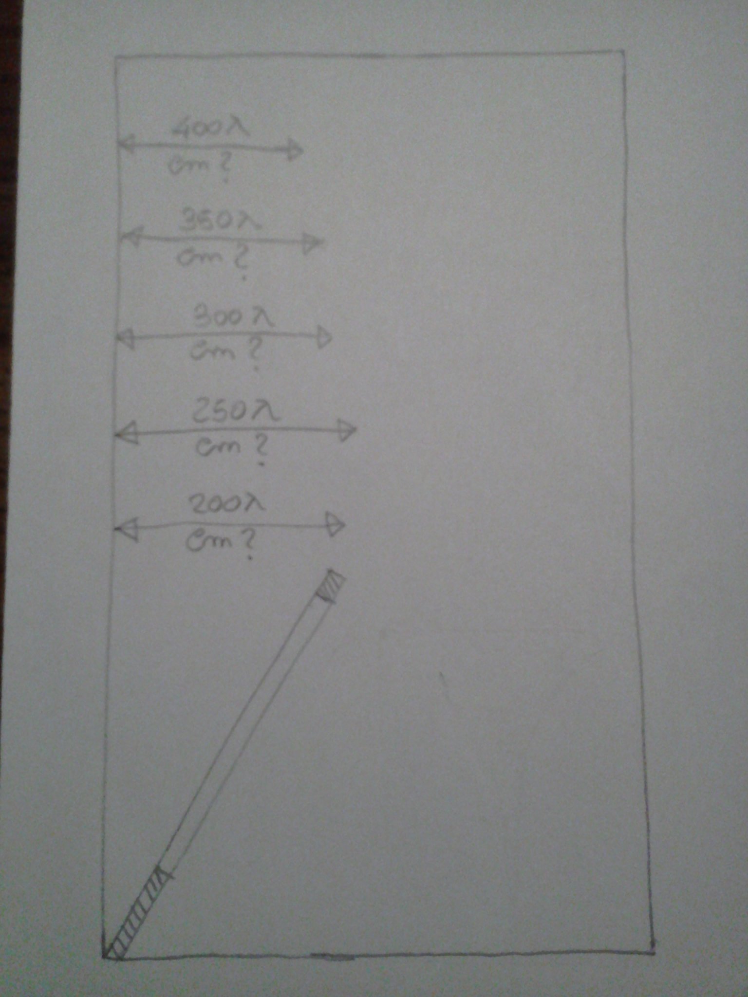

if the inventor has decided to give a very precise inclination of the loudspeaker with respect to the vertical curtain opening, I imagine there is a relationship, so I believe that the problem is to find the right distance between curtain and reflector at each frequency
arivel,
I had a sketch of something similar many years ago but promptly forgot about is. I don`t think the internal K-slot would be of any benefit versus any other opening/vent of similar dimension.
IMO, the angle of the speaker baffle should be set to a desired horizontal diffraction target, IOW to where the aperture intercepts the on-axis radiation of the driver. It won`t matter much for lower frequencies, where a square or circular opening would do just as well, but if using a fullrange, coaxial or high-crossed midbass, the tighter the aperture at intercept, the wider the horizontal pattern. I would probably recommend a slightly steeper baffle angle for the classic designs like K15 and K12, around 20-25 degrees from vertical.

Think also of the direct frequencies going from near the floor (position of the driver) up to your listening position.

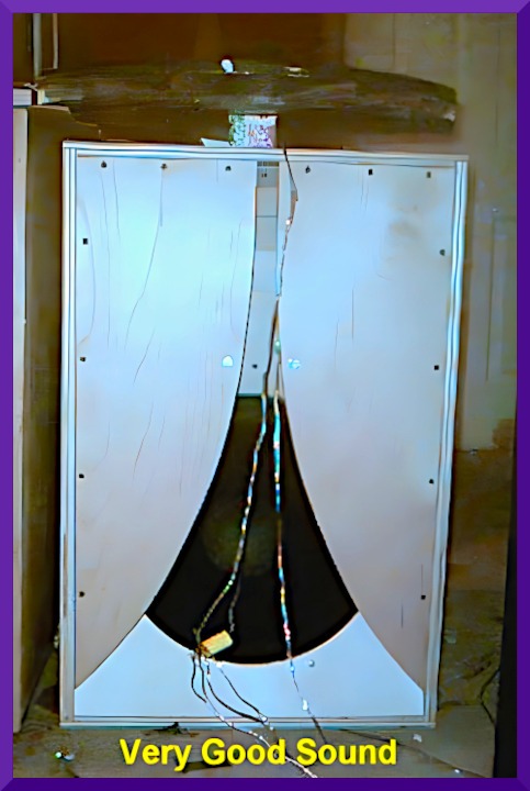

Here's a little "K18" built something like Karlson's 2nd K12 with ~23 degrees baffle tilt, a fowards 10 degree tilt to its port panel. The port panel had two 4.5" x 4.5" square ports. Between those was a hole to mount a K-tube.
If those wings were swiveled inwards at the top for a 5/8" starting gap, sound quality was "constricted" opening to 1.2" gave very good sound quality.
Its obvious there could be many combinations of gap width - wing taper type which could give good result. One set of wings swiveled will let you hear some changes which do not show in measurements.
Also, with my 18 inch speaker, it was fine to have aperture width in the vicinity of the speaker less than that of the usual rule of visually intercepting the cone's surround.
K-wizard Carl Neuser spoke of evaluating a number of apertures -radial arc,"trax 60", exponential, etc.
Acoustic Control's 115BK is a very good little X15 sized K-coupler and could be used with 80Hz crossover to subwoofer.
K15 with appropriate drivers is excellent.
It would be nice for IG81 and other's to formulate a K-recipe strategy for new K-couplers. Maybe TK6 will illuminate some areas to konsider.

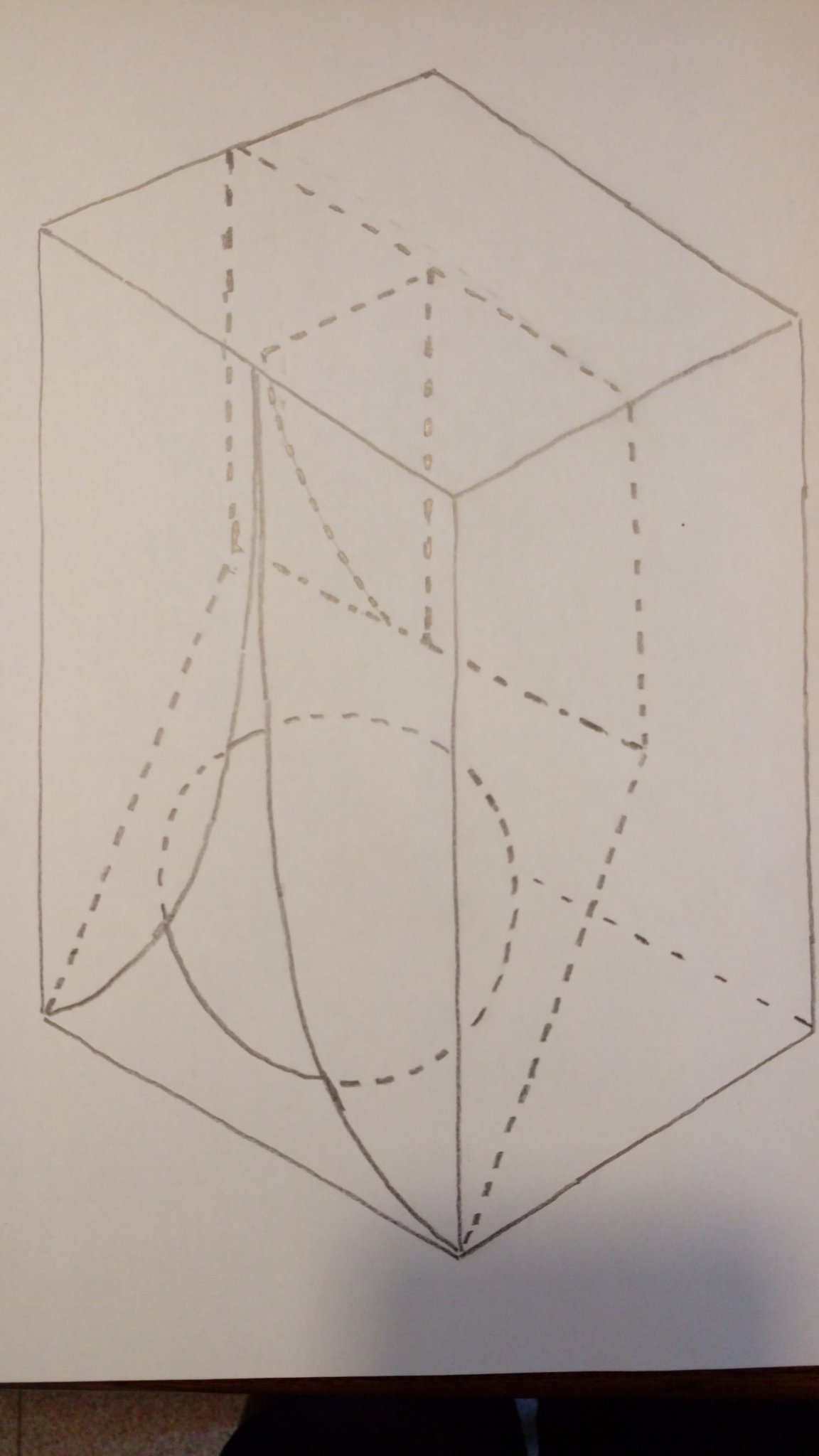

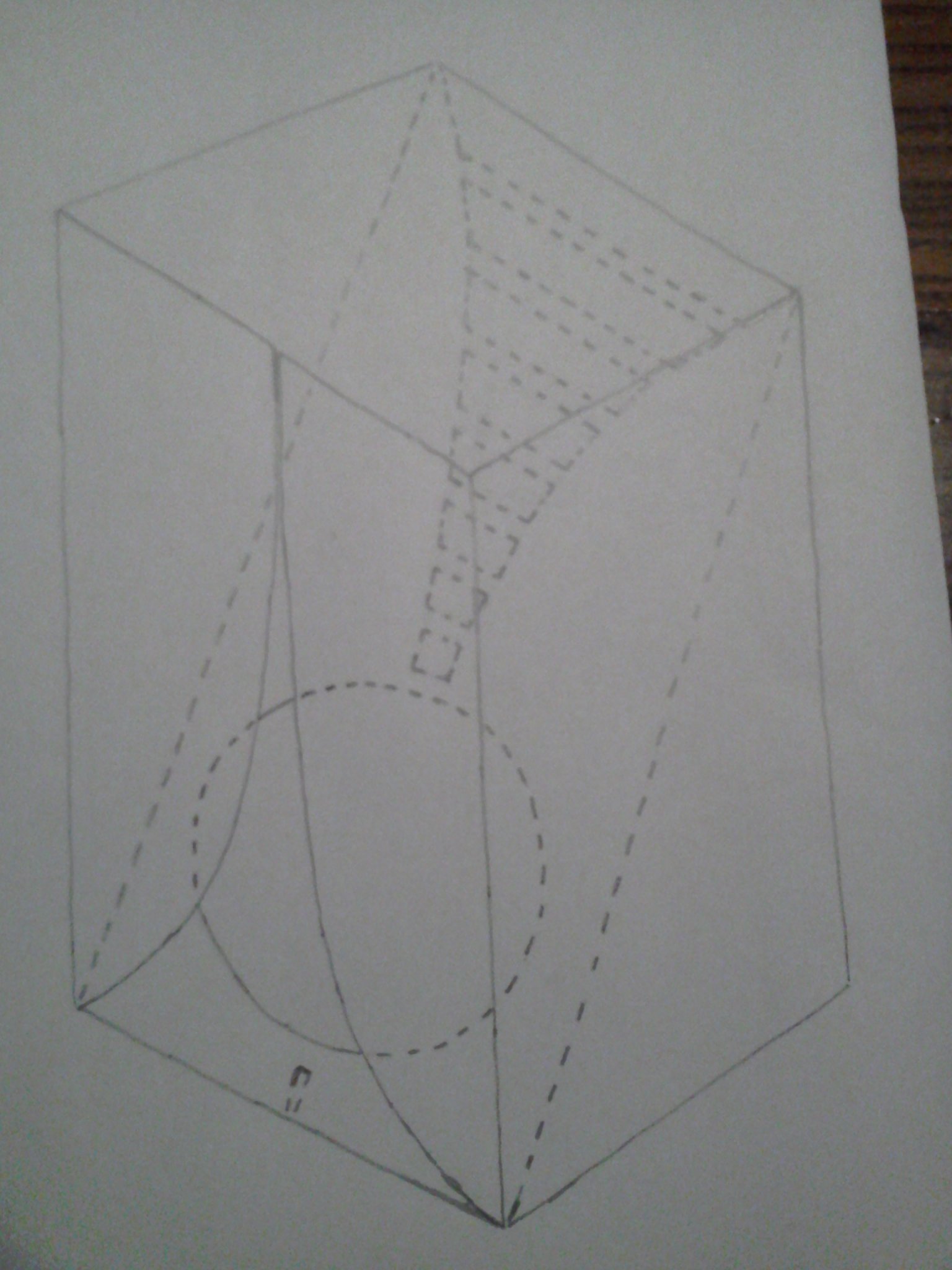

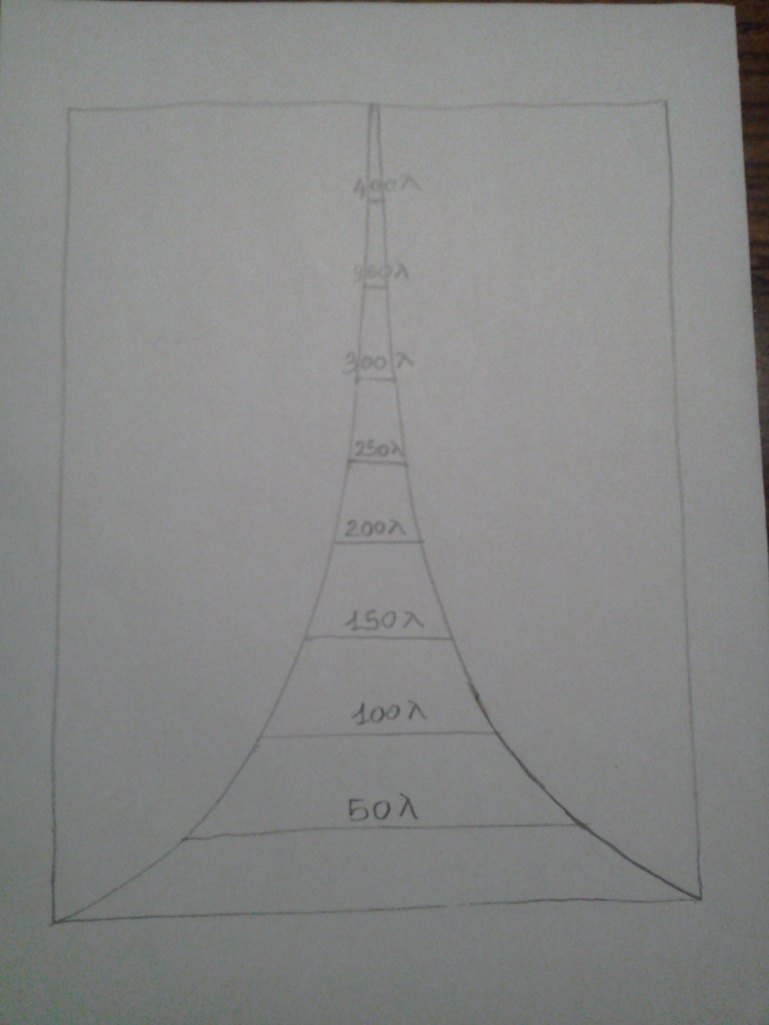

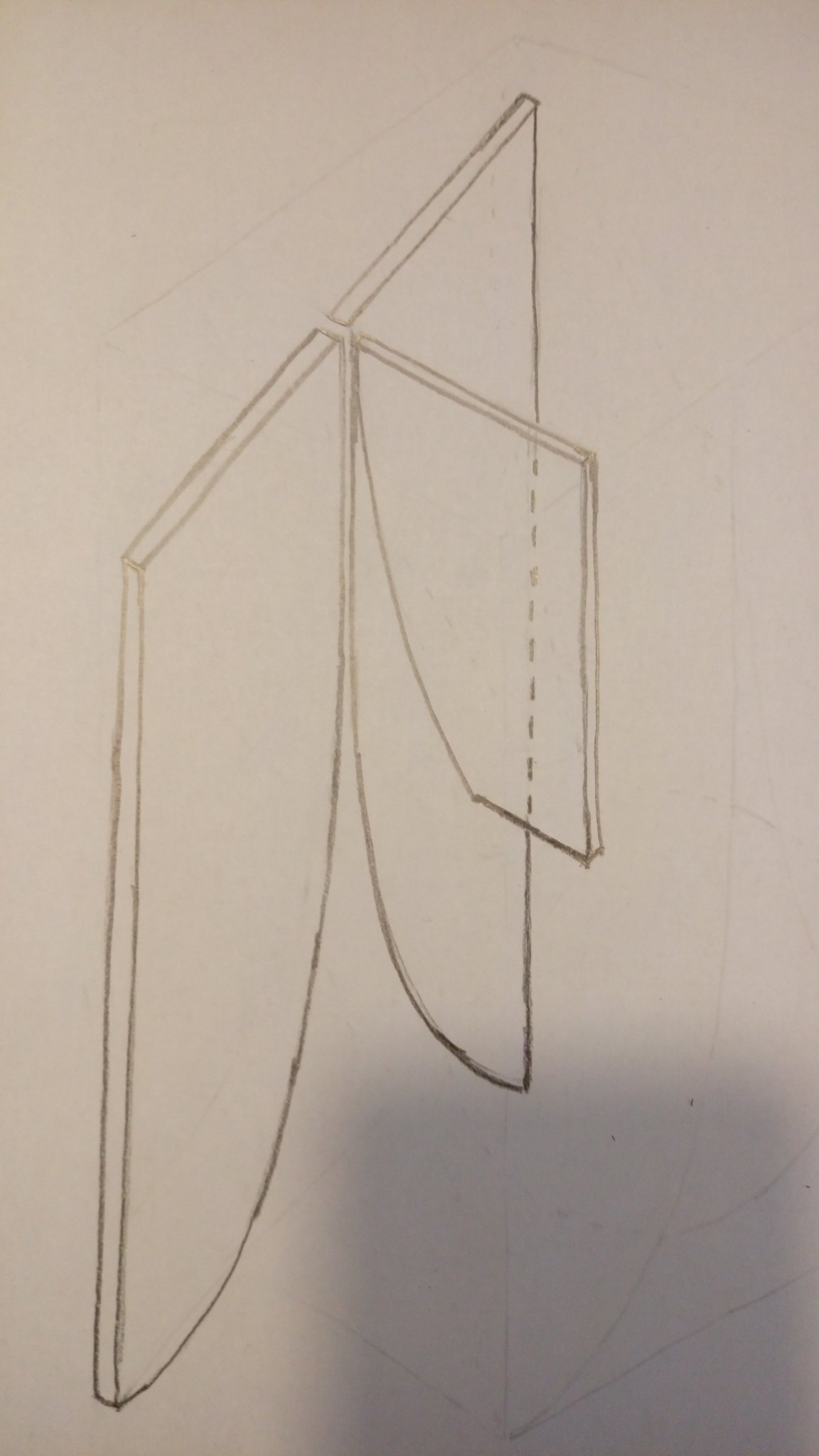

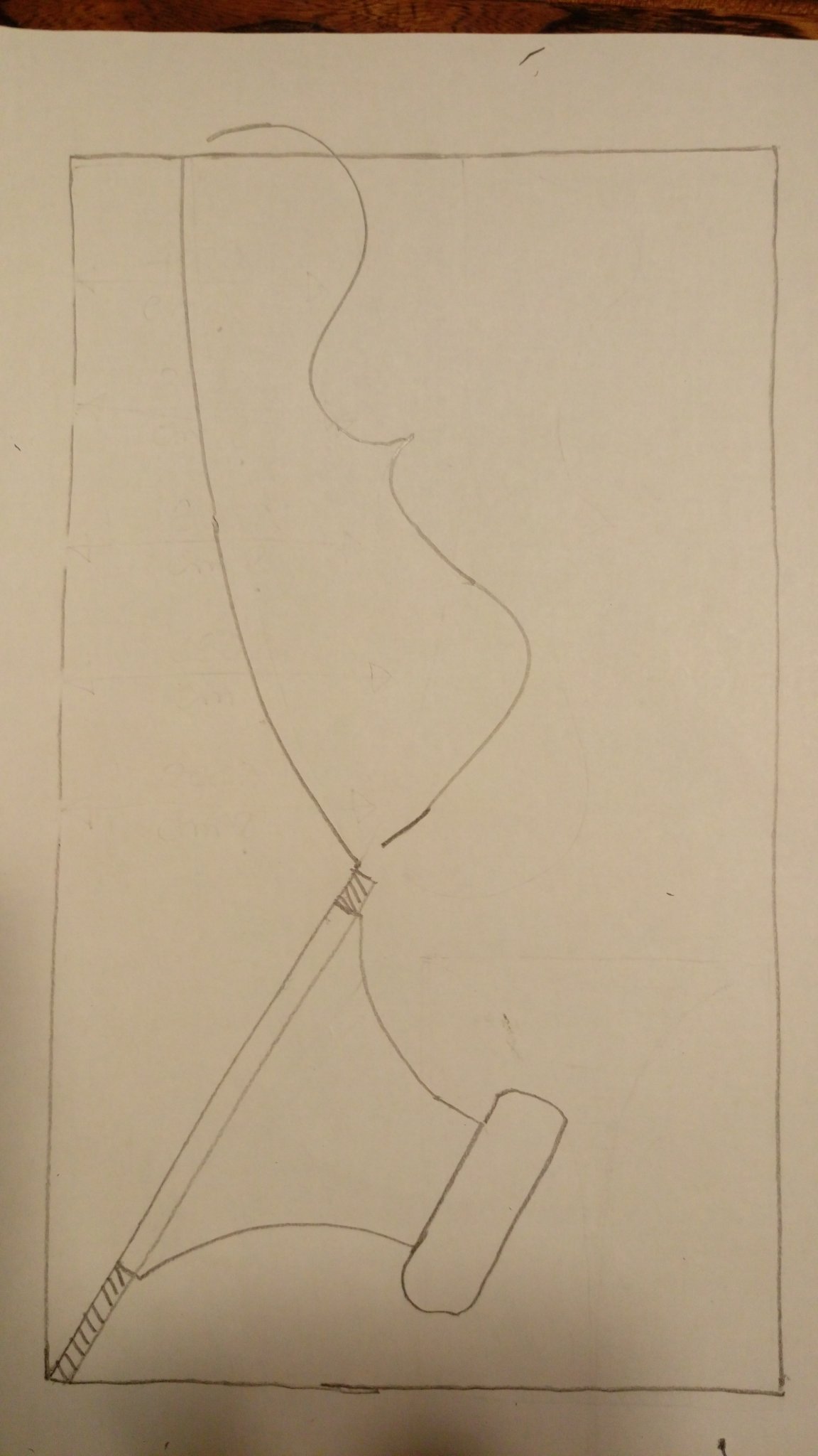

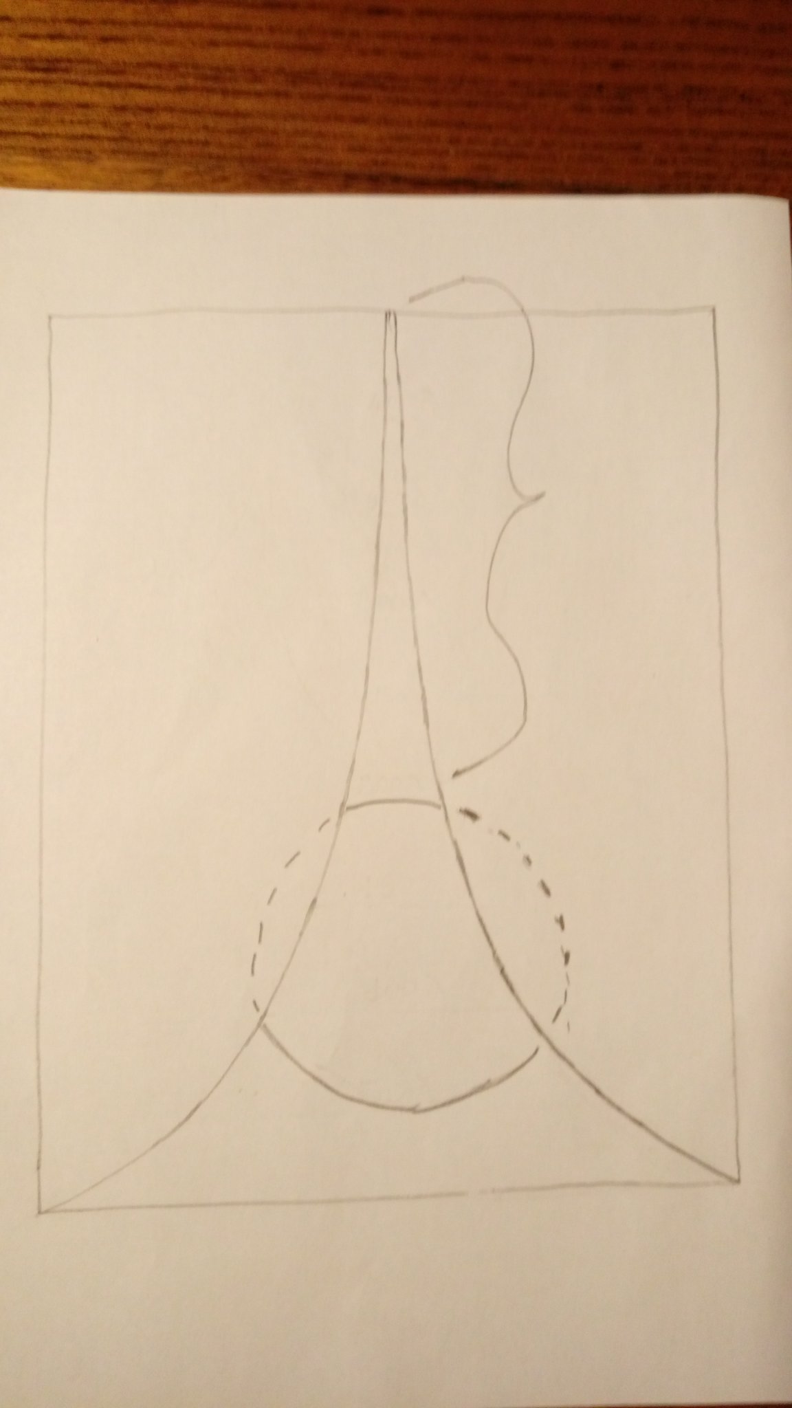

I did not understand if we are talking about the same thing so I am attaching images. for obvious reasons I could not draw all frequencies

arivel,

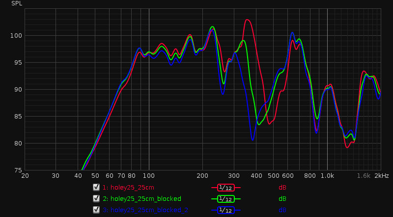

I was talking of the sketch of yours with the internal K-slot, but I also had a similar slot analysis on the defunct Gainclone Karlson forum. The aperture will diffract up to certain frequencies with varying width of course, but I forget what was my exact point back then, though I likely was pretty flawed. 🙂
IMO, the aperture area is the dominant metric, with its starting gap having significant weight towards front chamber tuning. The shape cleverly allows a good amount of direct-radiation from the driver to escape while keeping the tuning from being too low or high.
The below graph demonstrates blocking the slot apex on my TK6 in two steps, perhaps ~3-4" each time.
Red = unblocked
Green = ~3" blocked
Blue = ~6" blocked

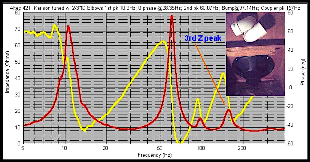

K15 has a back chamber volume of around 105 liters , and a system tuning of around 48Hz. That pretty much sets its low frequency cutoff. K15 has been tuned lower by John Tucker for subwoofer use in the Exemplar project where tuning is around 30Hz and boost applied at fb. K15 used that way makes an excellent subwoofer with Altec 15" speakers..
If used for more than low-bass, the tuning of the rear chamber should not be too far below that of the front chamber, or risk having a dip in response in the area where the Karlson excels most. The proportions of classic "kouplers" sort of force a higher tuning frequency, in large part because of how speakers were designed in those days. If you tune low with fullrange use in mind, you have to pull-down the front chamber gain to the level a standard reflex would yield yet are still left with response anomalies above this, so no real benefit IMO.
