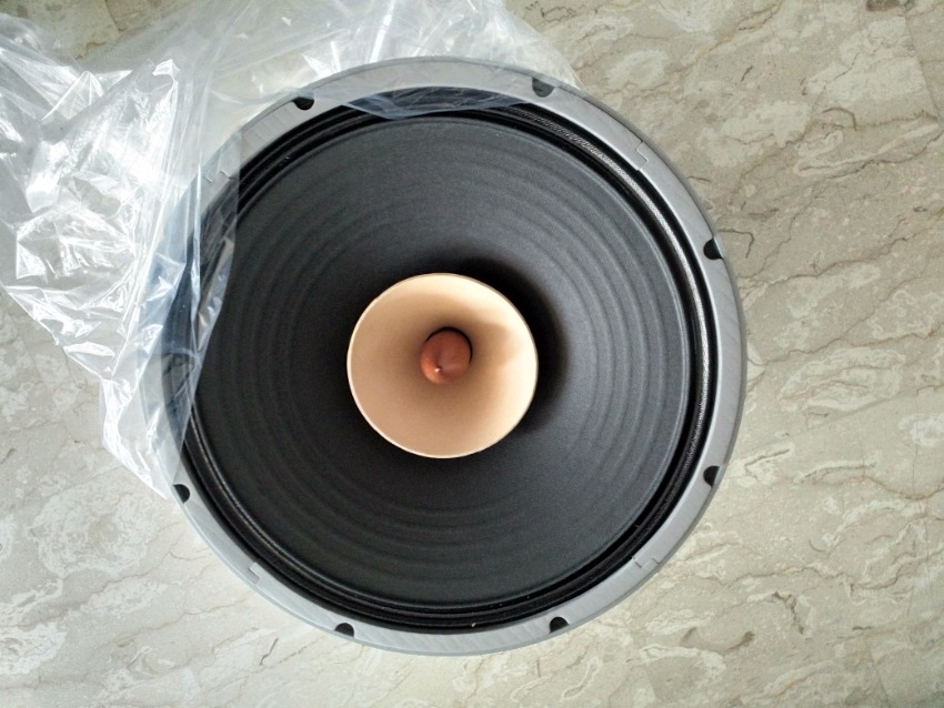

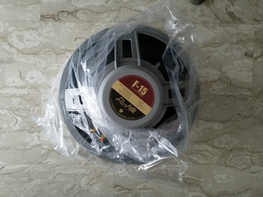

I went with one single fullrange for many reasons, simplicity, no crossover eating up the signal, cost, a more realistic presence due to one single point of sound emission. There are always limitations, the first one being "you", the equipment would go much further than your perceptions.

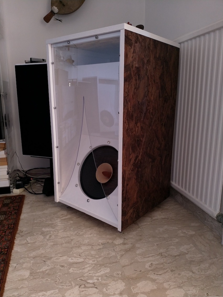

I made a huge Karlsonator in OSB (crazy idea isn't it) with a LII F15 driver. For months I tried many different internal partitions, event size etc...to finally taking off the front panel so it is no more a K per say, I lose bass but gain on clarity and space, the thing is a pleasure really.
Now if I was courageous, I would try a pure original K15 design with this driver, that would help to get rid-off my wife as well....and I am not prepare yet !

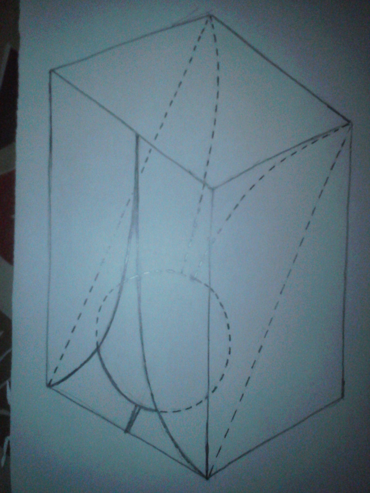

Some how methinks the two pieces comprising the Karlson exponential "slot" would do well to have some sort of sound absorbtive backing - as well as the baffle the driver is set upon. (I realize that wont work if these pieces are clear plexi) But there has to be a bunch of sound pressure bouncing around in there, being as these features partially cover the driver.
Which leads me to wondering if you unwrapped the whole thing into a tall box, with the driver on top, if that "coloring" would go away?
I've only attempted to use current drive with something crossed waaay above cone resonance; a bass helped driver on an OB panel. Sounded fine to me. Just the other day I ripped it all apart, re-adusted all the filters and levels - thinking it was the cause of something amiss and it wasnt. :'(
I have no idea, it is going to be a headache for sure. I would start with a smaller back slot, the driver must be solidly fixed to the box with rather thick walls for strong rigidity with this design. It is certainly interesting to try I think, some kind of "sloted" OB, I haven't seen anyone building this design.what would it be like if it were like that?

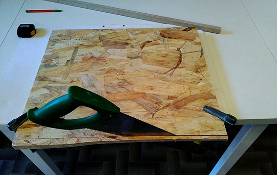

even if I want to, I can't because I don't have the tools and skillsThat one is a rabbit hole suitable for the keen and I will cheer for anyone mad enough to do it for the sake of fun! This is the stuff that makes old people remember being young![]()
All my DIY have been made on my kitchen table, hacksaw, files, screwdrivers, drill....basic tools and no special skills !even if I want to, I can't because I don't have the tools and skills
