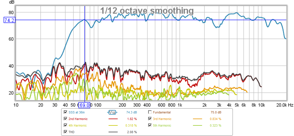

Update on Foam Core SSS with TC9FD's
I tested the SSS far away from a wall to see if the phantom stereo image could improve - and it did. I also measured the frequency response away from a wall and it still has sufficient bass to not require a BSC circuit. The speaker is 48 in from a back wall and the drivers are 36 in above the floor. Here is the frequency response and harmonic distortion at a typical listening level in the mid 70's dB SPL. I am also including a sound clip to demonstrate what it sounds like away from the wall.
The dip near 3kHz is predicted in the sim - it is a cancellation as a result of left-right driver-driver comb interference and goes away as you move off axis.

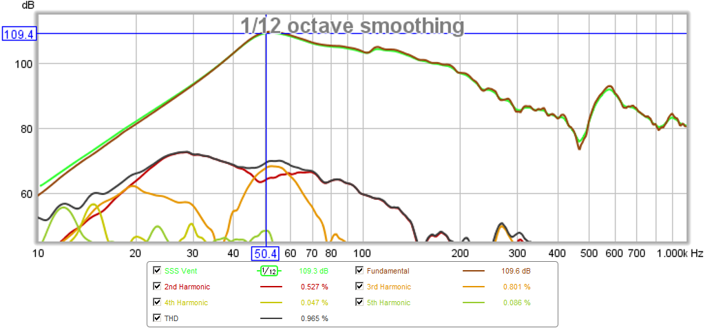

Here is the response of the vent (measured at exit plane):
That is a pretty low 50 Hz peak in the output and distortion is relatively low (1%) at this moderate SPL level.
![425054d1403491095-master-nagaoka-tetsuo-explorations-matrixed-single-stereo-speakers-sss-tc9fd-freq-meas-36in-high-48in-wall.png](https://www.diyaudio.com/forums/attachments/full-range/425054d1403491095-master-nagaoka-tetsuo-explorations-matrixed-single-stereo-speakers-sss-tc9fd-freq-meas-36in-high-48in-wall.png)
![425056d1403491334-master-nagaoka-tetsuo-explorations-matrixed-single-stereo-speakers-sss-tc9fd-vent-meas.png](https://www.diyaudio.com/forums/attachments/full-range/425056d1403491334-master-nagaoka-tetsuo-explorations-matrixed-single-stereo-speakers-sss-tc9fd-vent-meas.png)
