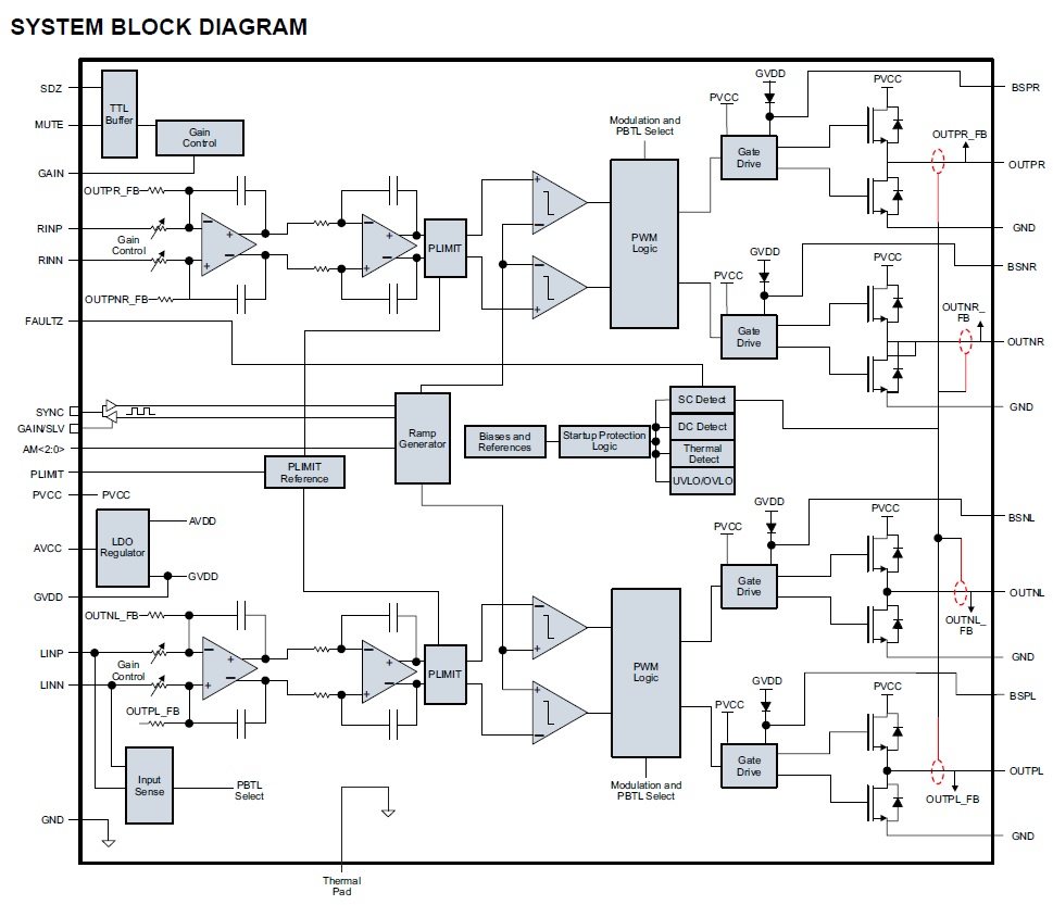

I didn't pay attention to it, but I looked it up just now and found the TPA3116D2 you use is internally bridged.
In a bridged amp, both of the output terminals are 'floating'. So I'm very curious how your system actually work -- you tie the negative side of both channels into one common, and the chip is still doing OK? Wow !

I knew this which is why I never tried this until I got a cheap class AB amp to play with. It works well with class AB amp. Anyhow, I happened to get a new 3116 amp one day and said what the heck? Why not just try it? I know that the 3116 is bullet proof so at worst it would just shut down. Anyhow it works but at very low volumes - somehow it does not short out right away. If works up to about 40% volume (music dependent - peaks shut it down sooner). I would not use it with a class D amp more than just to test for grins. But what I suspect is that it may work fine if you have dual class D amps (one for left and one for right)?
There are some class D amps like the IRS2092 MOSFET driver that probably will work because each channel is independent and not bridge tied.

You can't tie the 'negatives' of a class D amp together like that. The negs aren't 'gnd' but more like ... well the negative half of a BTL.
I know you are not supposed to connect them together - but I did it anyway to see what happens. It works at low volume but shorts at higher volumes so technically doesn't work. I have not tried connecting negatives of two separate class D amps together - so don't know if that doesn't work.
It's a bit more than "not supposed to".
It's stereo, so the L and R signals are different. Output Lout- is trying to put out a different voltage/current than output Rout-. Both amps are "fighting" to put a different voltage/current to the same node.

It's the same as if you tried to connect the L and R channels of a normal amp to get mono. You'd need some "sharing" resistors of 0.2 ohm.

Ahh but I do have "sharing" resistors
of nominal 6.3 ohms resistance in the L and R channels before the signals get summed. I did not have to worry about releasing the magic smoke because 1. The TPA3116 is idiot proofed with auto shutoff in case of shorted leads, 2. The amps cost $13 to $20 so no worries. I will stick with my $5 class AB lunch money chip amp for this when away from the console amp.
