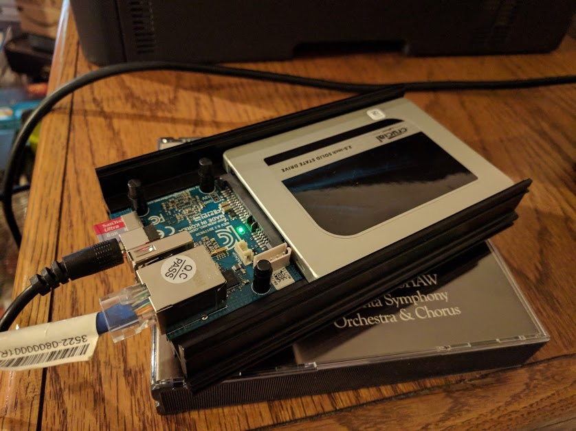

A nice piece of kit
I got tired of using old computers as my NAS and didn't really want to use an RPi or other SBC with an external USB2 drive. Then I saw the new Odroid-HC1 (here in the USA, at ameridroid.com) and couldn't resist.
My order arrived this afternoon. Here's a snap of it + a 250GB SATA SSD sitting on a 2CD case to give you a sense of scale. I set mine up with Open Media Vault on Debian 8 but it can run a fair variety of distros.
Fast, compact, reasonable power (I bought a 5v/4a supply at the same time); Ethernet only but that's what I wanted. I'm not sure where I want it to end up so I'm not worrying about an enclosure yet.
