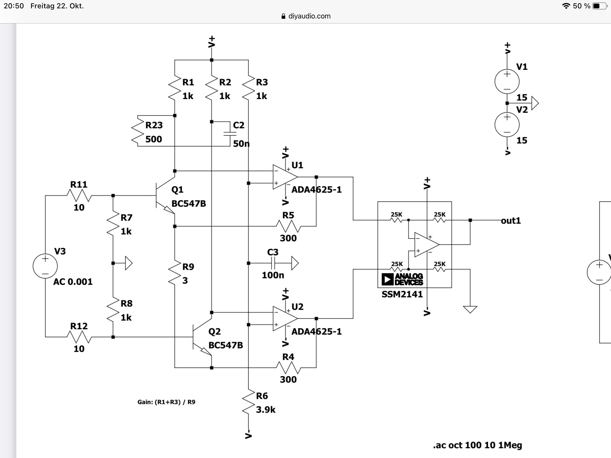

I was also thinking about to build something similar to this version. I think, the gain formular in the picture is wrong. Should be (R5+R4) /R9.
By making two single voltage deviders to the Opamp +input, offset could be adjusted, right? (a pot in one leg to V- or GND)
R23/C2 could be omitted for two small Cs between the Opamps - input and output, like in Hans' design.

Even more precise, gain is [1+(R4+R5)/R9]

If this pre-pre is meant to be used in front of a MM Riaa amp, why is gain that high?
If going to be used in front of a A/D where a DSP will apply the time constants, be aware that the Vbe differences between the two transistors are temp. dependent but will only cause a few hundreds of mV at the output.
So either caps in case the A/D doesn’t have them already or a servo will do the job.

I also will build the Kirkwood pre-pre so I can compare.
Isn’t the only difference between the two that yours is SE out and Wayne’s version is differential out?
Hans

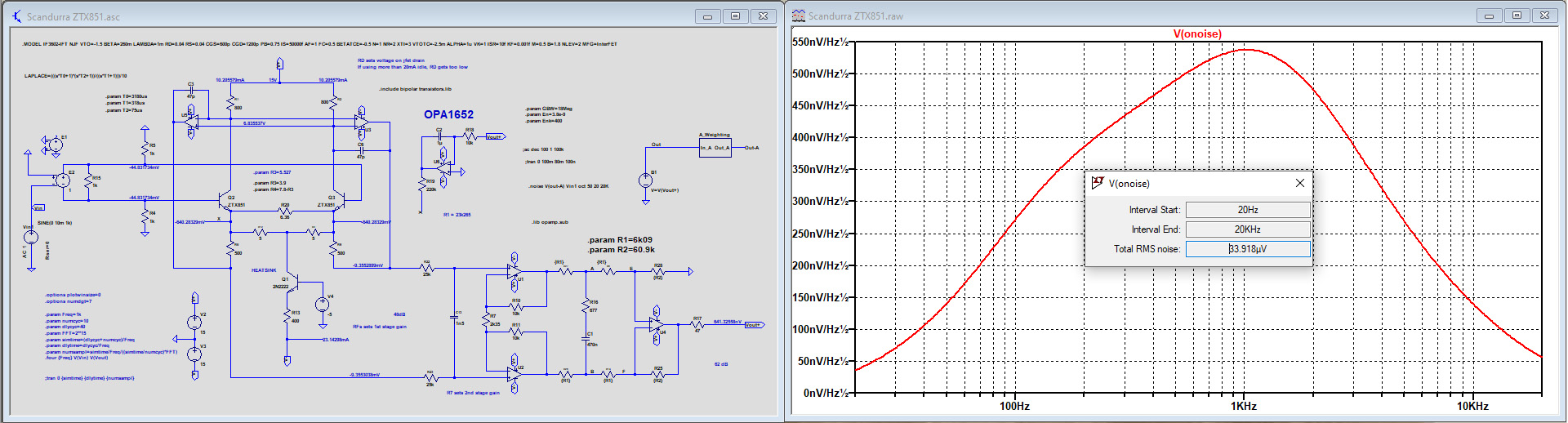

I can not make it work as there is always a negative voltage in the collector of Q1 (ccs npn)Joachim,
Since you mentioned a bipolar version, I had already made a bipolar version for myself based on the same design topology but with halve the current in the LTP.
This bipolar version has exactly the same noise and gain specs as the IF3602.
So just for the record, here it is.
Hans
Maybe it is due to the model I am using:
*ZETEX ZTX851 Spice Model v1.0 Last Revised 21/1/93
.MODEL ZTX851 NPN IS =1.0085E-12 NF =1.0001 BF =240 IKF=5.1 VAF=158
+ ISE=2E-13 NE =1.38 NR =0.9988 BR =110 IKR=5.5 VAR=46
+ ISC=4.6515E-13 NC =1.334 RB =0.025 RE =0.018 RC =0.015
+ CJC=155E-12 MJC=0.4348 VJC=0.6477 CJE=1.05E-9
+ TF =0.79E-9 TR =24E-9
Would you share your LTSpice model for the ZTX851 ? I have some in my stock.....
Post 11569 ? This voltage must be negative, if the input is grounded.
In the case of bipolar input transistors the ccs has to be set up with a
separate reference voltage.
Your model is correct, but Rbb is way too optimistic, that value RB should be modified from 0.025 to 1.5.I can not make it work as there is always a negative voltage in the collector of Q1 (ccs npn)
This value of 1.5R has been measured and verified.
But it cannot be the reason why your file does not work, it only influences the noise figures.
Right.... thank you so much

I understand hans but those biss bjt come ultra well matched.
Now I understand why my sim did not work... I kept input base to gnd resistors as 220k.
Replacing those with 1k made everything get back to normal.
As I prefer to load my benz cart with 1k5 ohms I need a slightly higher base ref to gnd... will try 2k
Two 1k resistors to gnd mean 2k for the cart.
So when replacing the 1k over the input by 6k, you will have 1.5 for the Cart.
Hans
