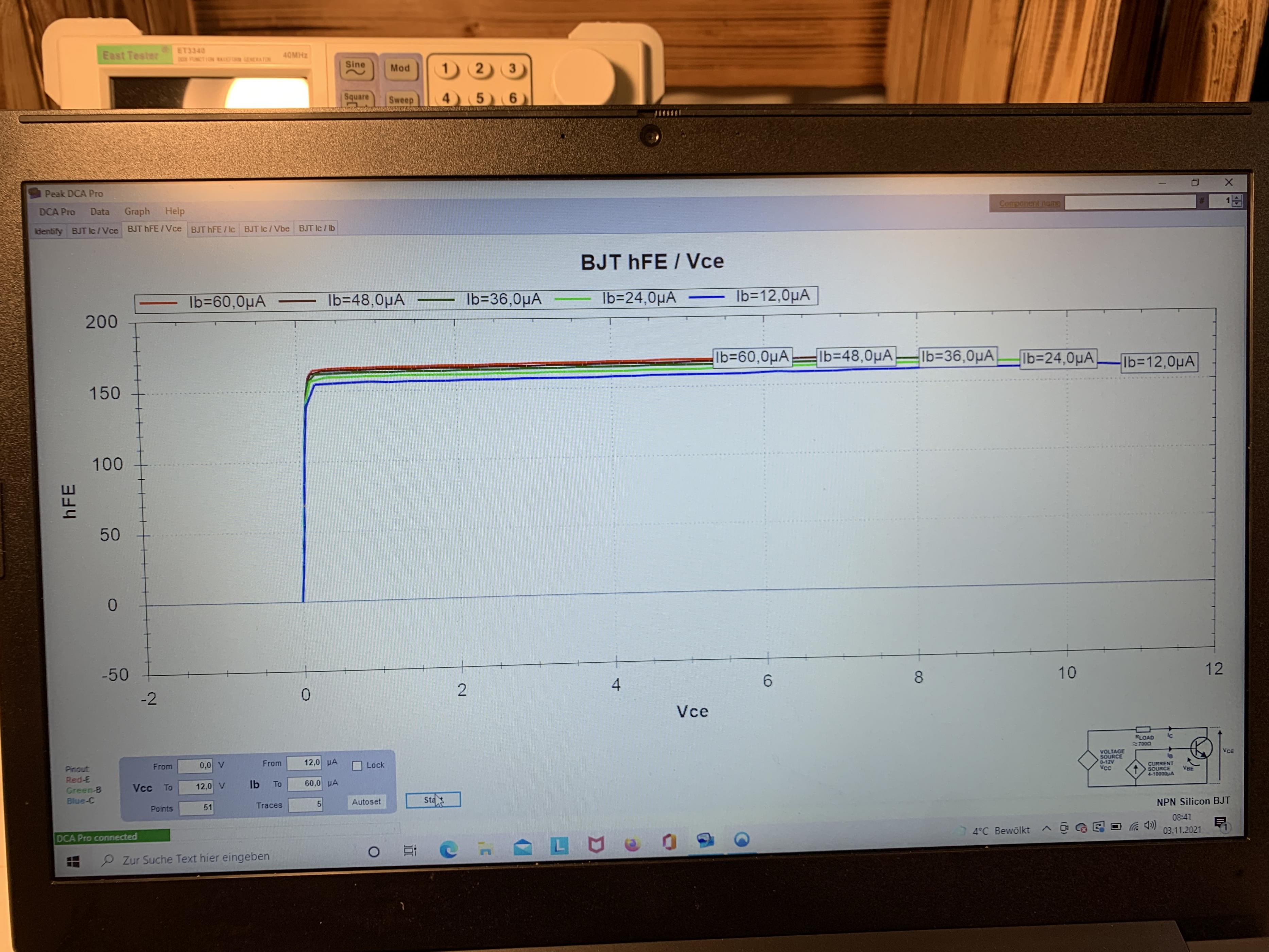

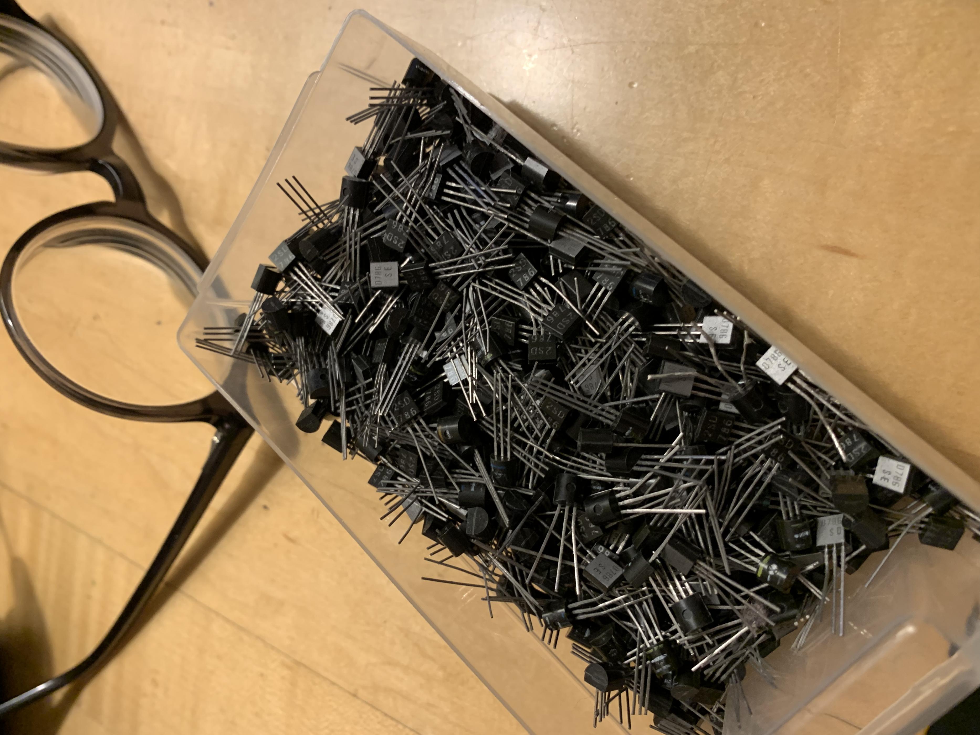

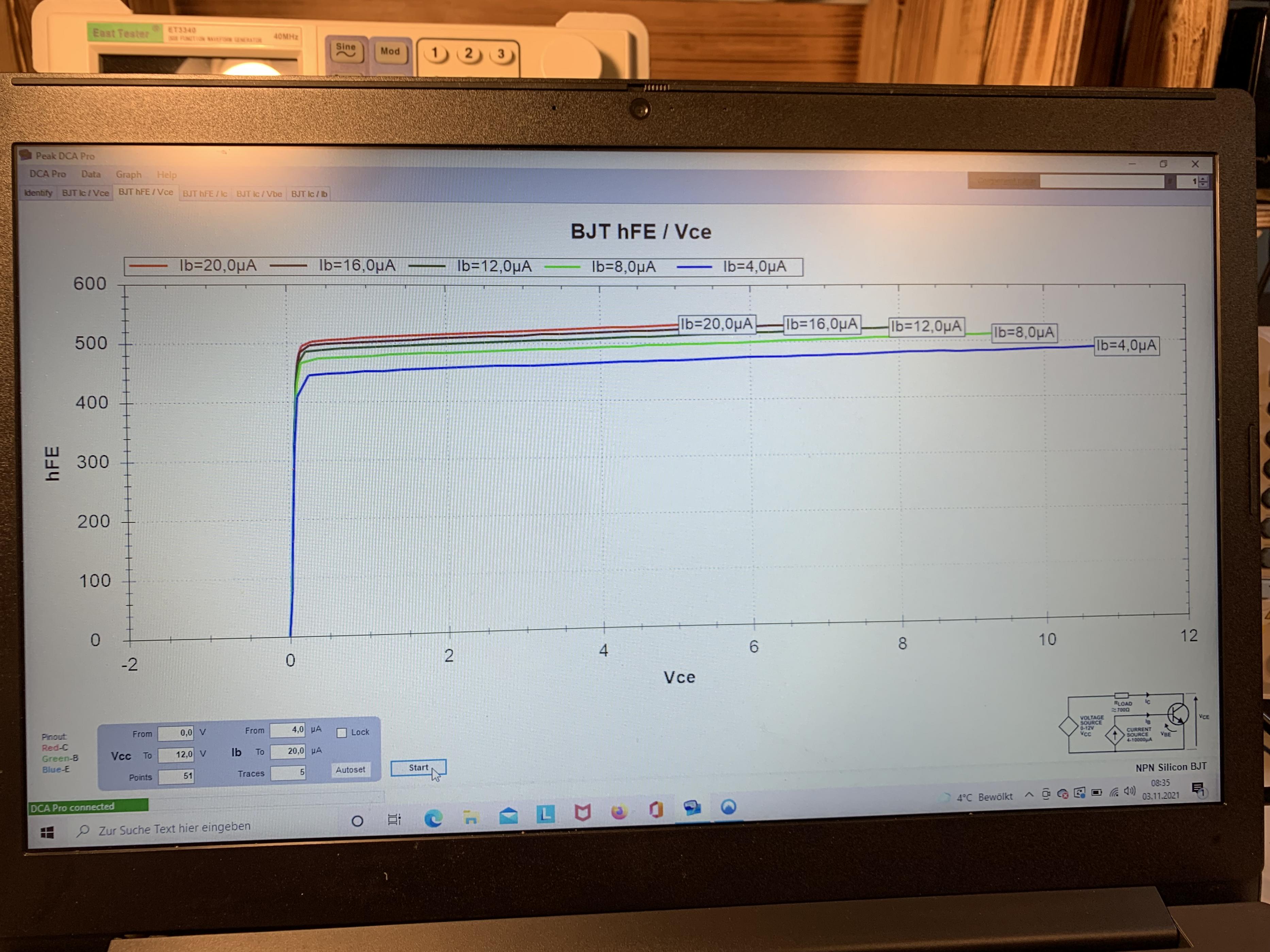

The BC547 are only placeholders. I use the ROhm 2SD786. I find them superior even to the ZTX851 because they have a much bigher Hfe, so direct coupling is less problematic.

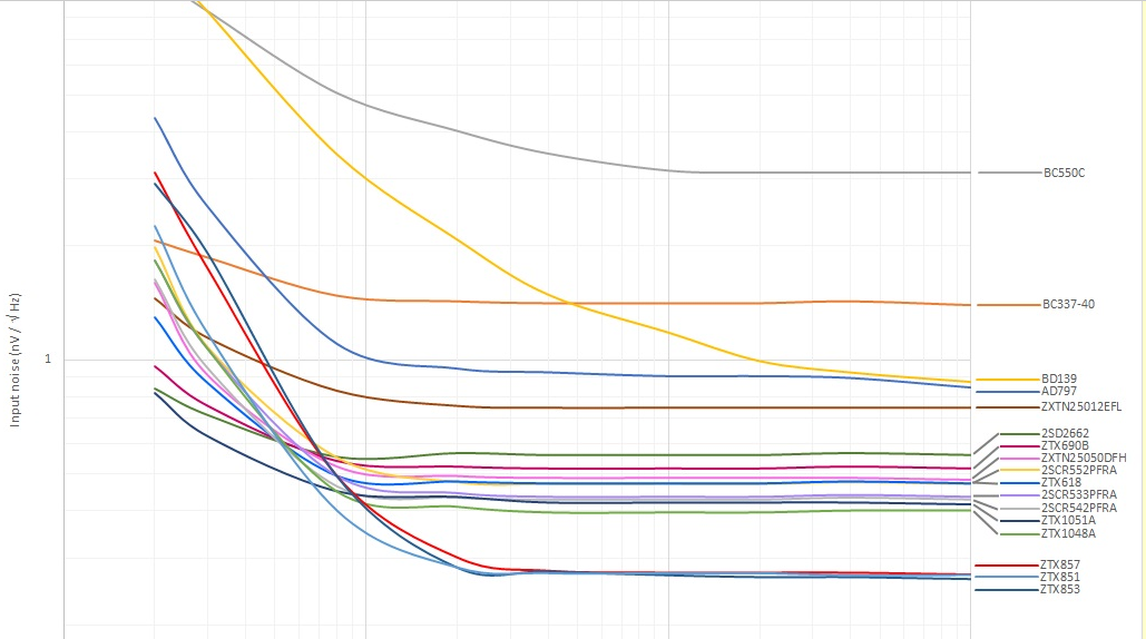

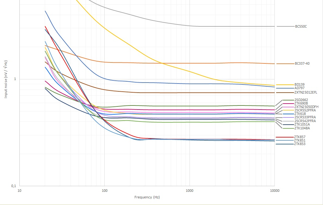

Well, you’re not short of transistors.
The ZTX has an Rbb of 1.5R versus 4 to 6R for the ones you have.
With two transistors that’s 7R less or 0.34nV/rtHz.
And the ZTX has a sister with much higher hfe with an Rbb of 3R.

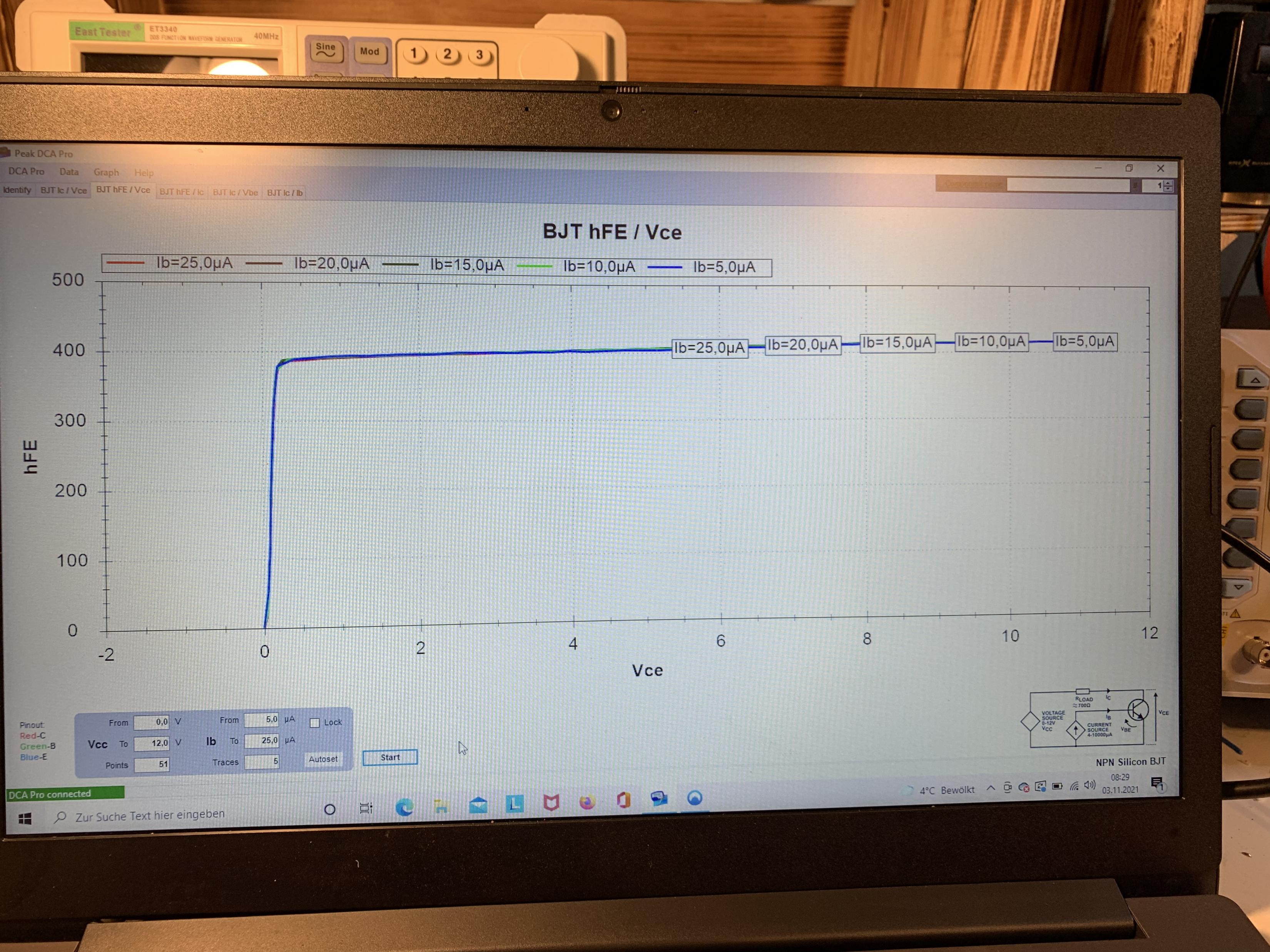

Transistor is the ZTX1053A with an Hfe between 300 and 500.
But Rbb is with 6R slightly worse as your 2SD786 so if you want a high Hfe, the 2SD786 is a perfect choice.

I have used ZTX1051A.
As far as I can tell they have around 7 Ohm Rbb‘ and high Hfe.
They also have a somewhat lower 1/F corner then the ZTX851.

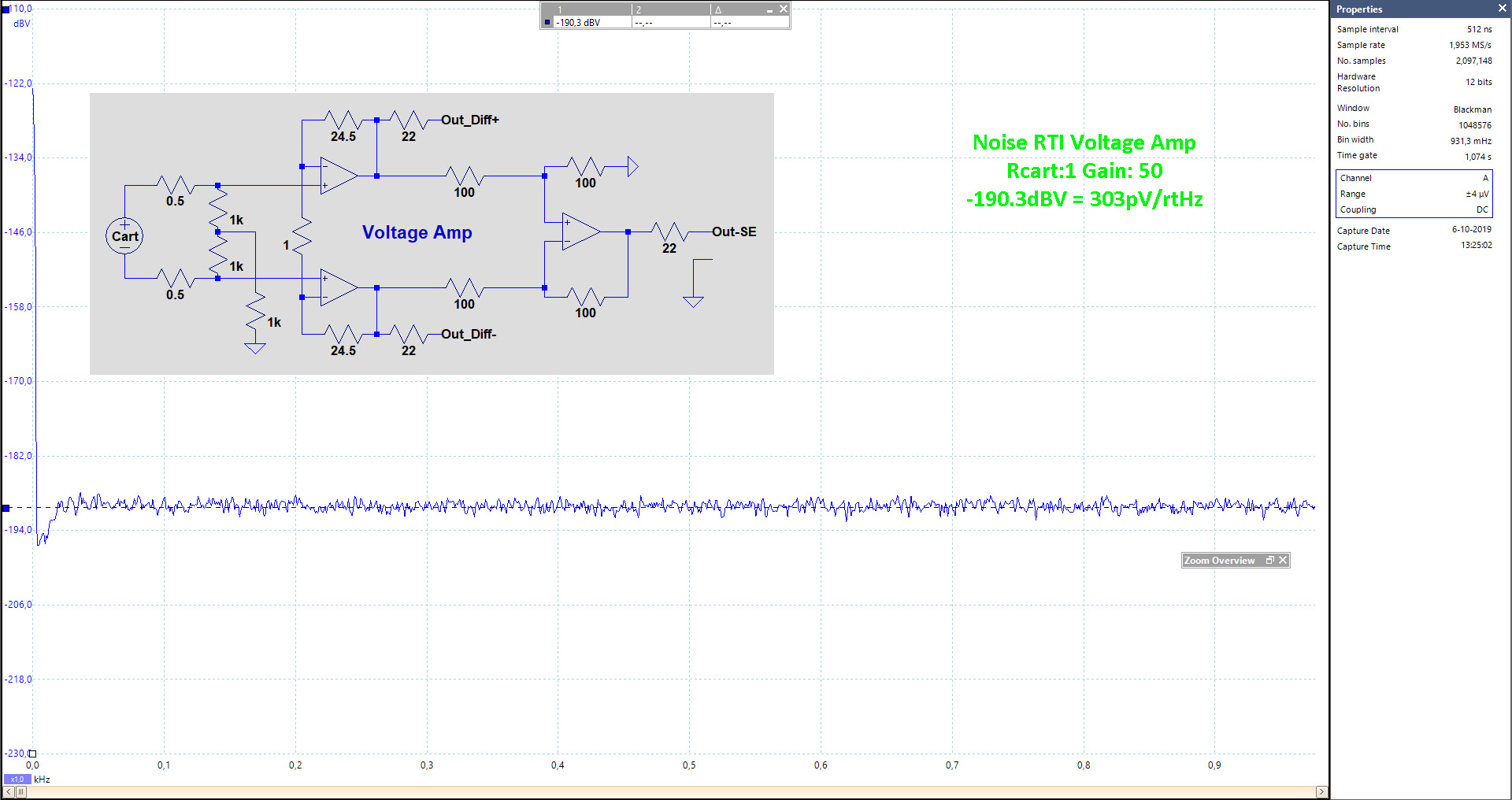

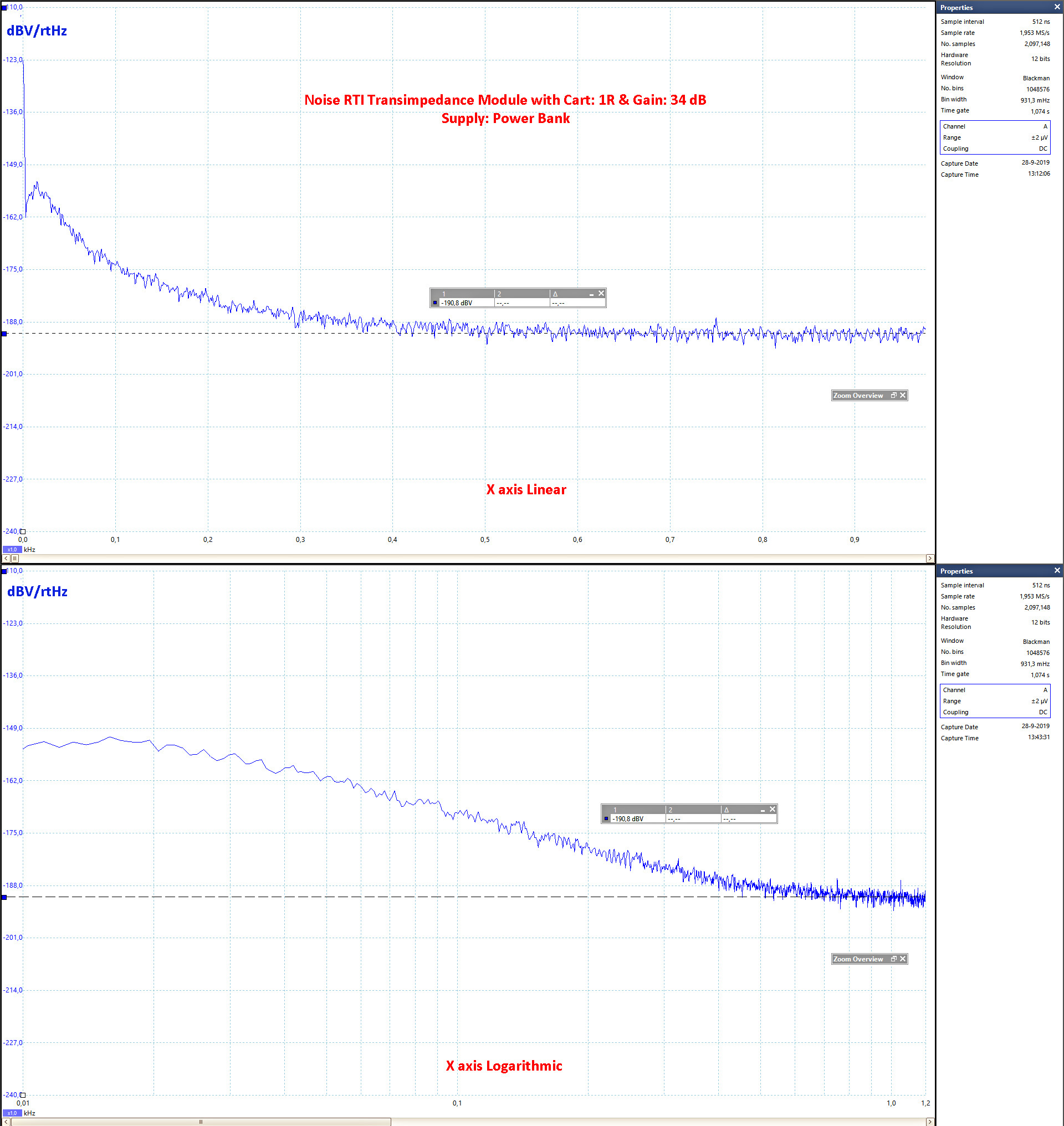

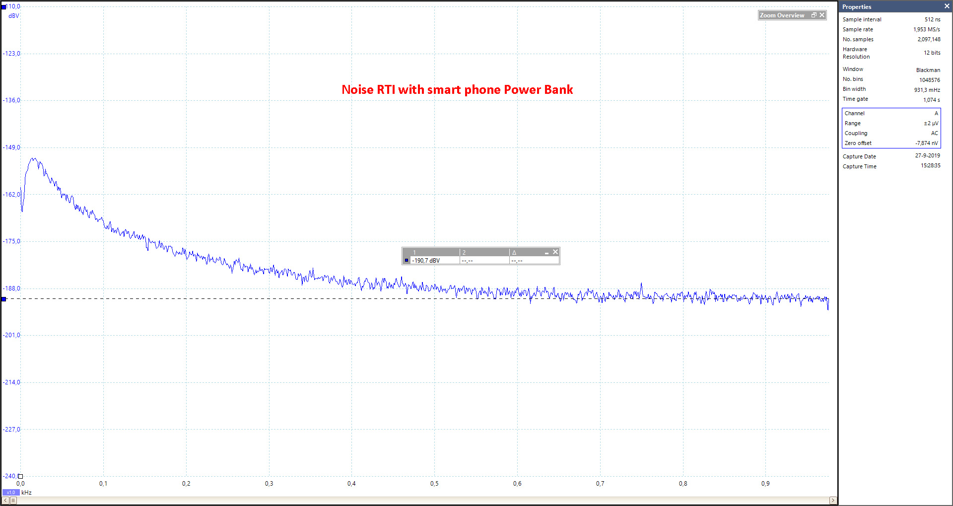

I had originally similar figures as you just showed, but after extensive searching this showed to be caused by the Nichicon supply caps.
By replacing them by Panasonic 105C FM caps the problem was completely solved.
See noise image below with those initial Nichicon caps.
Syn08, a well respected member on this forum changed these caps in his low noise phono amp with similar positive results.
Hans
Hans
When noise is becoming that low, every component should be of superior quality and leaking electolytic caps that normally do what they are supposed to, can obviously cause severe problems in very low noise designs.
Hans

Here is the same spectrum with the Nichicons but now also on a log freq scale.
Here you see a very unusual 30dB/oct slope, a slope that was also visible in Syn08’s completely different design.
Because that being quite strange for 1/f made me search for a possible cause, eventualy landing at the Nichicons.
Hans
