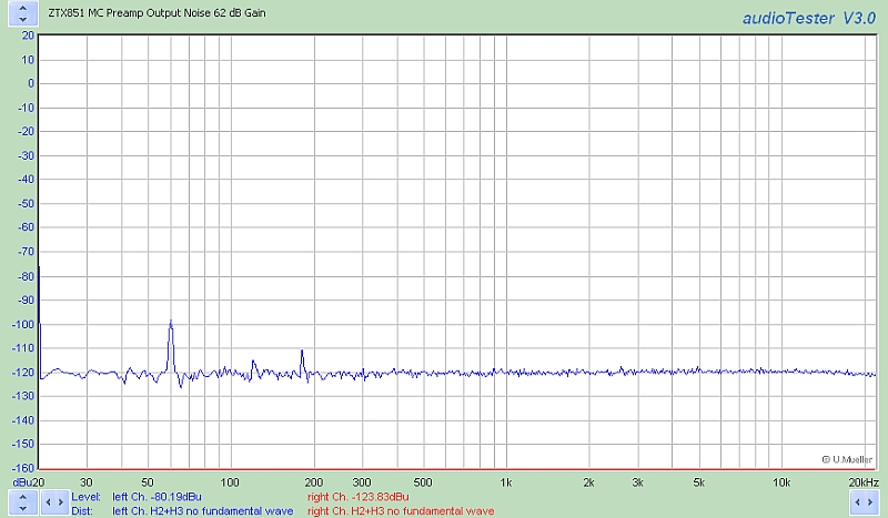

This is what Wayne Kirkwood measured with 1R between emitters in the image below, in the same Cohen setup as you have chosen for a pre-pre.
Also here no sign of 1/f noise, measured EIN of -141.06dBu with 10R source and in this case with the ZTX851.
This -141.06dBu@20Khz BW is ca 0.49nV/rtHz, translating into 0.27nV/rtHz with shorted input.
Looking forward to see your noise measurements.
Hans

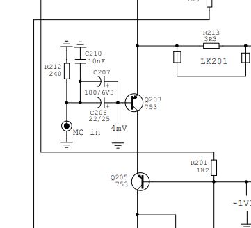

WRT to the Linn Linto.
Where is the bias resistor for Q203's base?
Perhaps you are meant to chose a resistor that drops about 4mV ?
Another observation - no protection diode on the base-emitter junction to prevent reverse biasing during power up and down transients...
Schematic came from here :
Linn "LINTO" MC Preamp Schematic without SMPS - Schematic for SMPS wanted
"Tief" could be asked for a correction.
