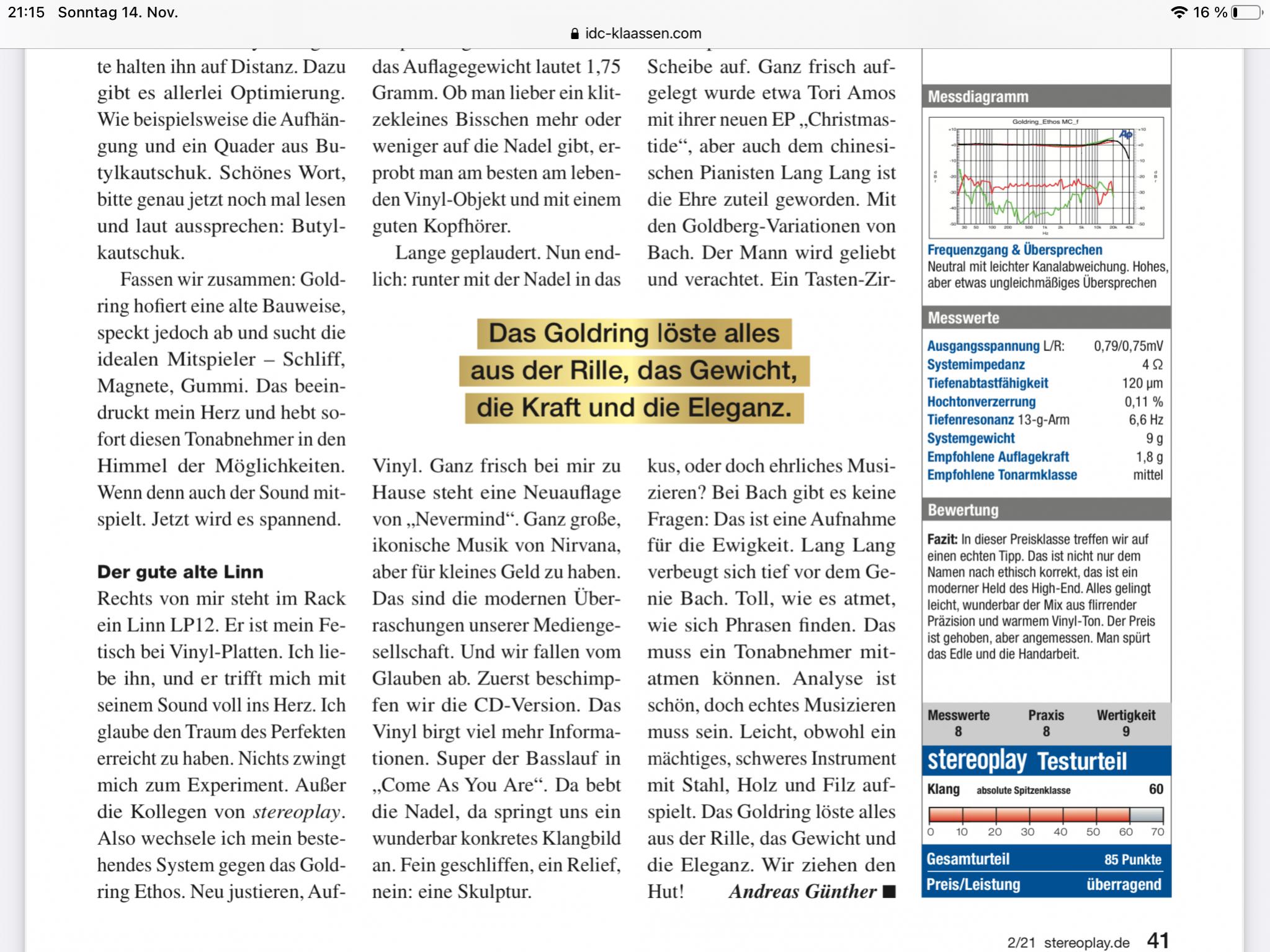

Here are some measurements. The tracking ability of 120u is astounding for an MC cartridge.
The tone Arm should not be too heavy. The relatively high current this produces should be ideal for a trans impedance input, like the one that Bonsai shows on another thread.

This tracking figure seems too good to be true.
Hi Fi World measured a more realistic 63 micro-m when they tested the Ethos.
See: https://www.goldring.co.uk/downloads/goldring/hifiworldethos.pdf
Note also the rolled off HF
Looks like the two magazines have measured two completely different models!

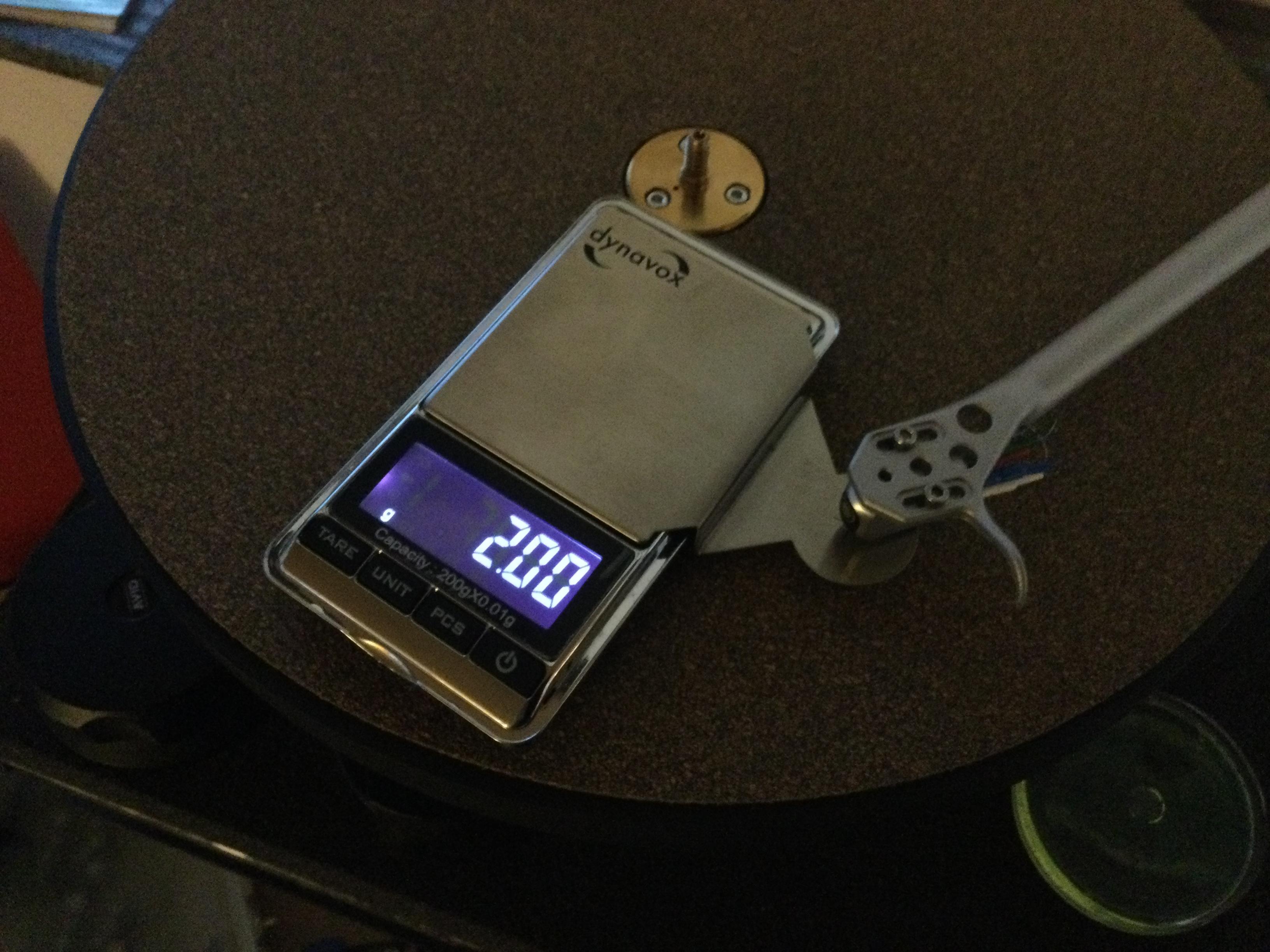

With this setup the Ethos cleared 90uM.
At 100uM the right channel stated to distort.
That was with 1,75g down pressure.
I will now try 2.0g and play with the anti skating.
I do not use the Rega geometry. The arm is adjusted with a Schön template.

With 2.0g I got 100um clean.
110um distorted slightly on the right channel.
120um distorted heavily on both channels.
After some experiments I set the anti skating on 1,5g.

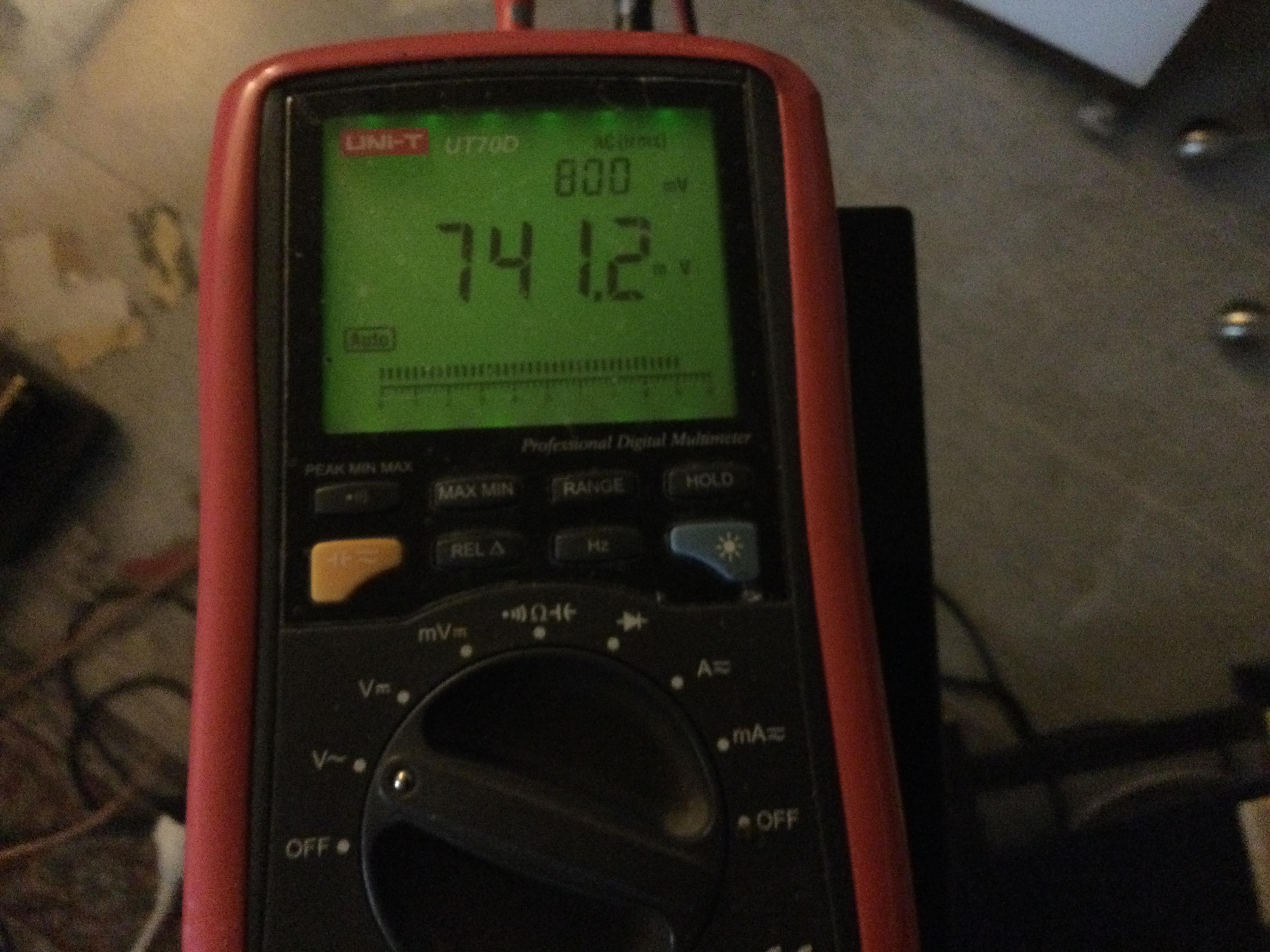

With a sine sweep and measured with a Tru RMS Meter I get between 690mV and 750mV over the whole range from 20Hz to 20kHz.
So there is certainly no big drop or a rise at very high frequencies , provided that my meter is accurate.
