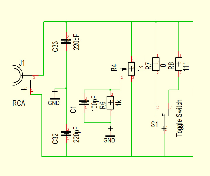

In my case the pot has no effect at all at the cart termination impedance because the two 1K resistors to gnd are replaced by a 2k pot (here a 1K pot), but CM impedance can be increased quite a bit which may be favourable to suppress mains radiation.
Sometimes a picture tells more than a thousand words, that's why I included an example of what I did to nihilate current through the Cart.
Hans

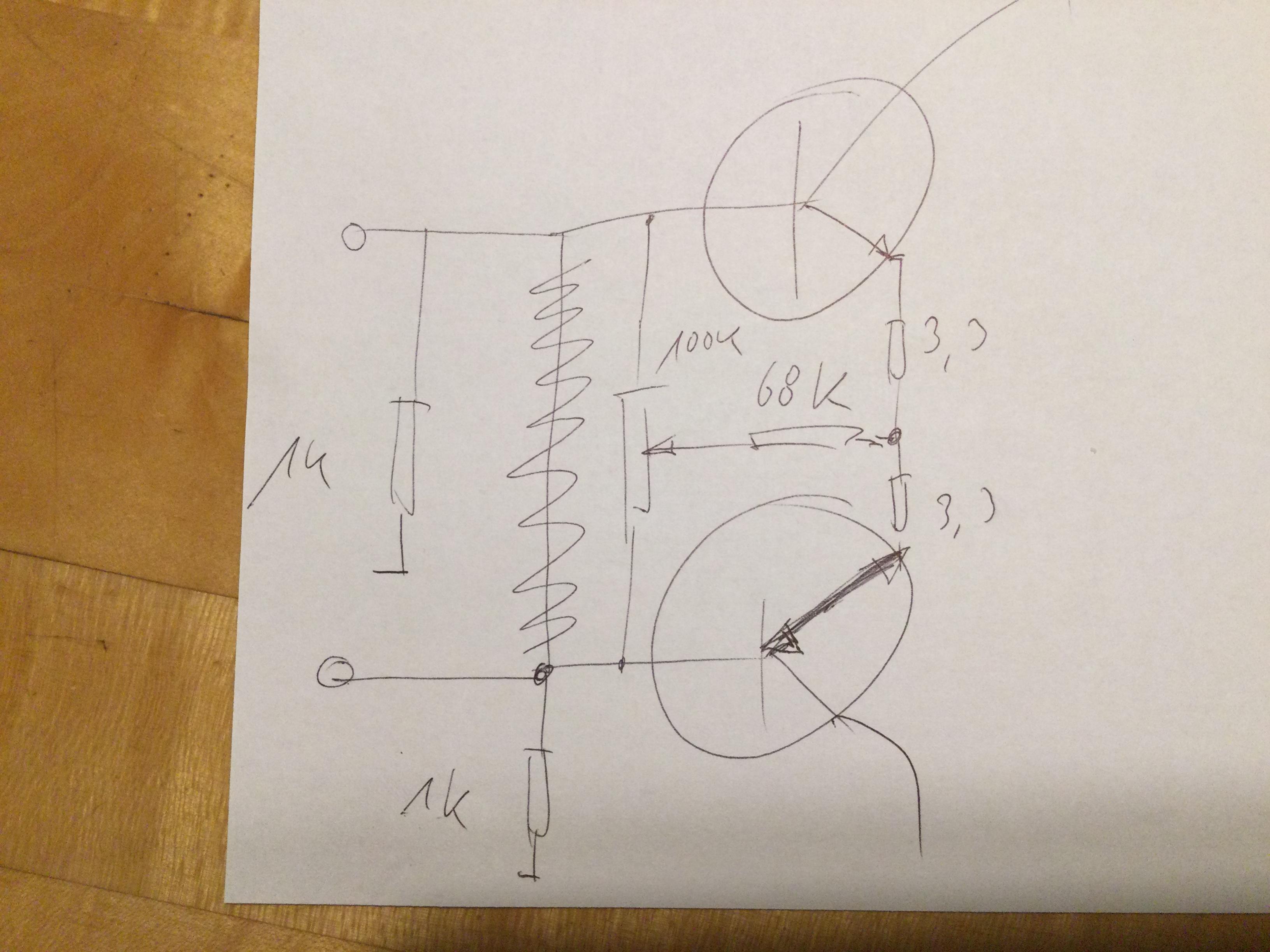

There is another solution that is used in the Paradise. Here the potmeter is 100kOhm and the resistor is 68kOhm. That way the trimmer does have a smaller effect on the input resistance.

All of these approaches to base current equalization trim can work reasonably well. IME working with mic pre's where the problem is exacerbated due to
presence of phantom power blocking caps allowing more DC offset to occur it's worth running the IP pair through max / min temp conditions as the
current gain and VBE match between devices can shift.
This is where a/ dual package and b/ higher beta devices can have an advantage.
That PBSS4350SS dual device looks really good. I'd guess the noise is higher than ZTX851 and closer to the ZTX690B at probably between 0.4 to 0.5nV/rt
Hz purely based on capacitances and current but there's no RBB so just a guess. It also has nice high gain.
If you want absolute best gain / VBE matching / tracking and can sacrifice some noise the MAT14 in 2 + 2 parallel config should be really good. The
noise will be about 0.45 at the sweet spot. Also noise spec is guaranteed.

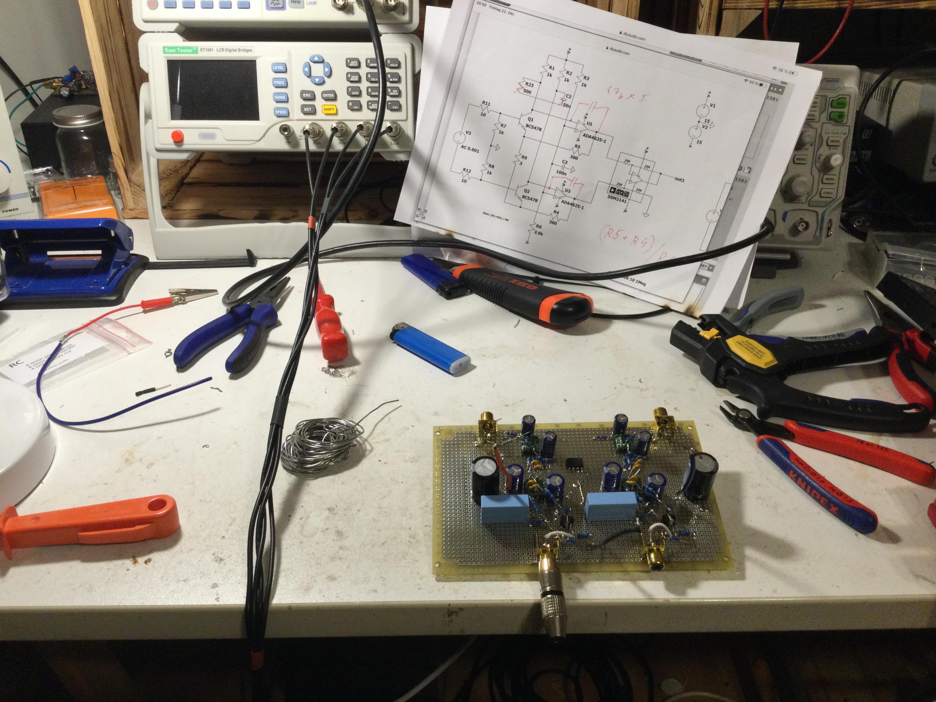

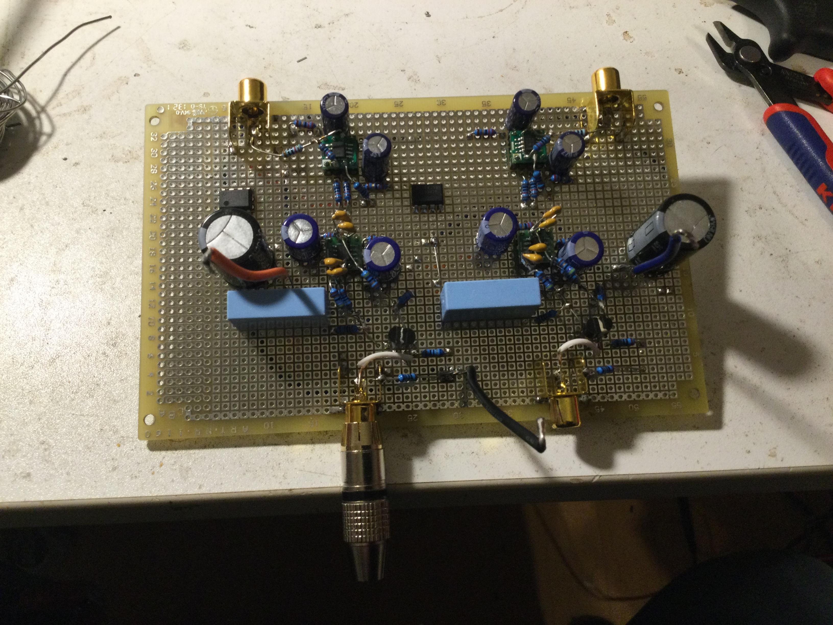

Ricardo, was anxious to hear how are you proceeding with your 3602 realisation ?
Hans
I have got very well matched high quality 15n and 47n caps in stock
Can I use them like this ?
O.k. here is my comment.
The first cap from 1n5 to 15n is perfect.
However going to 47n instead of 470nF forced you to increase gain of the middle stage, thereby reducing overload margin by 14dB, nor very nice.
At the same time overall gain has been reduced by 3dB and A-weighted equivalent input noise worsened by a factor 2 or 6dB, a total waste.
So keep the gain of the second stage unaffected with 2K35.
If you don't have 470nF, use five 47n in parallel in the last stage with resp 1354, 12k18 and 121k8 resistors.
Now your OLM is unaffected and EIN-A worsens by just 0.94dB.
Hans

Ricardo,
Still a small tip.
When reducing the two 1K resistors from the two op-amp outputs to 500R and at the same time lowering the resistor par. to the 10R pot from 35 to 6.4R, overall gain remains the same but you improve EIN-A by 0.9dB to 0.23nV/rtHz when using 5x47nF instead of 470nF.
Hans
