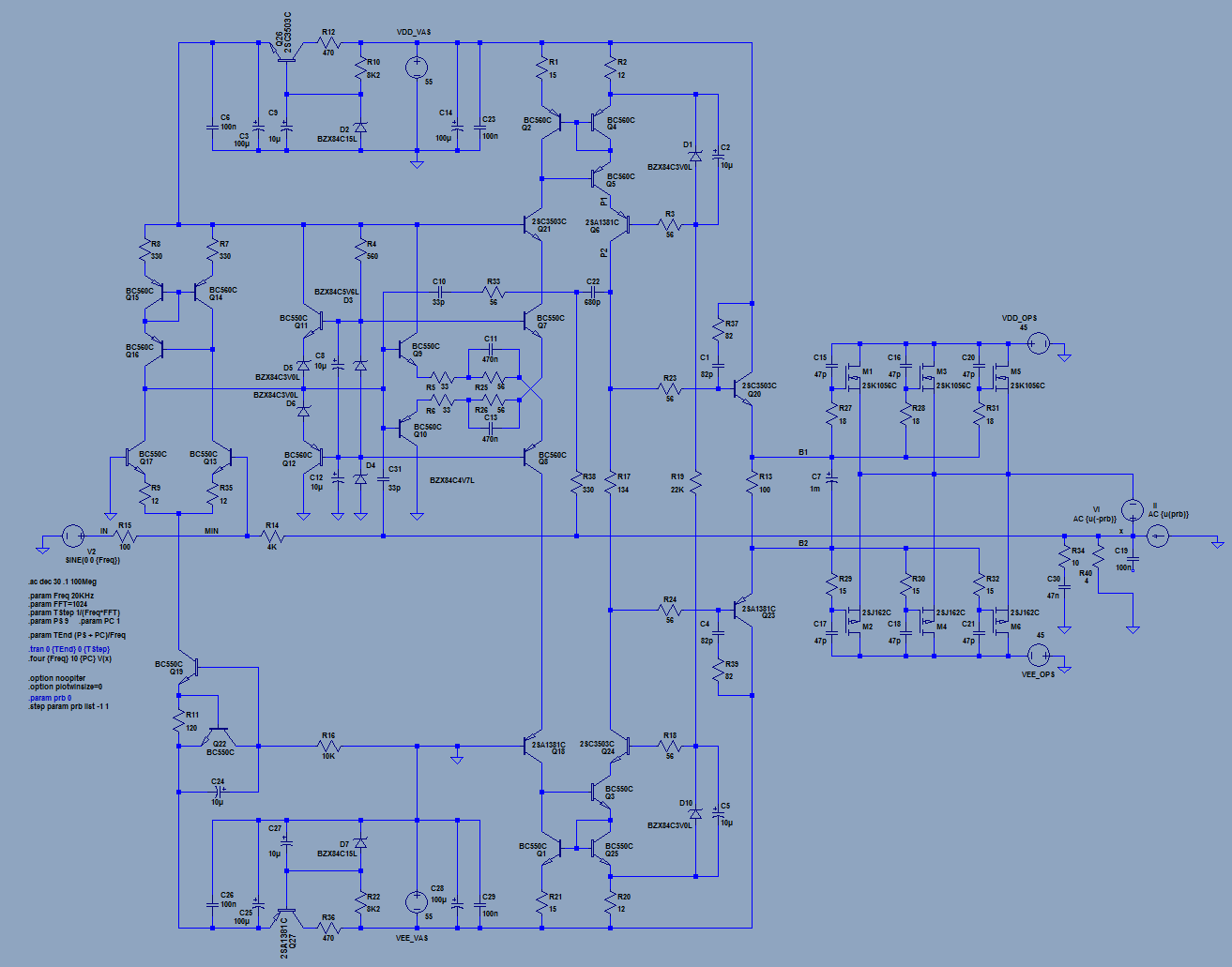

Alright guys, here an updated schematic. It's the 200W/4Ohm version that I intend to proto.
C10 (33p), R33 (56R), C22 (680p) and R38 (330R) are what makes up the TMC network. C31 (33p), together with the buffer local networks C1, C4 (82p), R37, R39 (82R), form the Cherry style network.

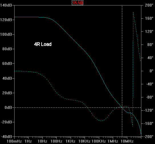

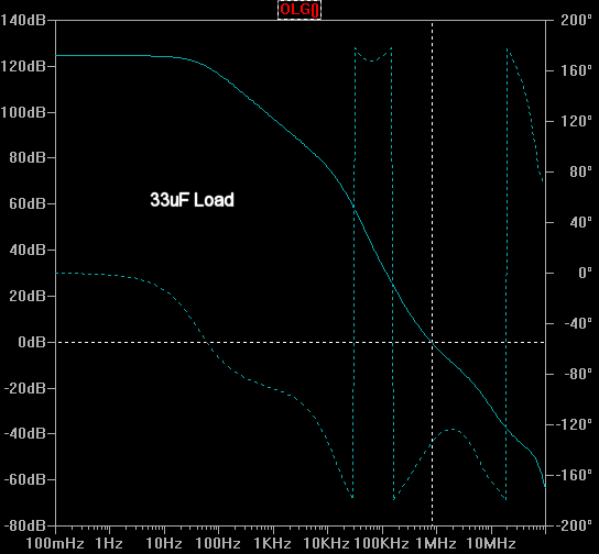

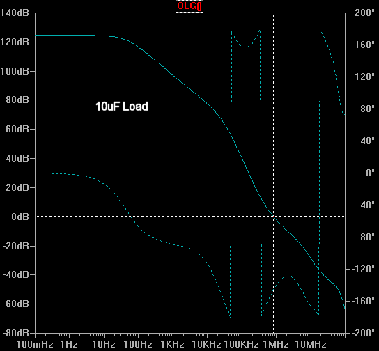

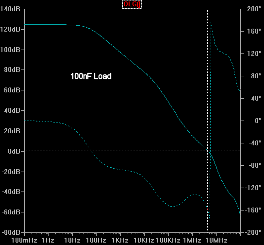

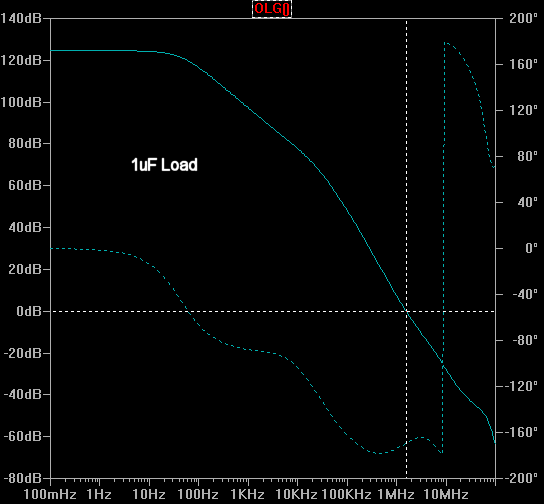

It's stable with a minimum series R of 50 mOhms. Here's the THD:

I think it's pretty good after all; I can chose to increase the TMC influence by increasing C10 to improve stability without sacrificing too much THD.
Something noteworthy is that the phase dips beyond 180 degrees mid-way band don't impact stability. It's where OLG == CLG where OLG phase becomes the determining factor, at least that's what I conclude from this 🙂

P.S. if you'd like to see specific plots just ask and I'll try to come up with them.
